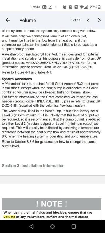

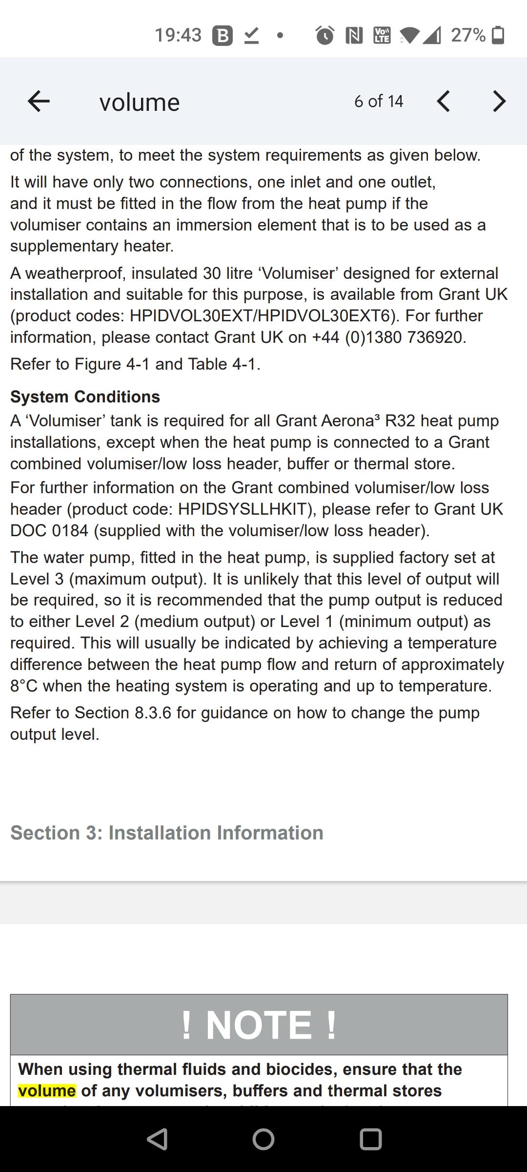

JohnMo Posted April 21 Share Posted April 21 16 minutes ago, Ecthelion said: I’ll need to say that to Grant. From the grant install manual Link to comment Share on other sites More sharing options...

Ecthelion Posted April 21 Share Posted April 21 1 hour ago, JohnMo said: From the grant install manual Interesting, thank you. The difference I get tends to me about 5 degrees. I wonder if mine is at level 2 or 1. After a frost cycle in very cold temps, I find the flow temp struggles to get back up and will just about hit 40 before the frost cycle kicks in again and it has to start again. Link to comment Share on other sites More sharing options...

Ecthelion Posted April 22 Share Posted April 22 I got in this morning and it was set to minimum and also frost protection set to off. I have set it to max and left frost protection as it was for now. Link to comment Share on other sites More sharing options...
JohnMo Posted April 22 Share Posted April 22 7 minutes ago, Ecthelion said: got in this morning and it was set to minimum and also frost protection set to off. I have set it to max Did you set to get the difference between flow and return as they say or just increase the speed? Link to comment Share on other sites More sharing options...

Ecthelion Posted April 22 Share Posted April 22 38 minutes ago, JohnMo said: Did you set to get the difference between flow and return as they say or just increase the speed? I switched dip switch 6 to off to take it from minimum to maximum. I think that increases the pump speed which would increase the volume? for the differential between flow and return, would that be a parameter setting or would additional volume make the difference? Normally it’s about 4 or 5 degrees but as you say should be higher. Link to comment Share on other sites More sharing options...
JohnMo Posted April 22 Share Posted April 22 Just now, Ecthelion said: would increase the volume No just velocity and volumetric flow rate of the water changes. Volume of water will remain exactly the same. Flow rate changes (changing pump speed) moves differential temp between flow and return. This in turn changes heating output, due to a change in mean flow temperature. To decrease differential you increase flow. To increase differential you decrease flow. So if you normally have 5 to 6 difference between flow and return and you want 8 you would decrease pump speed. Link to comment Share on other sites More sharing options...
Ecthelion Posted April 22 Share Posted April 22 3 minutes ago, JohnMo said: No just velocity and volumetric flow rate of the water changes. Volume of water will remain exactly the same. Flow rate changes (changing pump speed) moves differential temp between flow and return. This in turn changes heating output, due to a change in mean flow temperature. To decrease differential you increase flow. To increase differential you decrease flow. So if you normally have 5 to 6 difference between flow and return and you want 8 you would decrease pump speed. Thanks. I don’t think it’s possible to decrease pump speed. It was already on the lowest setting. Link to comment Share on other sites More sharing options...
