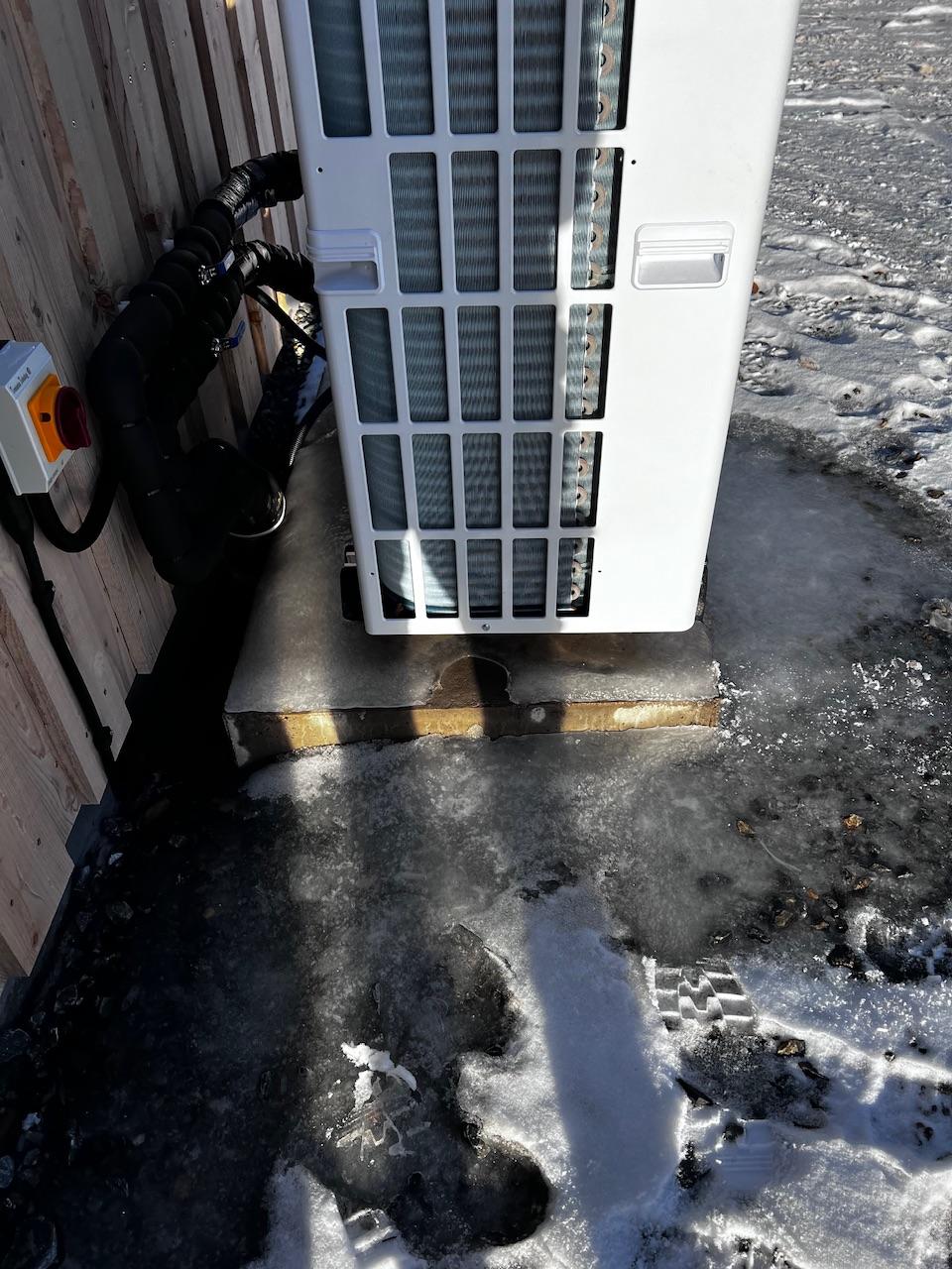

dpmiller Posted April 21 Share Posted April 21 a defrost cycle (on our ASHP anyway) is less than ten minutes every hour or so. Plus defrosts occur most often when the temperature is above freezing, so some of that efficiency loss diminishes when it's *really* cold. If stopping heating for a few minutes every hour makes a house impossible to heat then there's something else going wrong there... Link to comment Share on other sites More sharing options...

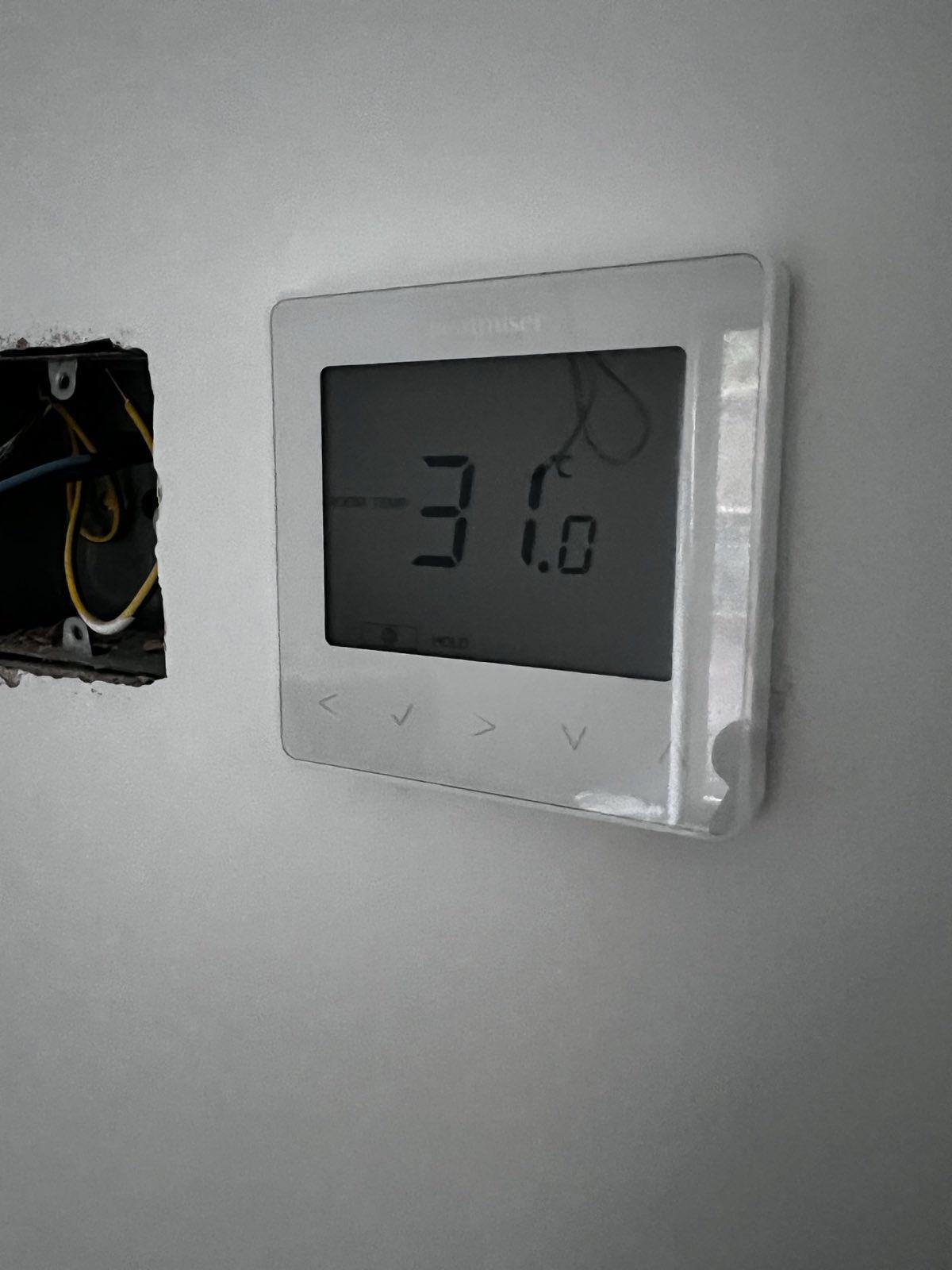

Kelvin Posted April 21 Share Posted April 21 34 minutes ago, Ecthelion said: That’s excellent, must be a really good house. i didn’t say that my ASHP had us at 17.5. More like 19 when we had 3 days below zero and nights at minus 10. But 19 is not acceptable to us, and the wood burner was used. All ASHPs frost cycle and if the weather is cold enough for long enough there is a limit to what they can do. The defrost cycle shouldn’t have much impact. These were taken on the same day. Link to comment Share on other sites More sharing options...
Ecthelion Posted April 21 Share Posted April 21 21 minutes ago, dpmiller said: a defrost cycle (on our ASHP anyway) is less than ten minutes every hour or so. Plus defrosts occur most often when the temperature is above freezing, so some of that efficiency loss diminishes when it's *really* cold. If stopping heating for a few minutes every hour makes a house impossible to heat then there's something else going wrong there... 10 minutes an hour with the heating off matters at low temps, and then it has to get back up to flow temp, so it’s not just 10 minutes per hour, it is more like 20, which is a third of the system’s capability. Link to comment Share on other sites More sharing options...
Ecthelion Posted April 21 Share Posted April 21 5 minutes ago, Kelvin said: The defrost cycle shouldn’t have much impact. These were taken on the same day. Very impressive. I’ve never seen known an ASHP to be capable of that. Link to comment Share on other sites More sharing options...
Kelvin Posted April 21 Share Posted April 21 10 minutes ago, Ecthelion said: 10 minutes an hour with the heating off matters at low temps, and then it has to get back up to flow temp, so it’s not just 10 minutes per hour, it is more like 20, which is a third of the system’s capability. The important data point is your heat loss when the heating is off. It ought to be negligible over that time period. 1 Link to comment Share on other sites More sharing options...

JohnMo Posted April 21 Share Posted April 21 57 minutes ago, Ecthelion said: Not at -10. Mine was fine also, perhaps you need to adjust your Weather Compensation curve at the far end to compensate for defrosts, to bring the average temperature up to where it needs to be. Or you are trying to run for too short a period of time. Or system volume is not adequate and needs more volume adding for the defrost cycle to draw off. A volumiser on the return line of your heating system (not cylinder) would cool just the volumiser water not the radiator water. Link to comment Share on other sites More sharing options...
Ecthelion Posted April 21 Share Posted April 21 9 minutes ago, SteamyTea said: What is the performance curve of your heat pump. It may only be delivering half of that at -10. And just a point about science convention, it is kW, not KW, that would be kelvin multiplied by power. Yes I know, I just couldn’t be bothered to correct it. Do you mean the weather comp curve parameters? Pretty sure those are ok. It’s set to flow 50 degrees at 0. Link to comment Share on other sites More sharing options...
Ecthelion Posted April 21 Share Posted April 21 1 minute ago, JohnMo said: Mine was fine also, perhaps you need to adjust your Weather Compensation curve at the far end to compensate for defrosts, to bring the average temperature up to where it needs to be. Or you are trying to run for too short a period of time. Or system volume is not adequate and needs more volume adding for the defrost cycle to draw off. A volumiser on the return line of your heating system (not cylinder) would cool just the volumiser water not the radiator water. I do actually think it should have a volumiser retrofitted and I’m in discussions with Grant for making sure that’s done before next winter. I challenged them about the failure to reach 21 in very low temps. It’s supposed to deliver 22 at -5.4 degrees outside but it doesn’t. I found in their paperwork that it should have either a LLH or a volumiser, but my install seemingly doesn’t and their grade 1 installer had deemed it not needed due to the heat loss calculations and type of property. Link to comment Share on other sites More sharing options...
