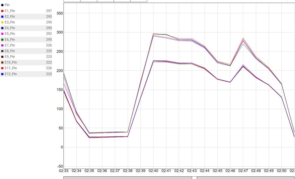

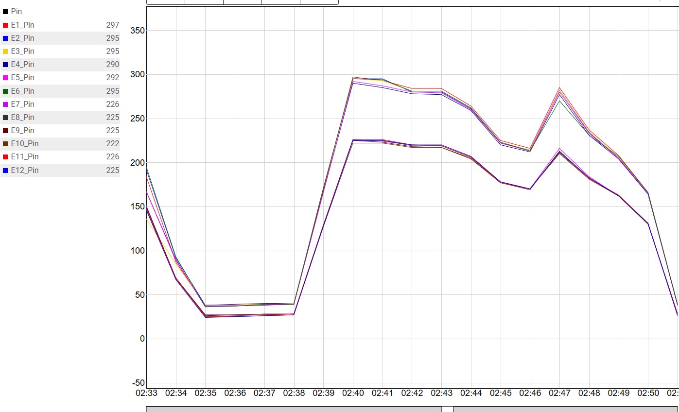

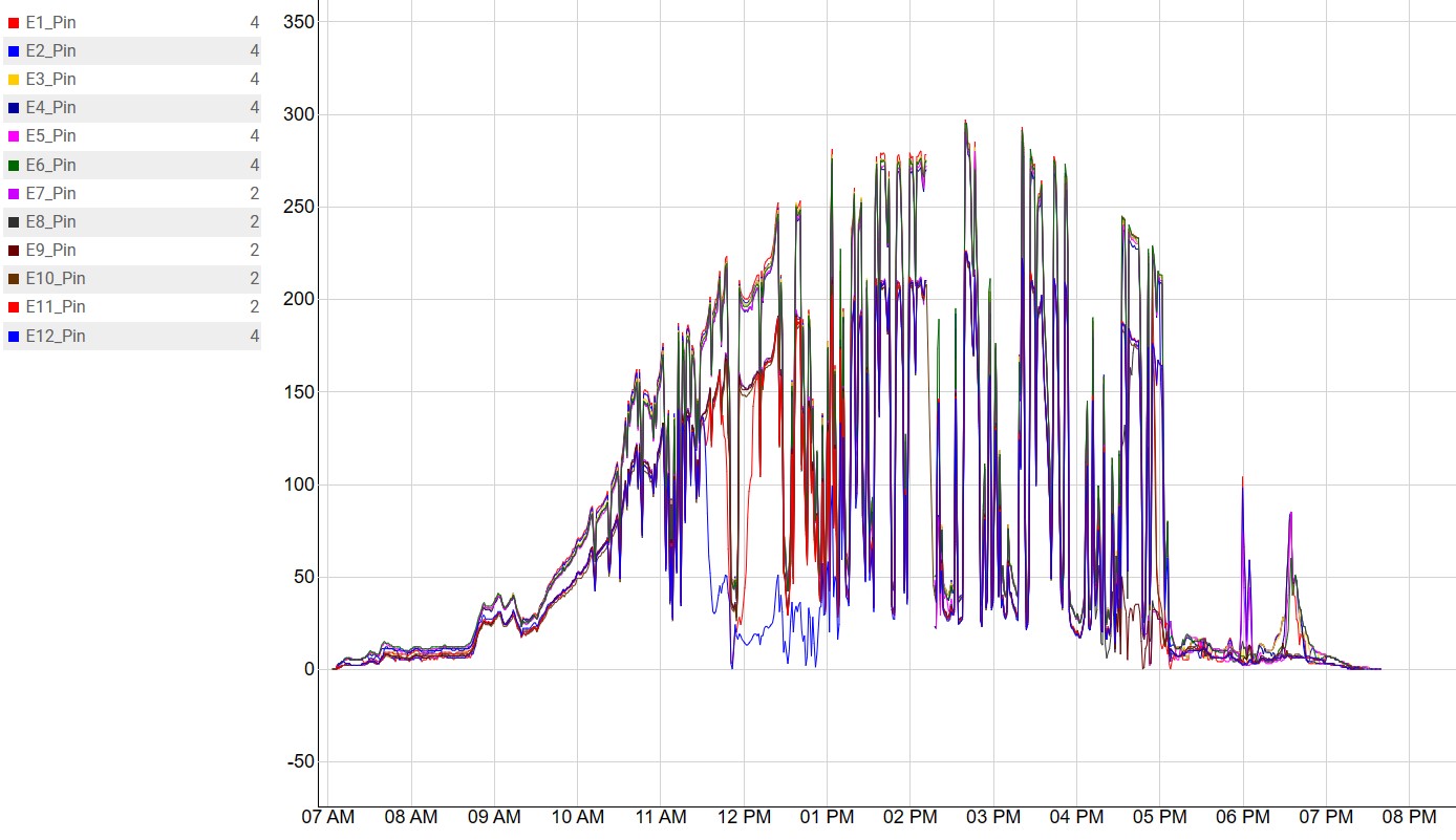

These panels nearly 10 years old, bought in March 2013. The top lines are nominal 280W per panel and the lower lines are nominal 220W per panel. The 280W panels managed a peak of 297W and the 220W panels a peak of 225W.
That is because of the testing methodology, they have have been tested for output with an input of 1000W.m-2, at 25°C, which would be the point that they deliver at least the stated output.  They may well have produced 10% more for during the test.
Modules that just fail the STC would be relabelled to a lower output i.e. failed at 330 Wp, relabel as 310 Wp.  Even of they are just 1 Wp below the level.
So the trick is to not buy the highest output modules, but the ones below, if there is a decent enough price difference.
If you find a local weather station that has a W.m-2 sensor on it (kWh/day is no use here), you can take a random selection of dates, but pick the same 3 times each day i.e. 10 AM, 2 PM and 4PM, then correlate the output of your system to the irradiation levels, then see how the performance has changed over the years.  You can even adjust for different ambient temperature.
