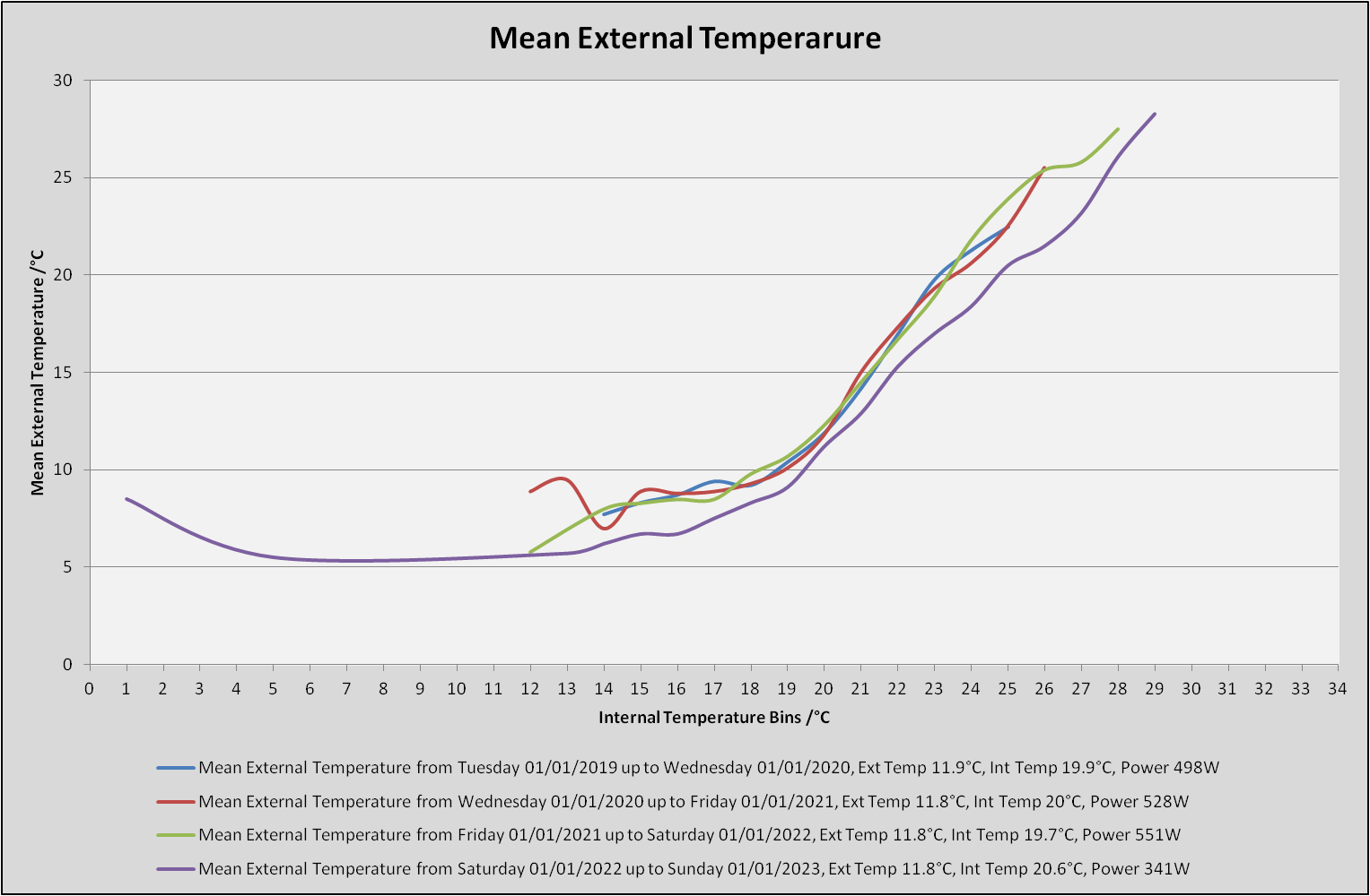

SteamyTea Posted January 23, 2023 Posted January 23, 2023 2 hours ago, DInwood said: seems that nobody in this thread has tried do do this (predict daily heat requirements), @TerryE does exactly this. And I do it manually with my basic storage heaters i.e. I adjust the input value according to the expected ambient temperature.
DInwood Posted January 24, 2023 Author Posted January 24, 2023 16 hours ago, SteamyTea said: @TerryE does exactly this. And I do it manually with my basic storage heaters i.e. I adjust the input value according to the expected ambient temperature. Hi SteamTea I was hoping you might be able to help. How well does your prediction/model match actual heat used? 1
SteamyTea Posted January 24, 2023 Posted January 24, 2023 (edited) 42 minutes ago, DInwood said: Hi SteamTea I was hoping you might be able to help. How well does your prediction/model match actual heat used? Not sure yet, I am working on the last 4 years data. It is not brilliant because I have to manually twiddle the input knob on the storage heaters (50p piece works a treat). I have also had a peculiar last 15 months having been away for a couple of days most weekends in late 2021 and early 2022, then away again every 2 weeks or so since then, and there was lockdown in 2020. I also have a nice 'problem' that my house is quite thermally stable, so need a lot of data points to start to find out what is actually making a difference, so just working on the 104,446 hourly data point for house power, internal temperature and external temperature. It keep the data small enough to use Excel. So far, what I can say, is that adding secondary glazing and heating just the top of the water cylinder (200lt, E7) has made a huge difference, and fixing the back door (I hardly use the fan heater now). A mean power reduction of between 150W and 200W. 1.3 MWh.year-1 to 1.7 MWh.year-1, a saving not to be sniffed at with my low usage, previously between 4.4 MWh.-1 and 4.8 MWh.year-1, last year was 3 MWh,year-1. And my house was warmer, between 0.6°C and 0.9°C, how brilliant is that. Fixing the leaky back door will have helped a bit as the draught blew on my feet. Here is a chart that shows the all year data for 2019 up to 2023. Ignore anything below an internal temperature of 16°C as they seem to be corrupted data reading (or something else, not investigated yet, but they do only account for around 2% of reading. Every thing about that internal temperature, is pretty linear, and it is including the non heating times as well. I shall be looking at heating times only, later, and temperature slopes, which is what prompted me to get on and do it. So hopefully, once I have digested all my data, I should be able to do as @TerryE does and simply vary the charge times for the storage heaters, rather than the input temperature controlling it. Teasing out time data is often tricky as things like running the washing machine at night 3 times a week can throw it out a bit, but should be able to filter that out. Edited January 24, 2023 by SteamyTea

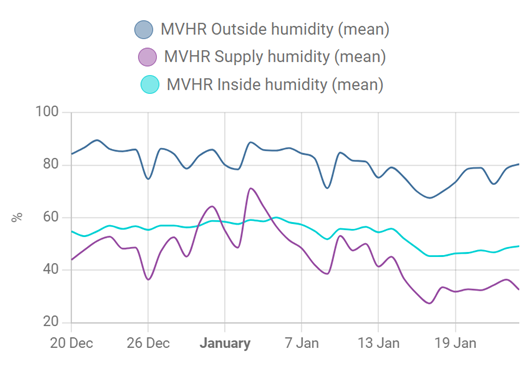

TerryE Posted January 24, 2023 Posted January 24, 2023 On 22/01/2023 at 15:18, RobLe said: While mvhr can be very efficient with ‘sensible heat’, it does not recover any of the latent heat of evaporation of water - so I believe every kg of water that evaporates indoors takes 0.68kWh of heat to get rid of, irrespective of the mvhr(anybody confirm?). A good reference here is The Engineering Toolbox which gives the 0.68 kWh figure for evaporation at room temperatures. However, I suspect that modern near passive class houses have minimal evaporative cooling. Our kitchen probably has the highest AH and its RH hovers around 55% whereas my outside RH is typically around 90% in the winter months, which equates to an RH of 35% at room temperatures, so MVHR input will tend to drop the house RH. On extract in these circumstances, the internal air will condense out about 40% of the absolute humidity in the heat exchanger (which is why MVHRs need an external drain) and thus this condensation latent heat will be covered into the input stream. MVHRs are also typically ~85% efficient at recovery so heat losses in the other 15% are moot. Given that extracts are typically placed in wet zones, I suspect that most moisture is pretty much immediately extracted and I therefore suspect the effective net figure is therefore closer to 0.4 kWh/Kg. We each shed maybe 3-400g moisture through respiration and evaporation, though the heat equivalent is a lot less that 2 kWh or so we radiate. Cooking and misc drying probably add the remainder. Even so from a heat efficiency perspective the best way to dump water is via the plug hole rather the MVHR, hence my other posts about "blading after showering" 🤣 as some regulars might recall.
Gone West Posted January 24, 2023 Posted January 24, 2023 3 hours ago, SteamyTea said: Fixing the leaky back door will have helped a bit as the draught blew on my feet. Not enough emphasis put on comfort I think. Feeling cold air near poor glazing or draughts around door, window frames or skirting. Sorting those out will help a lot with heating.
DInwood Posted January 24, 2023 Author Posted January 24, 2023 I was vaguely aware of this issue but chose to ignore it in my modelling. Perhaps I should look again. The Zehnder MVHR reports humidity as well as temperatures of the various airflows and Home Assistant logs 4 weeks of data. Looking at this I see a relative constant ~85% outside RH & 55% inside (measured at the extracted airflow, so from the humid areas). Here's the last 4 weeks daily averages for interest: We too always blade after showering.
