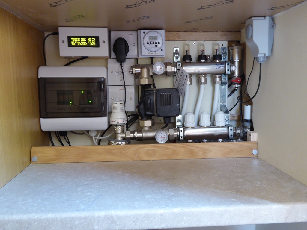

Jeremy Harris Posted July 16, 2017 Posted July 16, 2017 I'm pretty sure you need the UFH pump, so the TMV isn't really adding much. The UFH manifold probably isn't going to work that well without a pump station to circulate water around. Looking at our manifold system I can't easily see how there would be any significant flow around the UFH without a pump station, TBH, as the ASHP pump would just shunt water across the return side. Maybe you could try and connect the flow side of the manifold to the ASHP flow, but I'm not 100% sure that would work OK unless you could separately control the ASHP pump. Here's a photo of our manifold, with the flow from the ASHP coming in at the bottom left, the upper manifold is the flow manifold the lower is the return and the ASHP return comes off at the lower right, after the thermally actuated valve:

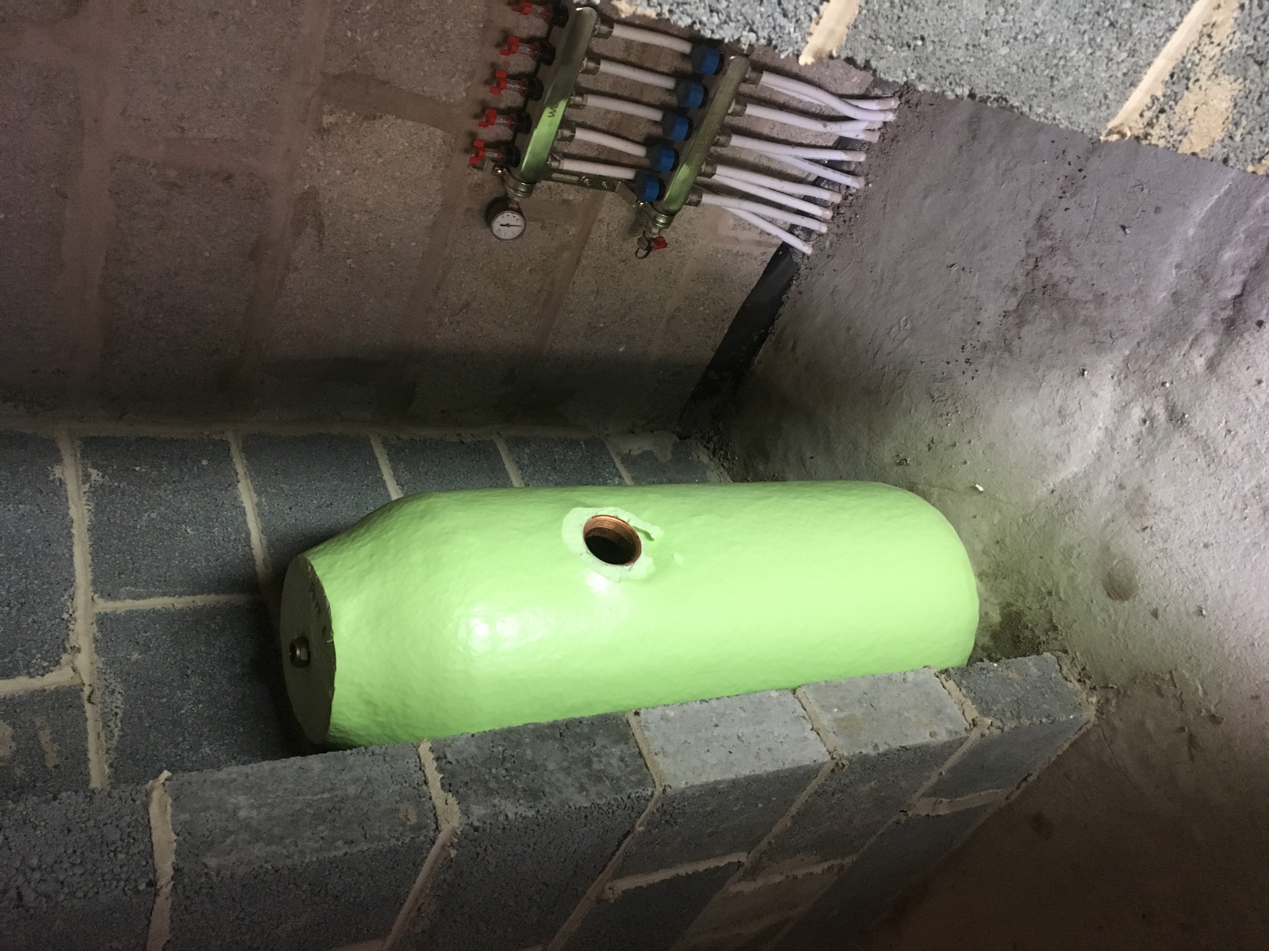

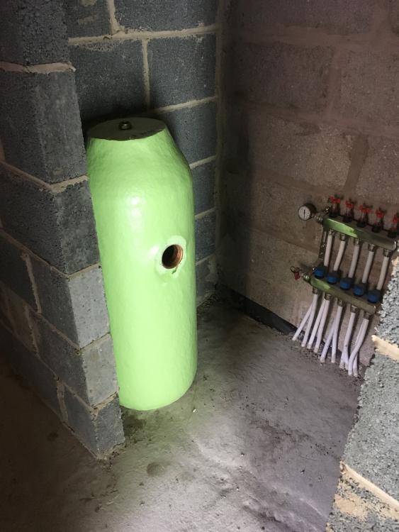

ProDave Posted July 16, 2017 Author Posted July 16, 2017 So Peter, are you having blending valves on your UFH or doing as I am suggesting and just setting the buffer tank temperature? I looked at cheap "standard" indirect hot water tanks, but you can only draw the hot water out right at the top, with the return going back in right at the bottom. Most proper buffer tanks have the inlet and outlet part way up, but you suddenly find you have to pay a LOT more for a "buffer" tank than you do a plain ordinary hot water tank. They are much the same thing except the position of the tappings. How would a standard cheap indirect HW tank actually work as a buffer tank? my guess is not very well at all?
dpmiller Posted July 16, 2017 Posted July 16, 2017 Get some Essex flanges and put the taps wherever you like.
Jeremy Harris Posted July 16, 2017 Posted July 16, 2017 Newark were happy to fit the connections wherever I wanted, the price seemed to be the same for any layout I think. A 70 litre tank wasn't expensive, I have a feeling that the shipping cost was a major element of it.
PeterW Posted July 16, 2017 Posted July 16, 2017 28 minutes ago, JSHarris said: Newark were happy to fit the connections wherever I wanted, the price seemed to be the same for any layout I think. A 70 litre tank wasn't expensive, I have a feeling that the shipping cost was a major element of it. Yep pretty much my experience too. The tank is a standard 900x300 and whilst having the tappings as you say, the basic 70-80 litres at 37c is here nor there when it comes to being used as a buffer as you won't get much stratification anyway. I have a Wunda mix valve and manifold - will be swapping it for an Esbe unit with a lower blending temperature as plan to run the floor at 31c. The idea of the buffer is to give the floor something to work with when the ASHP is in DHW mode - it also allows the ASHP to run for 15 mins which is what it should take to bring it up from 20c to 37c if I've worked it out correctly .... 1 hour ago, ProDave said: How would a standard cheap indirect HW tank actually work as a buffer tank? my guess is not very well at all? It will be fine - better than the short cycling you will get on an ASHP as it struggles to modulate down to the 0.5 - 1kw you will need when you're at the end of the heat cycle. Also means you can prioritise DHW and not be cold ....
ProDave Posted July 16, 2017 Author Posted July 16, 2017 2 hours ago, JSHarris said: Newark were happy to fit the connections wherever I wanted, the price seemed to be the same for any layout I think. A 70 litre tank wasn't expensive, I have a feeling that the shipping cost was a major element of it. Out of interest how much did your Newark tank cost. Them and Telford are ones I will be looking for quotes from. Can you save the delivery cost by ordering through a builders merchant, e.g. TP? I'm in no hurry so also looking at ebay.
PeterW Posted July 16, 2017 Posted July 16, 2017 It was in the sale and I needed a slim tank as it fits in the corner so I had it with 25mm of insulation on it - yes I'll get higher losses but I may box it in and give two sides some more when it's fitted properly. It cost me £100 - look in the clearance section on the site.

Nickfromwales Posted July 19, 2017 Posted July 19, 2017 22mm TMV Sorry to be a bit late to this one, but if using UFH then you need s TMV as a failsafe in case your thermostat goes wonky and you get full range heat going to the UFH. That can be dangerous, and cause a lot of damage to flooring. If using the buffer for DHW preheat, I would not recommend going for a TS with an internal DHW coil. I know @JSHarris says he would go that route if doing this over again, but I had a very long chat with the tech guys at Telford who said that with a low temp ( for good CoP ) the yield from an integral DHW coil drops off quite significantly. They went on to say that the coils are rated to provide good rates of heat exchange when the temp is above ~55oC and at its best at >65-70oC. When I asked what size TS and coil would give eveninical yield at low temp they suggested no less than a 300L TS with the biggest ( 46kw iirc ) coil that will fit into it. Only then is it really worth doing preheat that way. They went on to say using PHE's as @JSHarris has now would mean a much smaller TS / buffer could be used as they are far better at extracting heat from a low temp source than a coil would ever be. The killer is the drop in set / target temp, but another thing to remember is you can have pv divert to this TS as well as your UVC so maybe better to go bigger with less losses, and you'll need the TMVs to cap the output / flow temp according to how hot the immersion gets it. .
