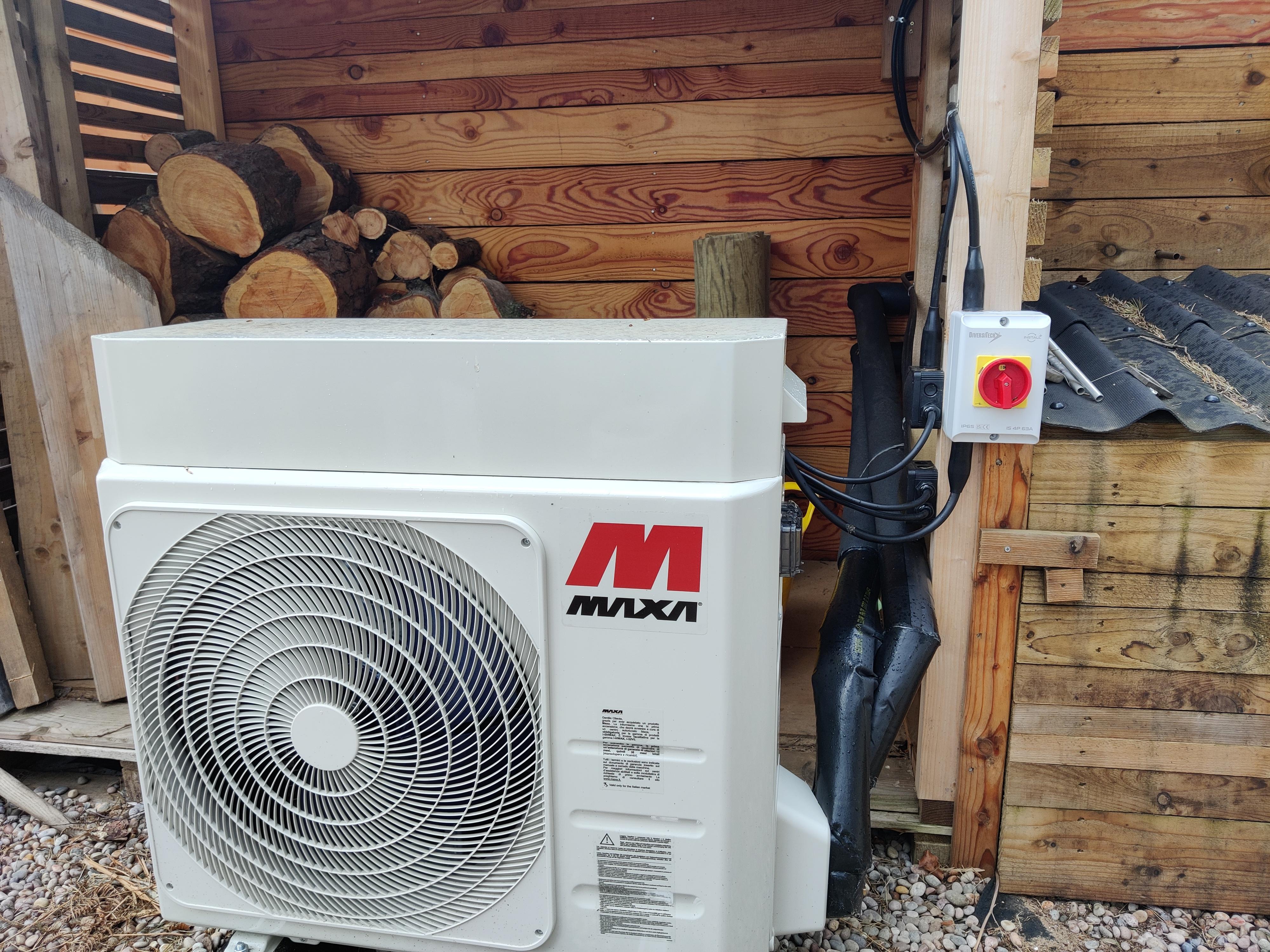

JohnMo Posted May 4, 2023 Share Posted May 4, 2023 Update After getting lots of other jobs done, got back to the ASHP install. Ended up spending about £2500 all in. I didn't have a cylinder to purchase. Basic description of the setup. From heat pump to house is run in 28mm a mix of copper and Hep2O. The summer house is about 8m from the 28mm pipe run and is run in 15mm Hep2O pipe, the UFH has 2x loops 50m long each. This system has a 2 port valve that closes on a DHW cylinder call for heat and when thermostat in summerhouse is hot enough. The summer house is not setup to call for heat. Once the 28mm pipe gets into the house it is reduced to 22mm and via a 3 way diverter, goes to the UFH manifold where it is distributed around the house via 7 loops. The cylinder is fed via pre existing 22mm Hep2O piping originally installed for the gas boiler to UFH manifold these pipes are around 8m long. Calculation shows the pressure drop for cylinder heating are way to high. To fix this I added a pump in to the return pipe from the cylinder, the pump is powered on, at the same time as the 3 way valve is powered to move to 3 way valve to DHW heating. It seems to work and gets the flow back to 1m3/HR. Had the Maxa heat pump running today. Very quiet in operation, have set to run on WC, and it is basically running on min temperature of 25 deg. Also tried it on cylinder heating, the heat output slowly ramps up until it get to 60 deg flow temp, after this it shuts down. Have set up to run without any pumps or mixer valves on the two UFH manifolds, one in the house and the other in the summer house. Bit of fine tuning to do tomorrow. And loads of pipe to insulate. Photo showing the return DHW pump set up, pump temporarily propped up in a surface mount switch box. Wiring to pump and 3 way valve needs to be clipped in place tomorrow. UFH wiring centre is no longer used as the house is run on a single zone. The thermostat controls the heat pump directly. 1 Link to comment Share on other sites More sharing options...

JohnMo Posted May 10, 2023 Share Posted May 10, 2023 On 07/05/2023 at 21:43, eniacs said: More photos needed! Im mid way through doing the radiators and house piping upgrade. Yet to site the heat pump and havent even bought a cylinder yet. Some photos Heat pump, with electrical isolation, heat pump in front of a log shed, feed and return pipes and electrical cables go towards back of shed, and turn 90 degs into my water shed (insulated pallet shed where my water treatment is for the well. Link to comment Share on other sites More sharing options...
JohnMo Posted May 10, 2023 Share Posted May 10, 2023 Inside water shed, expansion tank, 2 port actuator valve to summer house. Closed on a DHW heating demand and via a thermostat. The pipes also go to the house, underground, with 25mm insulation within 110mm double wall flex duct (one per pipe). The rest of the electrical stuff is 1. House wireless thermostat (x1) receiver, it switches the heat pump off if heating satisfied. 2. RF switch from from cylinder thermostat feeding 3. 3. DHW control relay, controls summer house 2 port valve and sends signal to heat pump for DHW heating 4. Summer house thermostat, opens and closes 2 port valve, if DHW is not calling for heat 5. Wiring centre 6. Electric meter for ASHP 7. Heat meter 2 Link to comment Share on other sites More sharing options...
HughF Posted May 17, 2023 Share Posted May 17, 2023 On 10/05/2023 at 15:46, JohnMo said: Inside water shed, expansion tank, 2 port actuator valve to summer house. Closed on a DHW heating demand and via a thermostat. The pipes also go to the house, underground, with 25mm insulation within 110mm double wall flex duct (one per pipe). The rest of the electrical stuff is 1. House wireless thermostat (x1) receiver, it switches the heat pump off if heating satisfied. 2. RF switch from from cylinder thermostat feeding 3. 3. DHW control relay, controls summer house 2 port valve and sends signal to heat pump for DHW heating 4. Summer house thermostat, opens and closes 2 port valve, if DHW is not calling for heat 5. Wiring centre 6. Electric meter for ASHP 7. Heat meter 25mm wall insulation on standard 28mm hep, inside 110 ducting? That's certainly tempting compared to the insulated twin I was looking at, from a £££ perspective. Were you concerned about heat loss? Link to comment Share on other sites More sharing options...
JohnMo Posted May 17, 2023 Share Posted May 17, 2023 1 hour ago, HughF said: Were you concerned about heat loss? With the duct and insulation you also get an air gap, which adds to the insulation as the outer duct/pipe is sealed at both ends, so you also get an unventilated cavity. When you look at the details of pre-made underground insulated pipe the insulation is not really that good and want loads of £ for it. Looking at Rauthermex 32+32/111mm DUO Pipe, you have 2 x 32mm pipe in a 111mm pipe, the insulation may be slightly better but it's not very thick. I have one 28mm pipe in a 110mm pipe the rest is insulation. So overall I think it's cheaper and better quality than the ore made stuff. The shed is also well insulated, basically pallets full filled with rockwool. Vapour control layer internal and breather membrane external. Link to comment Share on other sites More sharing options...
