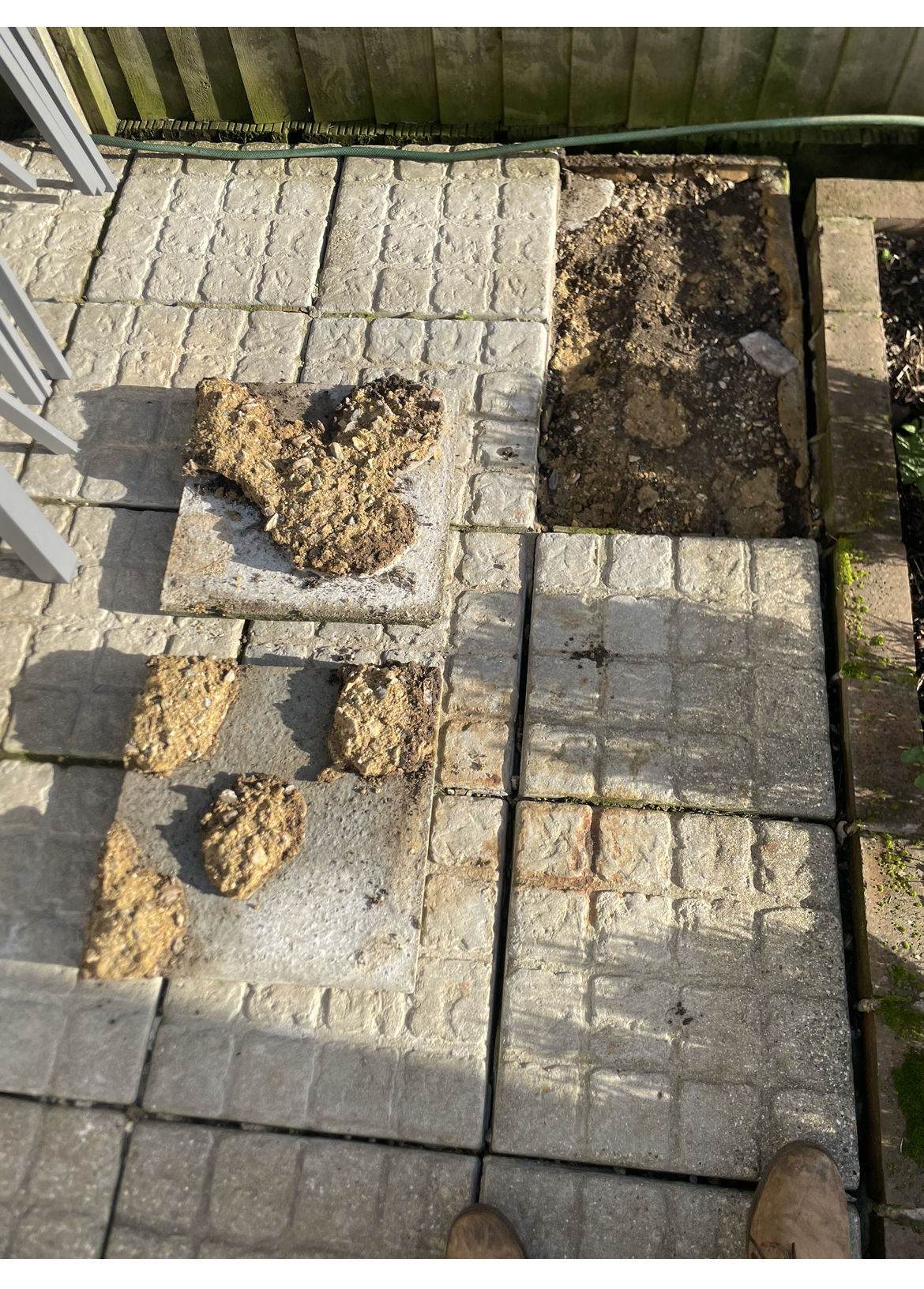

David DS Posted January 15, 2023 Share Posted January 15, 2023 Hi! I would like to replace my existing patio with porcelain tiles or sandstone tiles. A friend suggested I tile over the existing pavers but I don’t feel that is the right way to do it - several of them are loose/ wobbly and a couple are cracked. If I lift them all up I’m left with dirt as shown in the picture. my idea would be to compact the dirt with a plate compactor, lay mortar, prime the tiles and lay - would this be ok? Or should I lay mortar on top of the existing pavers? Thanks in advance David Link to comment Share on other sites More sharing options...
Mr Punter Posted January 15, 2023 Share Posted January 15, 2023 You need a proper base. Have a look at Paving Expert https://www.pavingexpert.com/ceramic_01 1 Link to comment Share on other sites More sharing options...
Kelvin Posted January 15, 2023 Share Posted January 15, 2023 Like everything else it’s all in the prep. Get the base layer right and you won’t have wobbly tiles/slabs a few years down the line 1 Link to comment Share on other sites More sharing options...
Andehh Posted January 15, 2023 Share Posted January 15, 2023 As above, dig out, buy MOT, lay min 150mm, hand tamp it down well, then full mortar base on top. 1 Link to comment Share on other sites More sharing options...
Radian Posted January 15, 2023 Share Posted January 15, 2023 33 minutes ago, Andehh said: then full mortar base on top. ^^^ Important advice that. Don't copy the way the old slabs were laid by plonking them down on dollops of mortar. It's a terrible shortcut that has all kinds of bad repercussions. 1 Link to comment Share on other sites More sharing options...

saveasteading Posted January 15, 2023 Share Posted January 15, 2023 Porcelain will be very slippy when wet. Also make sure any tiles are suitable for cold weather as well as nonslip. I have observed paving laying differences uk and Spain. You don't see a lot of cracks and potholes in a spanish street or square because of 1. The weather. But 2. Because under the tiles is a reinforced concrete slab, suitable for forklifts. But good builders do the same in domestic situations too. Therefore as above...dig out some more ground, lay compacted stone. Then I would lay a concrete slab with mesh, 70 thick. Then the tiles or slab are a finish. All on a slope. If you want, you can break up the existing material small, to use as hard-core on the bottom. 1 Link to comment Share on other sites More sharing options...

Canski Posted January 29, 2023 Share Posted January 29, 2023 I'd disagree with porcelain being slippy when wet. I paved a large patio at my previous house in porcelain slabs and it wasn't slippy at all. Link to comment Share on other sites More sharing options...
Kelvin Posted January 29, 2023 Share Posted January 29, 2023 You can also get non-slip porcelain that has a slightly rough surface Link to comment Share on other sites More sharing options...
