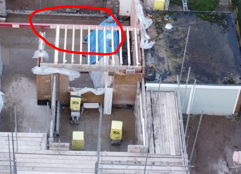

richo106 Posted January 10, 2023 Author Share Posted January 10, 2023 5 minutes ago, Redbeard said: @Mr Punter, as I read it I think that when @richo106 says 'over the top' it means 'underneath', as the next things are VCL and plasterboard. @richo106, can you confirm? Yes my apologies for any confusion, I meant 50mm under the rafters. Link to comment Share on other sites More sharing options...

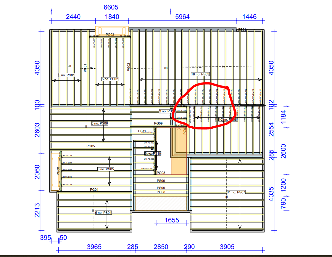

richo106 Posted January 10, 2023 Author Share Posted January 10, 2023 20 minutes ago, Iceverge said: It might help if you posted full section drawings of what is proposed so far. It sounds like you may have some insulation on slope as is buy it's unlikely to be a warm roof. You may want to blank out any personal details. Good news is that you're somewhat ahead of the curve here. Budget wise you'd be advised to get a hold of things as soon as possible and start designing out some expense now if you can. Regarding sectional drawings I haven’t got any, only drawings I have are architects drawing and structural engineers drawing no specific insulation levels. regarding designing out some expense, everything I do so far just seems to add cost so would be welcome to any items that could design out cost Link to comment Share on other sites More sharing options...

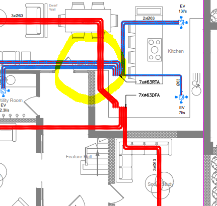

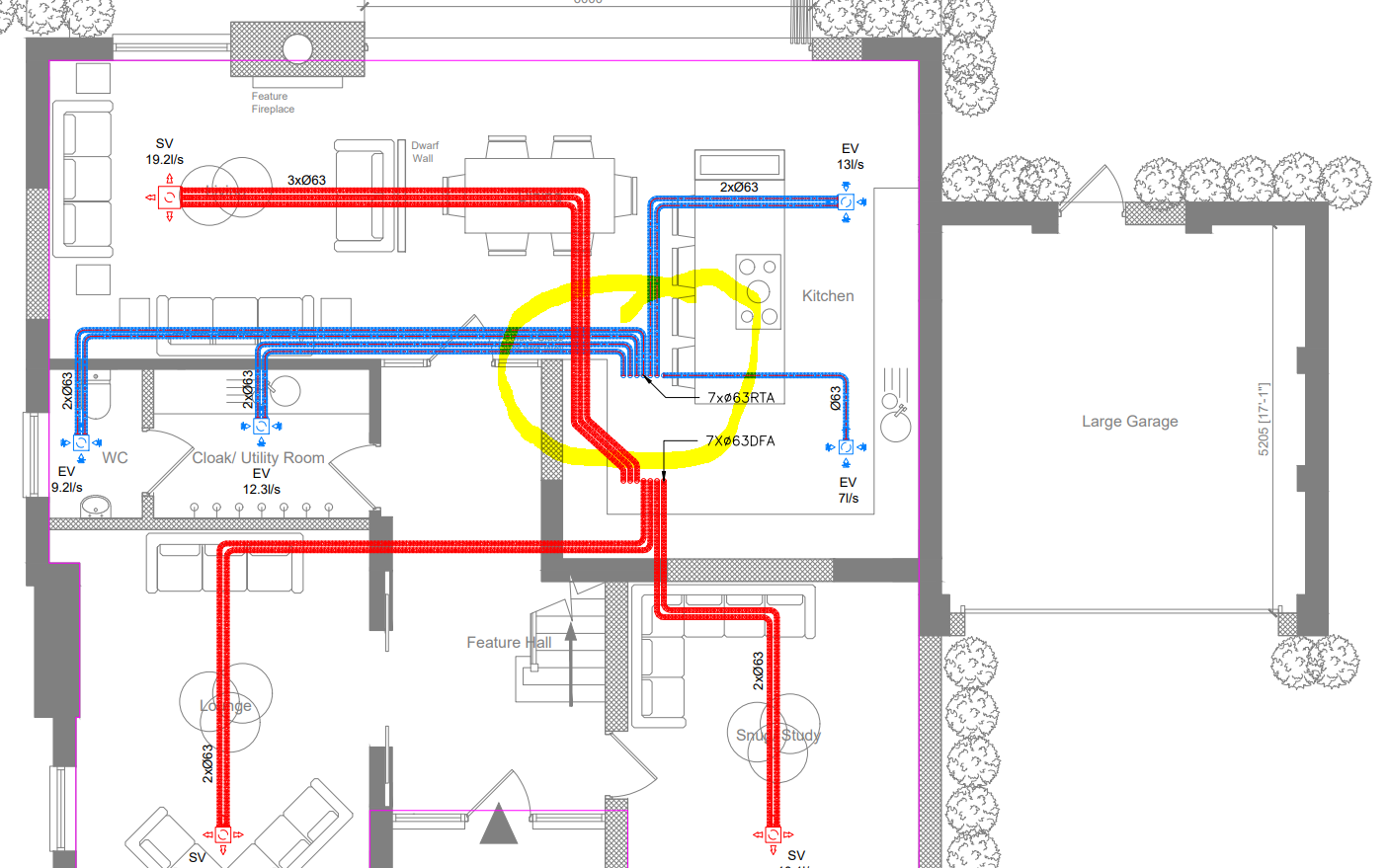

Iceverge Posted January 10, 2023 Share Posted January 10, 2023 I've been thinking about this all day. All the above options are good but they will attract more cost unfortunately. The more I look at this the more I'm unsure if the MVHR is the right option. There's a section on the ground floor where you have 7 ducts crossing through a 225mm joist. Then what looks like 9 ducts passing through a steel beam. You're going to end up doing some serious boxing out here to get it all hidden, as well as a myriad of extra elbows in the ducts. The main purpose of any ventilation system is to provide top quality indoor air. The MVHR adds the heat recovery part to save some energy. It's debateable if it actually saves any money given the cost of filters and initial outlay. Something like demand controlled ventilation or continuous extract ventilation would also mean high indoor air quality but would be much easier to plumb in. You need not go to the hassle of making the loft a warm space either. I would run 8 ducts from a central unit placed in the loft, 2 to the ground floor W/C, 2 to the kitchen, 2 to the ensuite and 2 to the bathroom via 8 port manifold in the loft and silencer. Times 1 X Times 4 X Times X 1 Times X 1 A variable speed controller and some ducting, a few wall inlets and vents and you're home and dry. Probably less than £1000 and very simple to install by comparison. You could pair it to an ESHP like of these for about £2,500 and you'll get all then energy back you would have done from the MVHR as well as a COP of above 3 on your DHW heating. Also, something has been niggling me, airtightness hasn't been thoroughly planned in from the start. No great problem for 3 ACH maybe, but it does mean that you'll have lots of small holes. The big risk is moisture from the house finding it's way into the structure and causing rot. Running a continuous extract system would ensure that any small cracks only let air in from the outside and not visa versa by running the house at a slightly negative pressure. Any damp air is taken by the ventilation system and dumped safely outside. With diligent caulking (flexible caulk) around all penetrations you could probably avoid the need for airtightness membranes etc too. Have a think and I'd like to know what the collective thinks also. I have some other thoughts about the build too looking at the pic but one step at a time!! 1 Link to comment Share on other sites More sharing options...
richo106 Posted January 10, 2023 Author Share Posted January 10, 2023 Hi @Iceverge Thank you for the reply, you are correct that air tightness hasn't been planned from the start. With the rise of energy costs and a few chats with friends kind of persuaded me to go down this route. Regarding the ducts, i was planning on running the ducts passed the steel beam and into the kitchen area that way. This would cause them to take a slightly different route. All day I have been thinking about this and if I am wrong to go with MVHR, i am going to email the guy I got it off and see if he does any returns policy at all. I have measured up the roof area and i reckon there is around 114m2 of roof rafters that will need the insulation, and if i go with 120mm PIR & 50mm PIR it will cost the best part of £4500-£5000 just in materials Would also like to hear the opinions of others Regarding the other thoughts about the build, if you would like to private message me about this. I would very much like to hear your thoughts on this Thanks again Link to comment Share on other sites More sharing options...

richo106 Posted January 10, 2023 Author Share Posted January 10, 2023 In an ideal world we would use the equipment we have on site, I keep going back to the idea suggested by @Redbeard and creating a MVHR house within the loft. This would only be extra cost of the additional insulation to surround this and a bit of stud work And to negate all the ducts going through the cupboard i could stud out the wall in bedroom 2/dressing to take the pipes down to the ground floor and come out the correct side of the RSJ. Or run them straight across the hallway and into the kitchen missing the RSJ If I have air layer on my first floor ceiling could this potentially work? Link to comment Share on other sites More sharing options...
