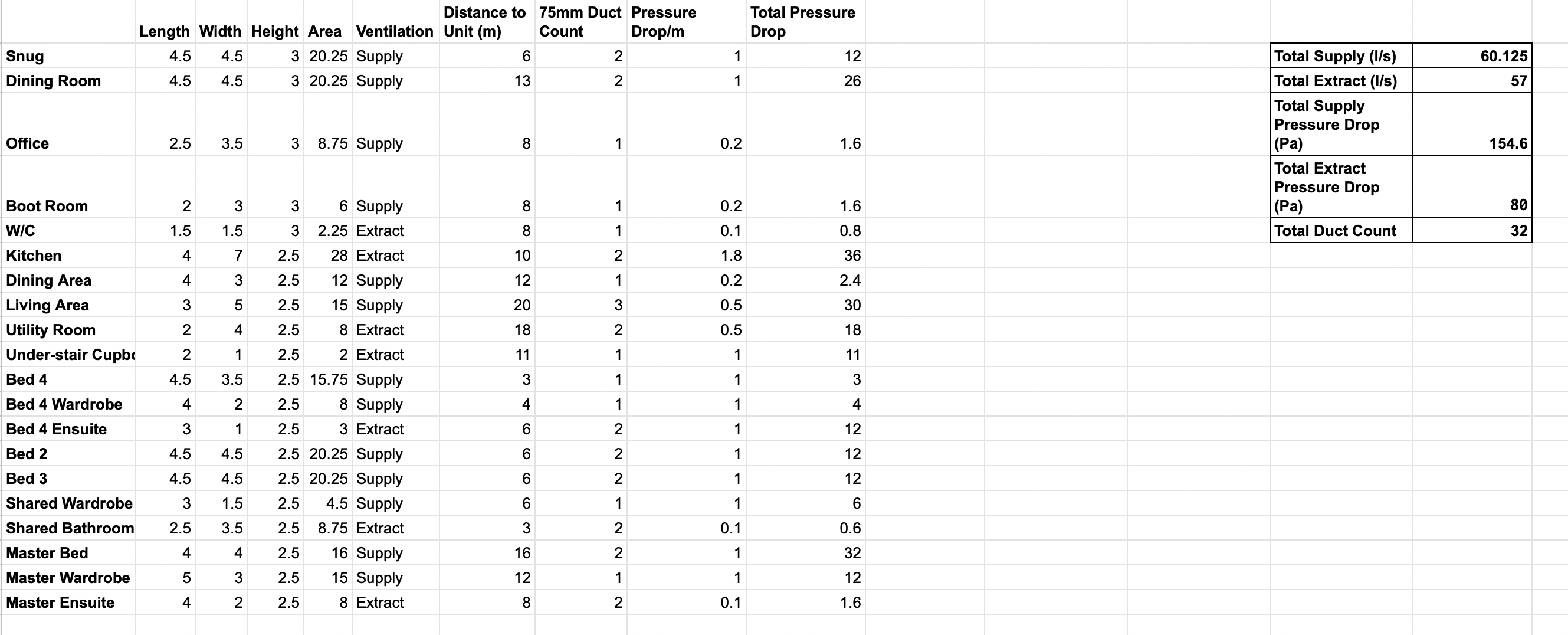

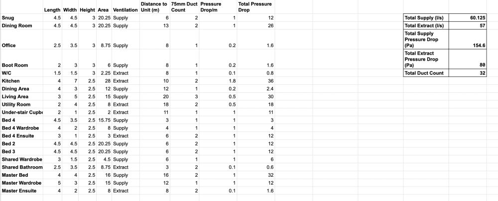

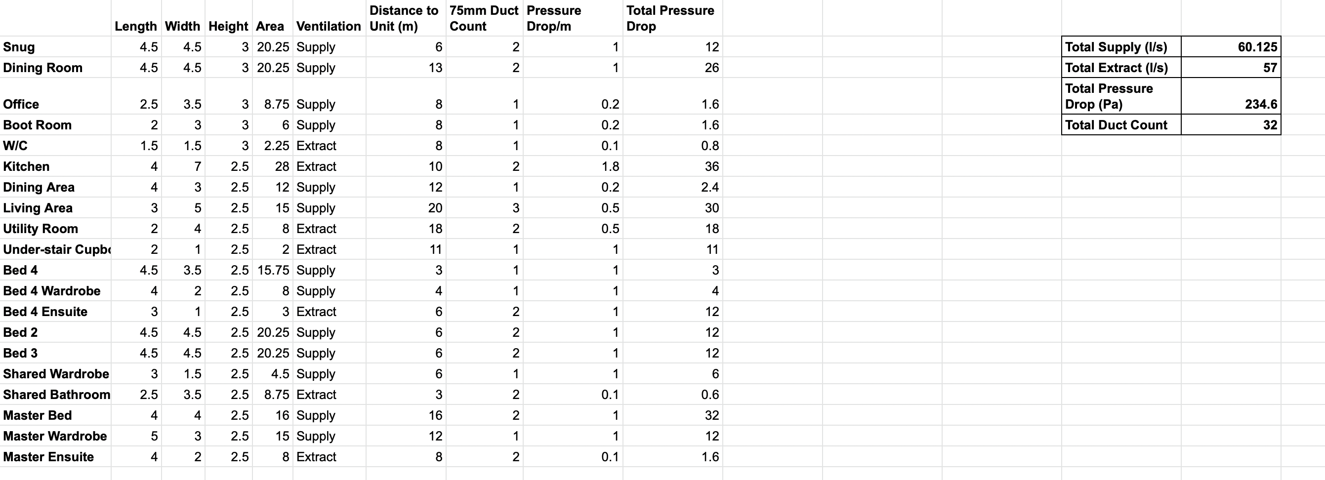

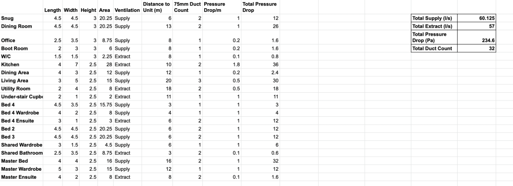

jayc89 Posted January 9, 2023 Author Posted January 9, 2023 Assuming my calcs are correct, that would mean I need 32x duct runs, resulting in a total pressure drop across the system of 234 Pa, which I thought was too high?
jayc89 Posted January 9, 2023 Author Posted January 9, 2023 On 09/01/2023 at 20:40, MikeSharp01 said: How did you work this out - did you include the incoming / outgoing ducts feeding fresh air in and stale out to the atmosphere. Also remember that runs in parallel don't just add up. Expand My last post includes some of the workings out. It doesn't include Supply/Extract ducting to/from the MVHR, just the ducts to/from the rooms. How should parallel runs be accurately accounted for?
MikeSharp01 Posted January 9, 2023 Posted January 9, 2023 (edited) On 09/01/2023 at 20:45, jayc89 said: My last post includes some of the workings out. It doesn't include Supply/Extract ducting to/from the MVHR, just the ducts to/from the rooms. How should parallel runs be accurately accounted for? Expand I think you only need to do the extract side of the system as the supply has another fan and to keep things in balance will deliver the same volume of air (so you will need to adjust it down to 57). So each side can be independent and that will sort of halve you extract pressure drop to 90 (ish) much better and your supply at about 140 but each fed by their own fan. Least I hope I have that right as I have always assumed there are two systems and the pressure unit ratings are for the two independently not added together. Edited January 9, 2023 by MikeSharp01 correcting figures

jayc89 Posted January 10, 2023 Author Posted January 10, 2023 Took another stab at this, also taking velocity into account. Velocity numbers were taken from https://www.cuidevices.com/product/resource/calculators/airflow-conversion using the minimum flow requirements (l/s) from Column K and the ID of the 75mm ducting (68mm) I'd appreciate someone sanity checking my numbers to make sure I'm not talking out of my arse! (For context, there's an extract in the "Under-stair cupboard" as it's part-below ground so prone to slight dampness in the walls - old houses!) Couple of questions though; - Build Regs state a minimum flow of 0.3l/s per m2 of room area, but that doesn't take into account volume. Our downstairs rooms are quite tall (3m) so should I be looking at more than 0.3l/s/m2? - Total supply pressure is > 100Pa. For the longer runs where there are 2x or even 3x ducts being run and therefore the pressure drop is greater, should I be looking at using less, but larger ducts instead? - When sizing the MVHR unit, what multiplier should I apply to the demand to ensure the unit is right-sized. Is 1.3x sufficient?

jayc89 Posted January 10, 2023 Author Posted January 10, 2023 90mm ducting certainly reduces the pressure drop across the whole system to below 100 Pa. It looks like I'd only need to double up on the 2x longest supply runs (living area and master bedroom), would you still recommend doubling up on all the extracts?
