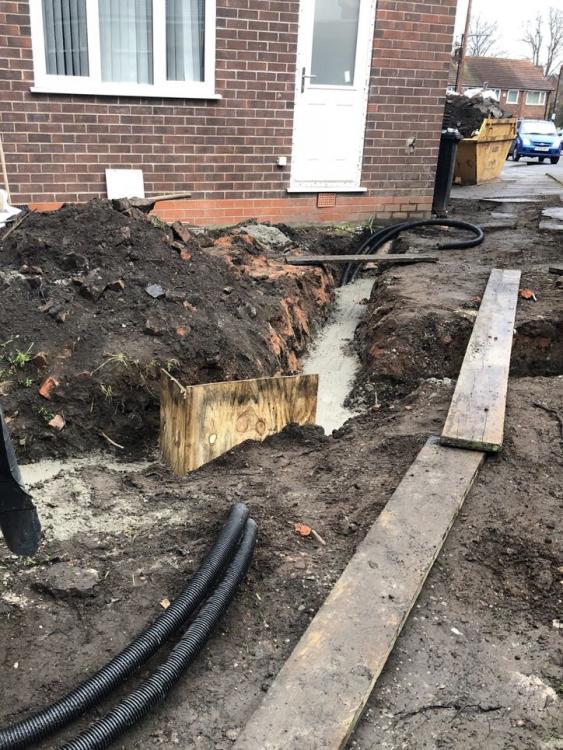

Nickfromwales Posted March 19, 2018 Share Posted March 19, 2018 3 hours ago, daiking said: No point doing that as the patio will be built over the top in a couple of weeks. Really need to sort where the pipe is likely to go and drop it in with the founds. the Routes on the bottom of the IC don’t point where I want the pipe to go so that end also needs working out to get it going the right way. Pictures ? Link to comment Share on other sites More sharing options...
daiking Posted March 19, 2018 Author Share Posted March 19, 2018 21 minutes ago, Nickfromwales said: Pictures ? Of some mud and rubble? Link to comment Share on other sites More sharing options...
Nickfromwales Posted March 19, 2018 Share Posted March 19, 2018 The chamber with the connections branching off in the wrong direction Link to comment Share on other sites More sharing options...
daiking Posted March 19, 2018 Author Share Posted March 19, 2018 1 hour ago, Nickfromwales said: The chamber with the connections branching off in the wrong direction Sorry, it’s back under it’s lid and 3 paving slabs. it looked like a conventional 5 inlet base. I suspect only 2 are used but the remaining inlets don’t point to where i want to go. I was told you should dig the trench all the way from the chamber to the lawn and pipe it all in before blocking it off. What sort of fall do you need for just liquid waste and what for solids? The point I picked was 14m from the IC I’m told with a 415mm delta. Nothing is planned yet so the 14m distance could be reduced a bit and that delta is based on the grass level. A building floor level would be higher than that to give more height and the input sink or toilet would be higher still. is solids realistic? Or a stupid idea. i also need to know how to deal with a cold water supply to this position. This can only possibly came through the house wall at above ground level. Link to comment Share on other sites More sharing options...

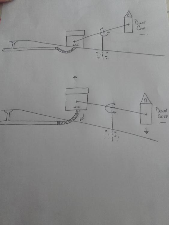

Onoff Posted March 24, 2018 Share Posted March 24, 2018 (edited) On 21/03/2018 at 21:58, daiking said: Will be bounded by permitted development rules, lol. Not much to play with height wise. Have the whole shed electro hydraulically raised when you need to take a dump thus raising the (flexible) fall pipe. Or site the wc in a raised section like Rapunzels tower and make it look like a dove cote..... Edit: Just raise the bloody thing and ENCOURAGE bats to take up residence. Can't see the council making you take that down! Edited March 24, 2018 by Onoff Link to comment Share on other sites More sharing options...
Nickfromwales Posted March 24, 2018 Share Posted March 24, 2018 11 minutes ago, Onoff said: Have the whole shed electro hydraulically raised when you need to take a dump thus raising the (flexible) fall pipe. Or site the wc in a raised section like Rapunzels tower and make it look like a dove cote..... Strange, you don't normally drink this early in the day..... ? Link to comment Share on other sites More sharing options...
Onoff Posted March 24, 2018 Share Posted March 24, 2018 13 minutes ago, Nickfromwales said: Strange, you don't normally drink this early in the day..... ? I'm thinking a see-saw arrangement now to reduce overall height. Pumped water used as ballast to raise the wc side.....you'd just need to wait for the tank to fill before emptying yours... Link to comment Share on other sites More sharing options...
