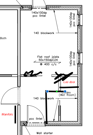

Jilly Posted January 5, 2023 Share Posted January 5, 2023 (edited) Hi , I've asked Wunda for a quote for our extension (3 x 6m =18m2) which will have a room and a tiny shower room, so I'm thinking 2 zones and 2 thermostats will be needed. They won't give you a layout pic until you order. We left 2 free ports on the manifold ready to connect on to and will have to drill through the wall. The sales person tells me that the design team is saying I need 2 zones and one thermostat, or three zones with 2 thermostats. I'm assuming the room must be too big for one zone? (Communicating with the sales person is a bit slow). Any ideas on how to get round it, bearing in mind we only have two ports left? The plumber who came to look didn't mention this. Thanks! Edited January 5, 2023 by Jilly Link to comment Share on other sites More sharing options...

Jilly Posted January 5, 2023 Author Share Posted January 5, 2023 Oops, my mistake 😂This is what they said: 'I’ve spoken to the team. If you want separate thermostats, it will take it to 3 loops. You can only have 2 loops if they are both together on one thermostat. So not sure which way you want to go ahead.' I don't understand how I will be able to just warm up the bathroom, with only one thermostat... Am I missing something? Link to comment Share on other sites More sharing options...

BadgerBadger Posted January 5, 2023 Share Posted January 5, 2023 I think what they're saying is your larger room is too big to be just a single loop, so it needs two loops to cover the area. But as your shower room is quite small then the second loop is able to cover both the shower and remainder of the large room. But that's means the shower room can't be independently controlled as it shared with the main room. So if you really want the shower to be independent you'll need two loops to cover the larger room and a separate third loop for the shower. 1 Link to comment Share on other sites More sharing options...
PeterW Posted January 5, 2023 Share Posted January 5, 2023 @Jilly how big are the rooms as I can’t see any dimensions .? And where is the manifold ..? 1 Link to comment Share on other sites More sharing options...
Jilly Posted January 6, 2023 Author Share Posted January 6, 2023 12 hours ago, PeterW said: @Jilly how big are the rooms as I can’t see any dimensions .? And where is the manifold ..? The whole extension is 3m x 6m and the manifold is marked in small red letters in the bottom left corner of the diagram (on the other side of the wall). Link to comment Share on other sites More sharing options...

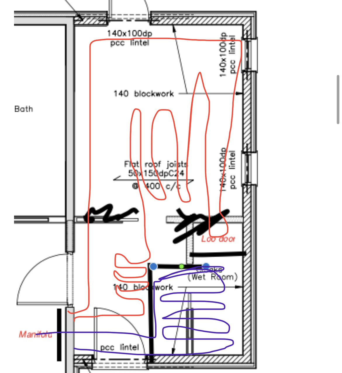

PeterW Posted January 6, 2023 Share Posted January 6, 2023 So if the door is 800, that’s approx 5x3 to be heated less the shower room. At 150mm centres that is around a 95m loop (you can do 120m at a push) and then the shower room. All doable on 2 circuits @Jilly and especially if you use self balancing actuators as they will trim the flow down based on the return temp. 1 Link to comment Share on other sites More sharing options...

PeterW Posted January 6, 2023 Share Posted January 6, 2023 No worries - if you order from wunda get a 120m coil and a 50m coil, there will be spare on the 50, and the 120m will mean you have plenty to do the full loops. If the stud wall isn’t in place yet, and you can get down and under where the manifold is to come off the back of it then run the shower room first, feed and return across the outside door entrance, and then run the main body of the room. Serpentine would be ideal but tbh in a room that size I would run all round the outside 100mm from the wall and then run up to the shower room and back, using up the coil on the area in front of the shower room door then back to the manifold. here is a Friday afternoon plan ..!! Link to comment Share on other sites More sharing options...
