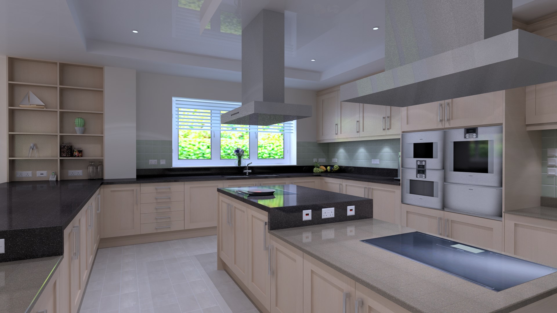

le-cerveau Posted July 13, 2017 Share Posted July 13, 2017 2 hours ago, Ferdinand said: Is there anybody out there who still puts sockets in tiles? I will be, but above the Corian splash back where we are tiling up to the bottom of cupboards or around the window at the same height. There are some set in to the splash back on the island at the transition but I will be having a very nonstandard kitchen. 1 Link to comment Share on other sites More sharing options...

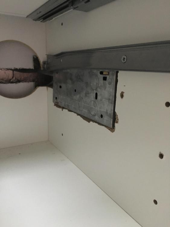

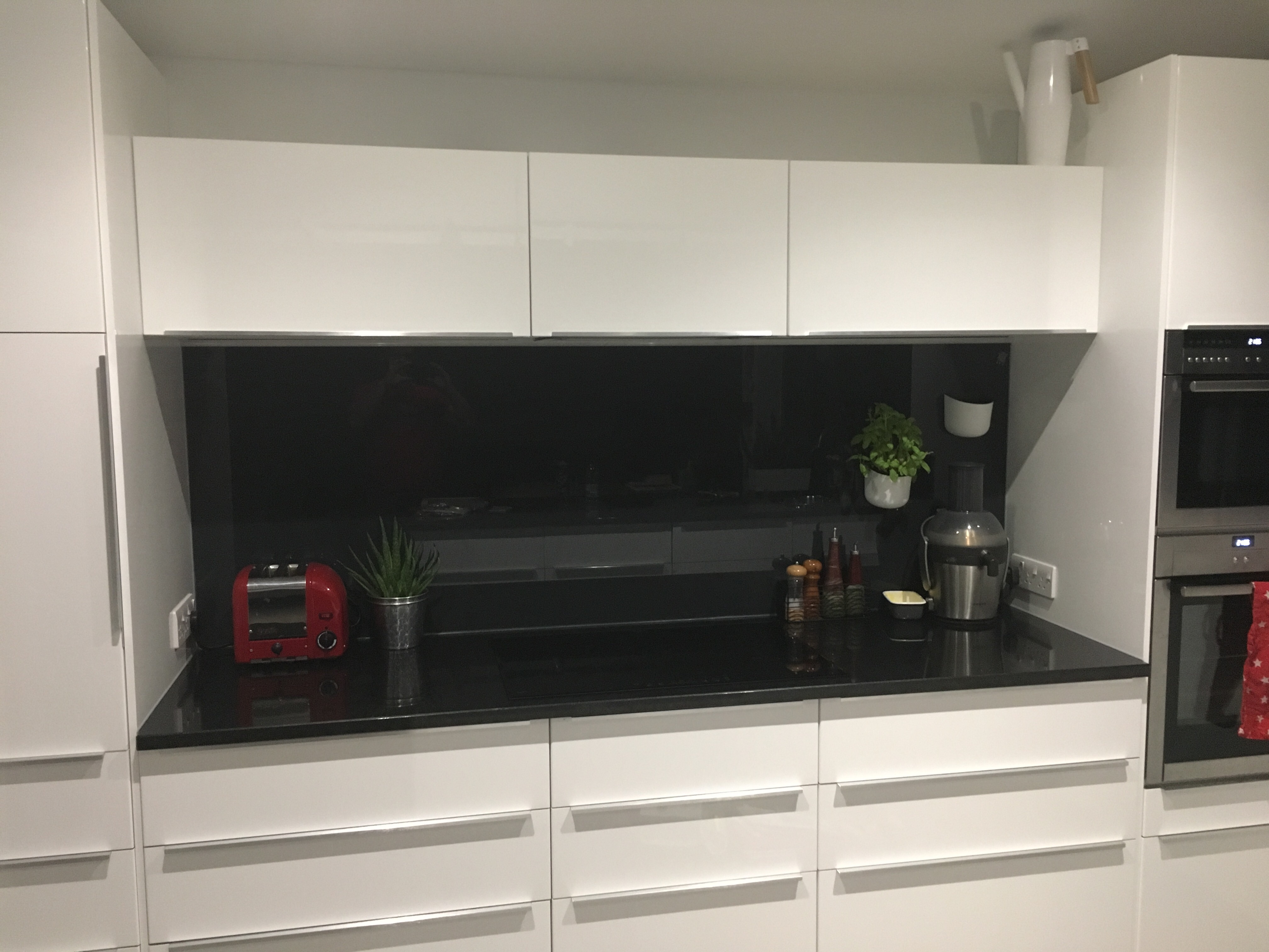

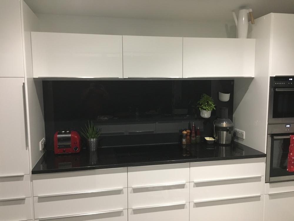

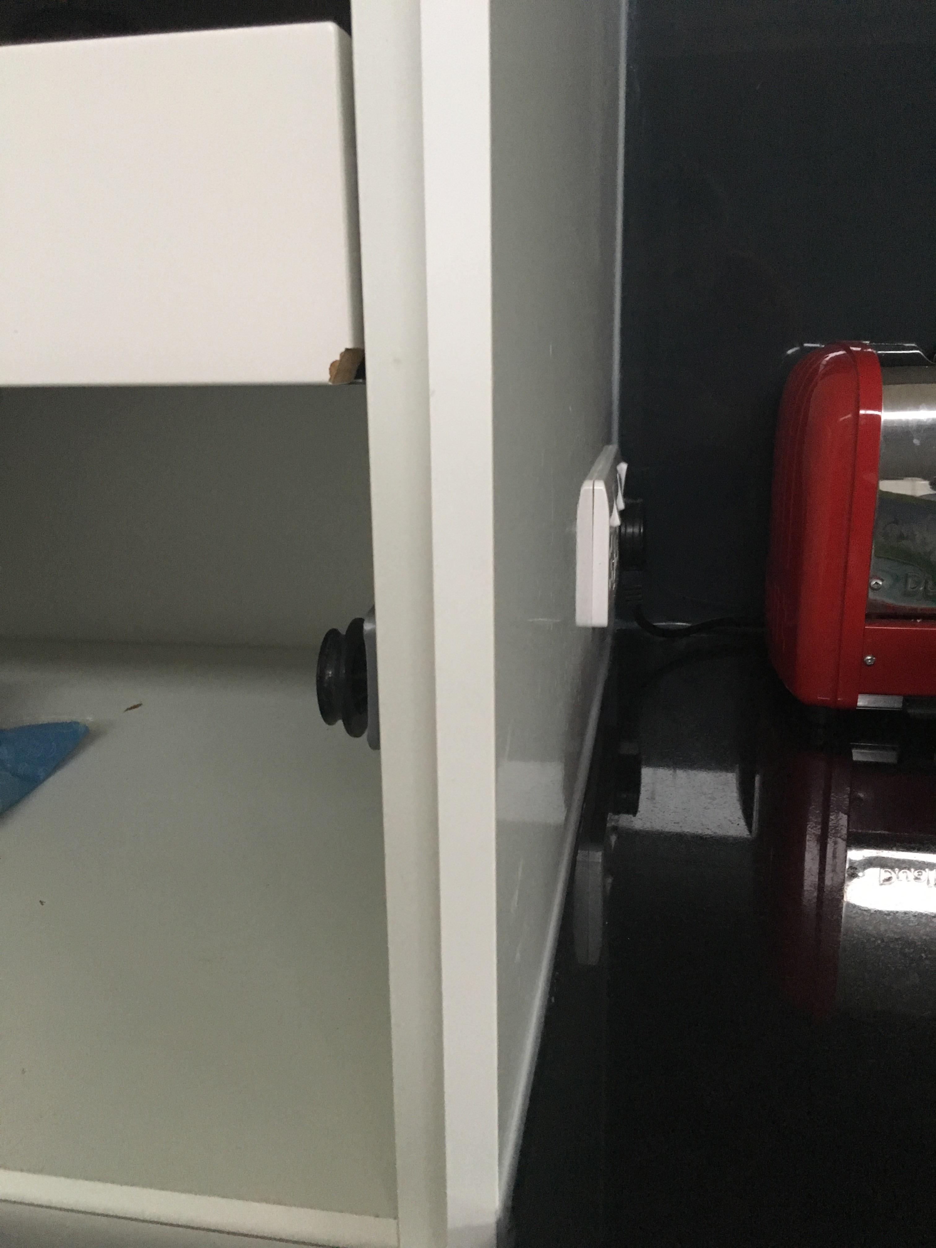

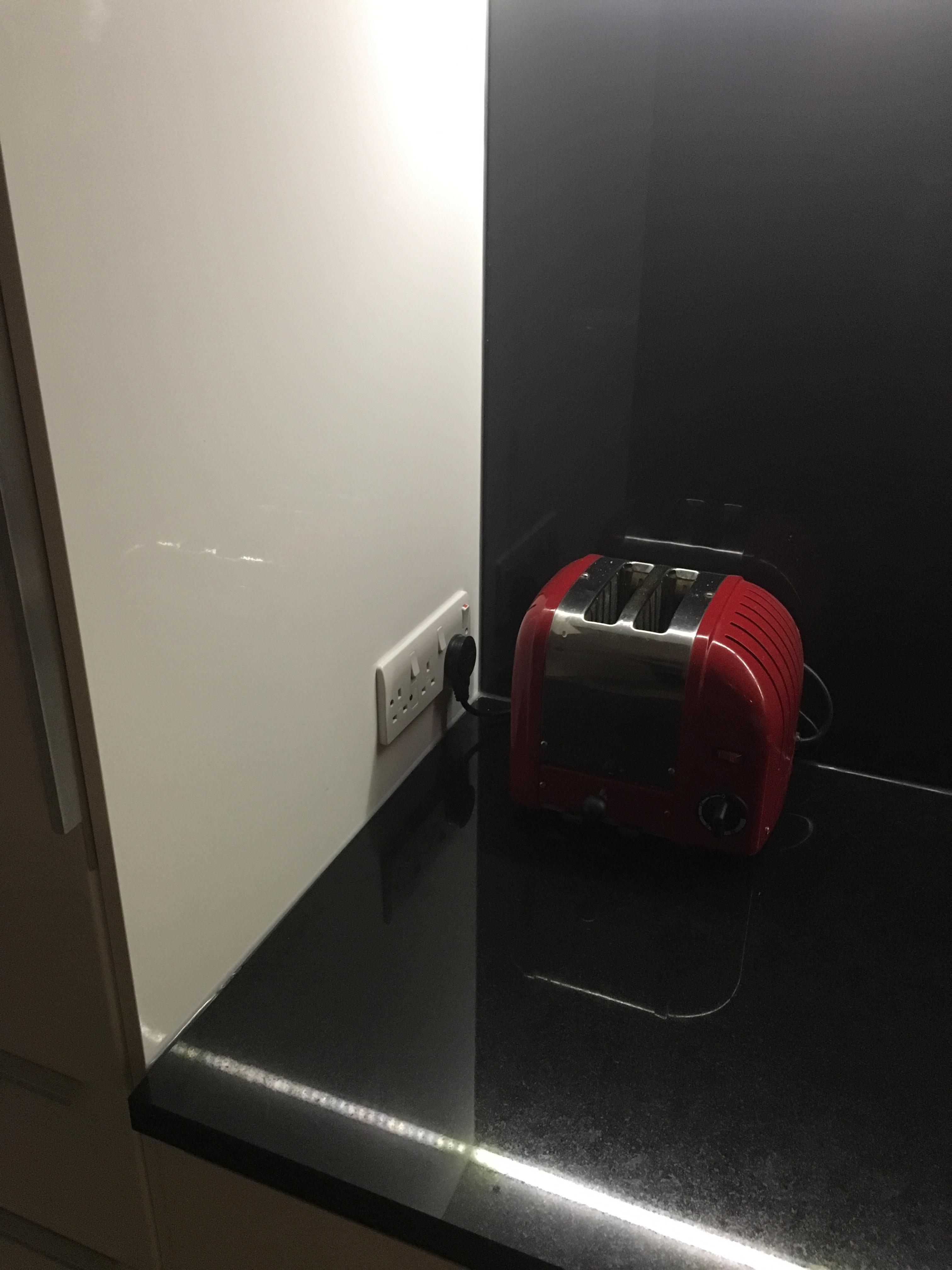

Calvinmiddle Posted July 13, 2017 Share Posted July 13, 2017 Here is a pic of our splash backs and the sockets. Also like the triple sockets even if I do say so myself 2 Link to comment Share on other sites More sharing options...

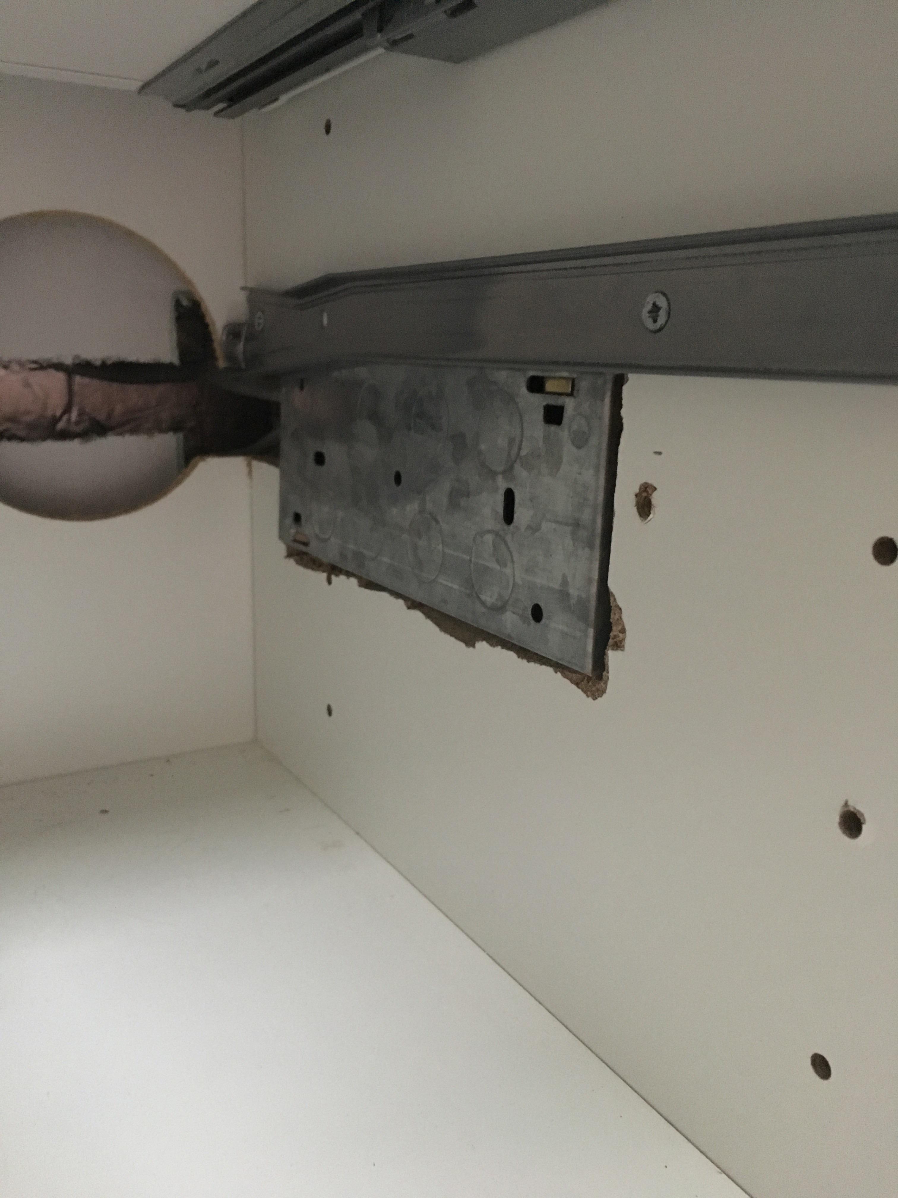

Stones Posted July 13, 2017 Author Share Posted July 13, 2017 @Calvinmiddle I take it you managed to house the socket in the combined depth of the decor panel & cabinet sides? Looks really good, a very neat solution. The splashback I have to do is similar in scope but I do have two sockets in the wall to deal with. Also plan to remove the current upstand. Link to comment Share on other sites More sharing options...
Calvinmiddle Posted July 14, 2017 Share Posted July 14, 2017 That right I did, it was a near perfect fit. Link to comment Share on other sites More sharing options...

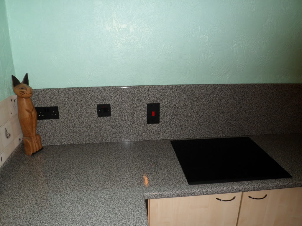

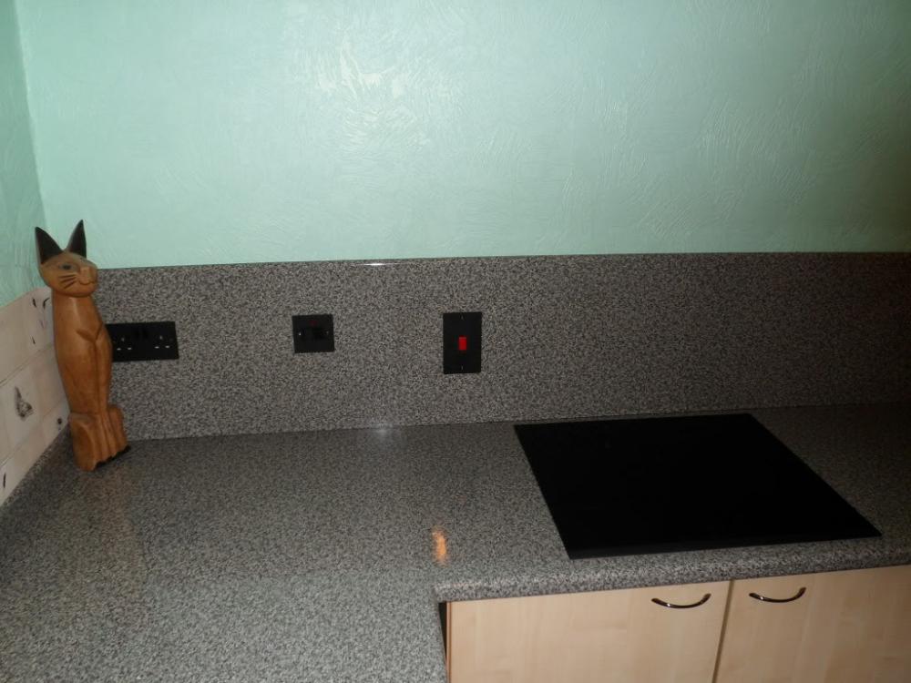

Onoff Posted July 14, 2017 Share Posted July 14, 2017 Cheap seats here as ever but I took a 3m length of cheapo worktop and thinned it down to 1/2". That's my upstand. (Do have a bit of st/st to go above). I routed 3 dead square holes in it that line up exactly with the back boxes. In case anyones wondering, I did have >300mm from the induction hob to the cooker switch until SWMBO decided she wanted the hob dead centre of the double unit instead of dead centre of the right hand door! I've to fit an extractor hood sometime and the st/st sheet between that and the upstand. The switch for that will go to the right of the hob. It'll mean a bit of in-situ routering of the upstand and feeding from the other side of the wall. That'll all be done in 20mm galv conduit like the rest. Link to comment Share on other sites More sharing options...
