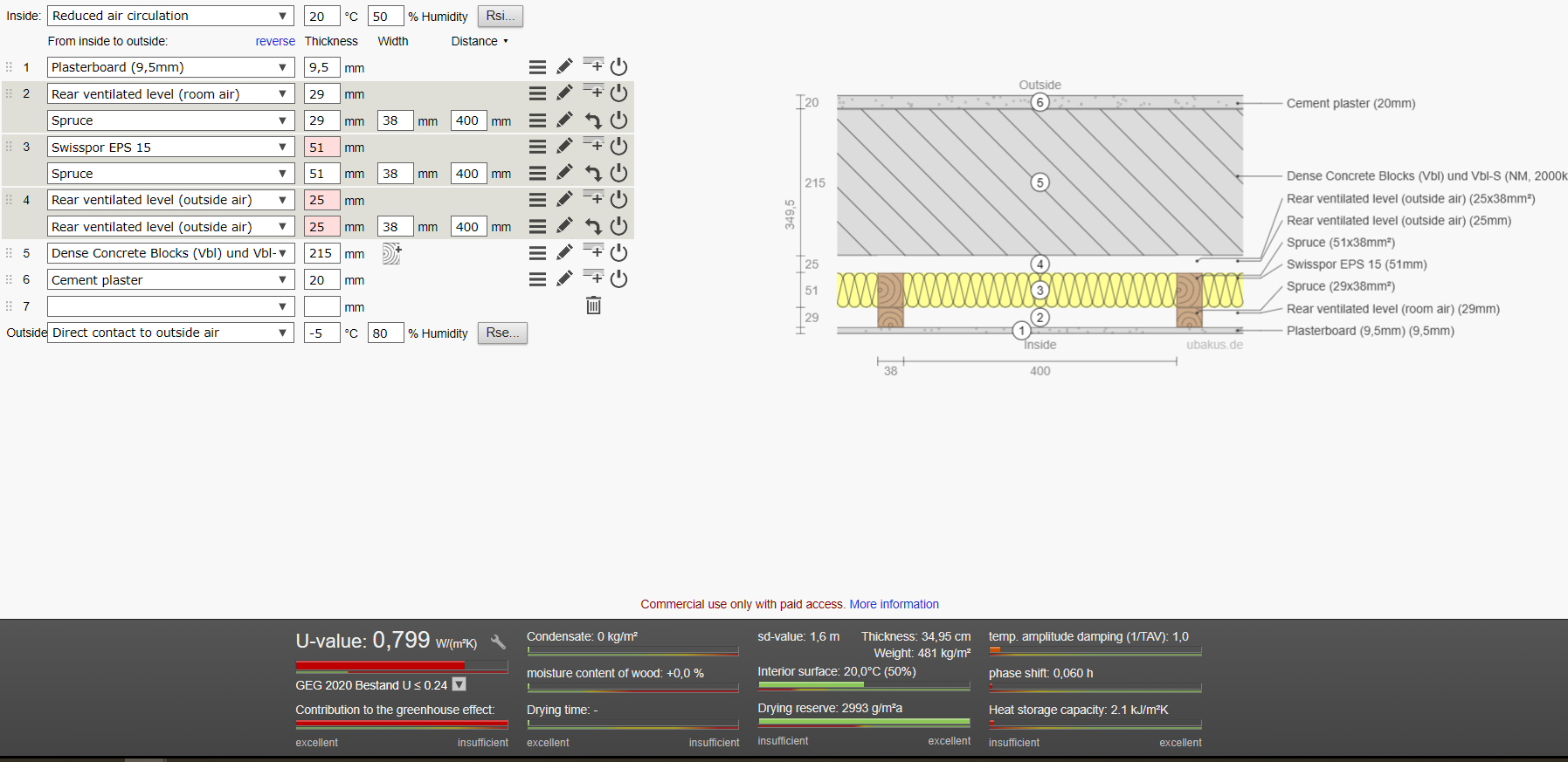

Space Race Posted January 4, 2023 Author Share Posted January 4, 2023 Managed to get a copy of the original plans, I can make out most of the text from the copy but not all hence the odd question mark. Anything to be concerned about here? Thanks Concrete strip foundations all as per foundation layout of drawing Min 450mm below ground level taken down to hard load bearing ground. Walls to be finished externally with grey granite chip roughcast on 215mm dense concrete blockwork apart from from corners on front elevations which will have natural stone. Internally walls to have 25mm cavity 80 x 38 posting at 400mm ctrs between top and bottom runners with one row intermediate dwangs clad with 9.5mm foilbacked plasterboard with (???) laping and plasterstrim(?) at joints. 51mm expanded polystyrene insulation between posts. 100 x 28.. wallplate over d.p.c at wallhead level. 215mm r.c lintols over all openings. all lintols to have min 150mm hold each. Bit?????? felt d.p.c laid on scarcement with 100 x 25mm wallplate over. 100mm honey????? dwarf walls built off concrete strip foundations 300mm wide, 150mm deep, 150mm deep. 100 x 25mm wallplate over d.p.c allow for creep holes. Window cill to have d.p.c at back, ends and underside. Horizontal felt d.p.c incorporated into external wall construction min 150mm above ground level. Link to comment Share on other sites More sharing options...
ProDave Posted January 4, 2023 Share Posted January 4, 2023 80 by 38 studs is a bit skinny and only 51mm (read that as 2 inch) polystyrene insulation in the frame. It's certainly not the best but at least something. That's Taping and filling, usual method in Scotland, you just fill then sand the joints on a dry lined wall. If you want to upgrade it, I would suggest over boarding with insulated plasterboard if you can stand a slight reduction in room sizes. Contrast that with our 2003 timber frame with 150mm studs and 150mm rockwool insulation filling the frame. Link to comment Share on other sites More sharing options...

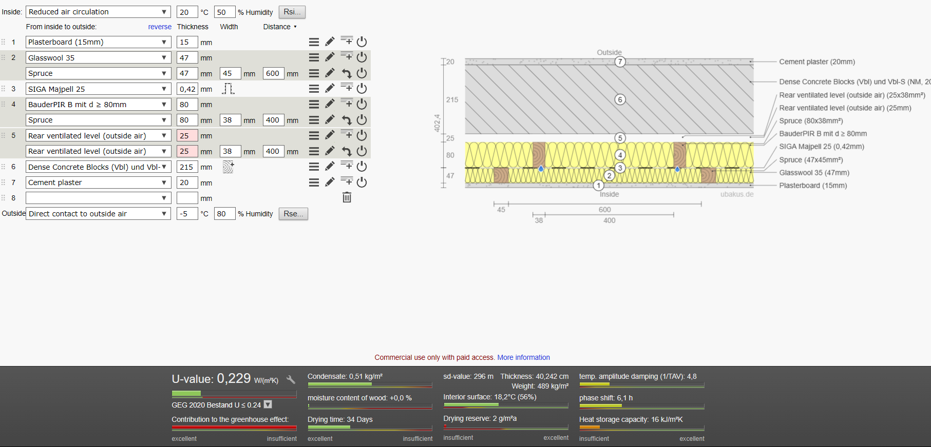

Iceverge Posted January 9, 2023 Share Posted January 9, 2023 @Space Race Is there any way you can get a look inside the walls? At meter boxes, broken plasterboard etc? If not perhaps just measure the overall thickness of the wall as accuratly as you can at a window or door opening. I hadn't thought of it as @Gus Potter suggested. A solid walled house with a TF inside just to provide insulation. These days the TF takes the loads of the house and the blockwork is largely there as a rainscreen. For my own interest I put the original spec into Ubakus for a gander. It's unlightly to perform anywhere near this as the aeroboard is unlightly to be a tight fit. If you were to go room by room refurbing, pull out the EPS, and replace with PIR cut and foam in place. Then add a taped vapour membrane. Then a 45x45mm counter battened service cavity with 0.035W/mK mineral wool infill and 15mm plasterboard You could have something like this. Much more respectable in comfort and energy terms. Tons of work however. Link to comment Share on other sites More sharing options...
Space Race Posted January 9, 2023 Author Share Posted January 9, 2023 Thanks Iceverge, I'm not familiar with these results so will need to do further research. Unfortunately it looks like the 215mm block is in fact a 140 which I assume would throw things off Link to comment Share on other sites More sharing options...
Iceverge Posted January 10, 2023 Share Posted January 10, 2023 On 09/01/2023 at 17:45, Space Race said: Thanks Iceverge, I'm not familiar with these results so will need to do further research. Unfortunately it looks like the 215mm block is in fact a 140 which I assume would throw things off No, I'll be the same regarding insulation. concrete thickness makes almost no difference to the heat loss value and none when there's a ventilated cavity inside it. Link to comment Share on other sites More sharing options...

SteamyTea Posted January 11, 2023 Share Posted January 11, 2023 (edited) On 09/01/2023 at 17:20, Iceverge said: hadn't thought of it as @Gus Potter suggested. A solid walled house with a TF inside just to provide insulation. These days the TF takes the loads of the house and the blockwork is largely there as a rainscreen You have to be careful with this construction as any joist/roof truss ends may be susceptible to condensation, especially if any extra internal insulation moves the dewpoint. Edited January 11, 2023 by SteamyTea 1 Link to comment Share on other sites More sharing options...

Space Race Posted May 25, 2023 Author Share Posted May 25, 2023 Just to follow up (better late than never!) Gus Potter was spot on, It's a solid wall construction with a small gap and then a timber stud frame with insulation. Apparently this is very common in this area. All moved in and enjoying the new home. Thanks to everyone who pitched in with their thoughts. 1 Link to comment Share on other sites More sharing options...
