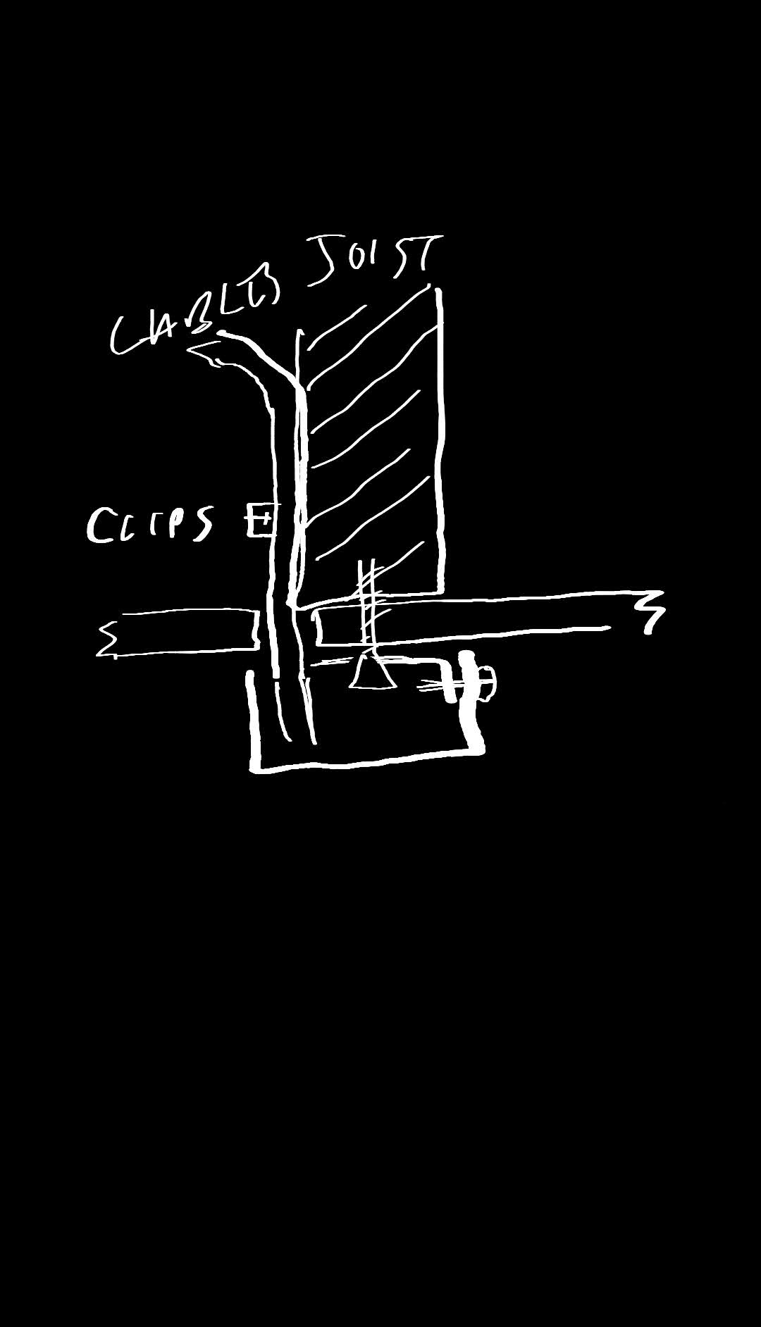

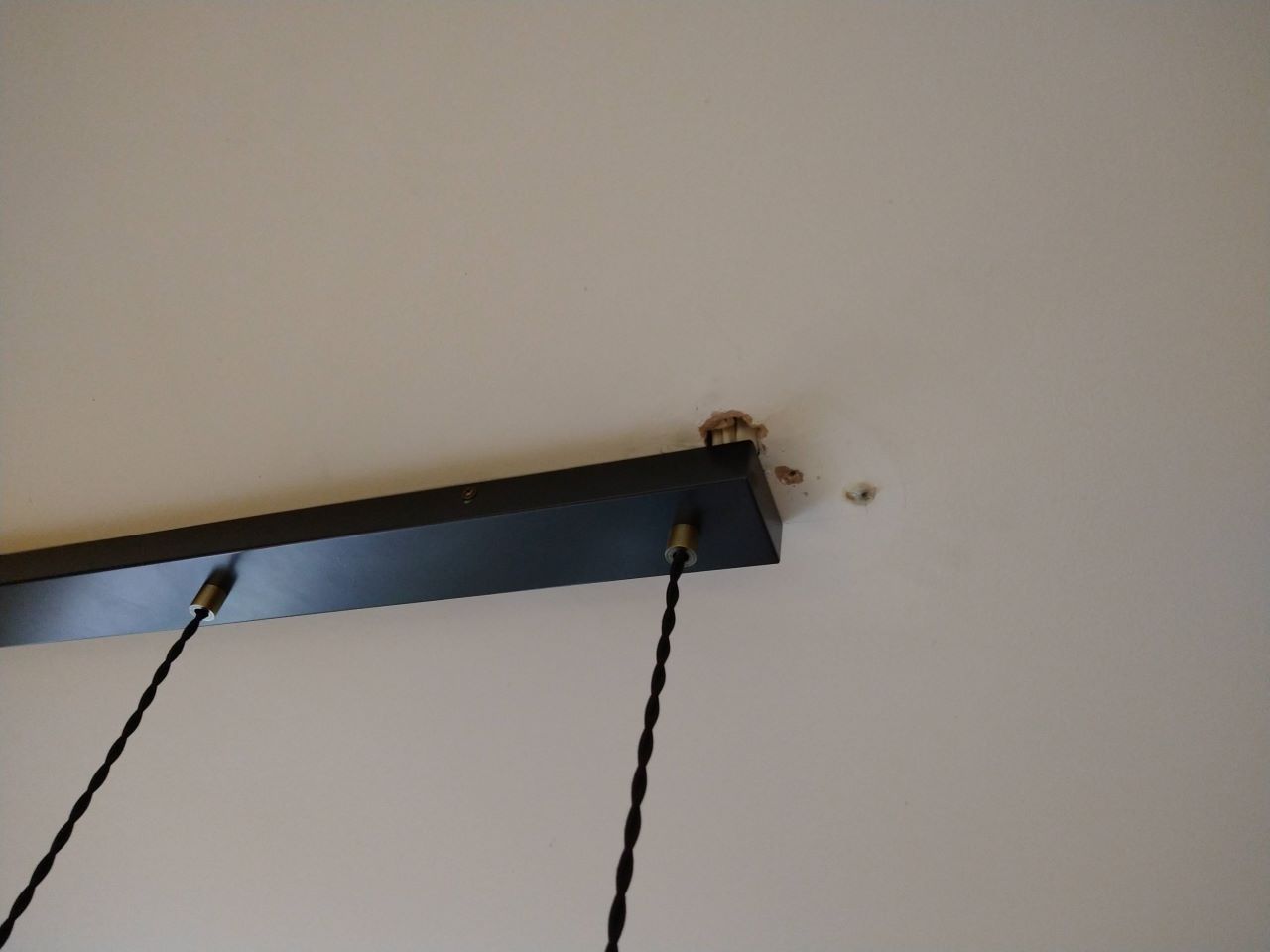

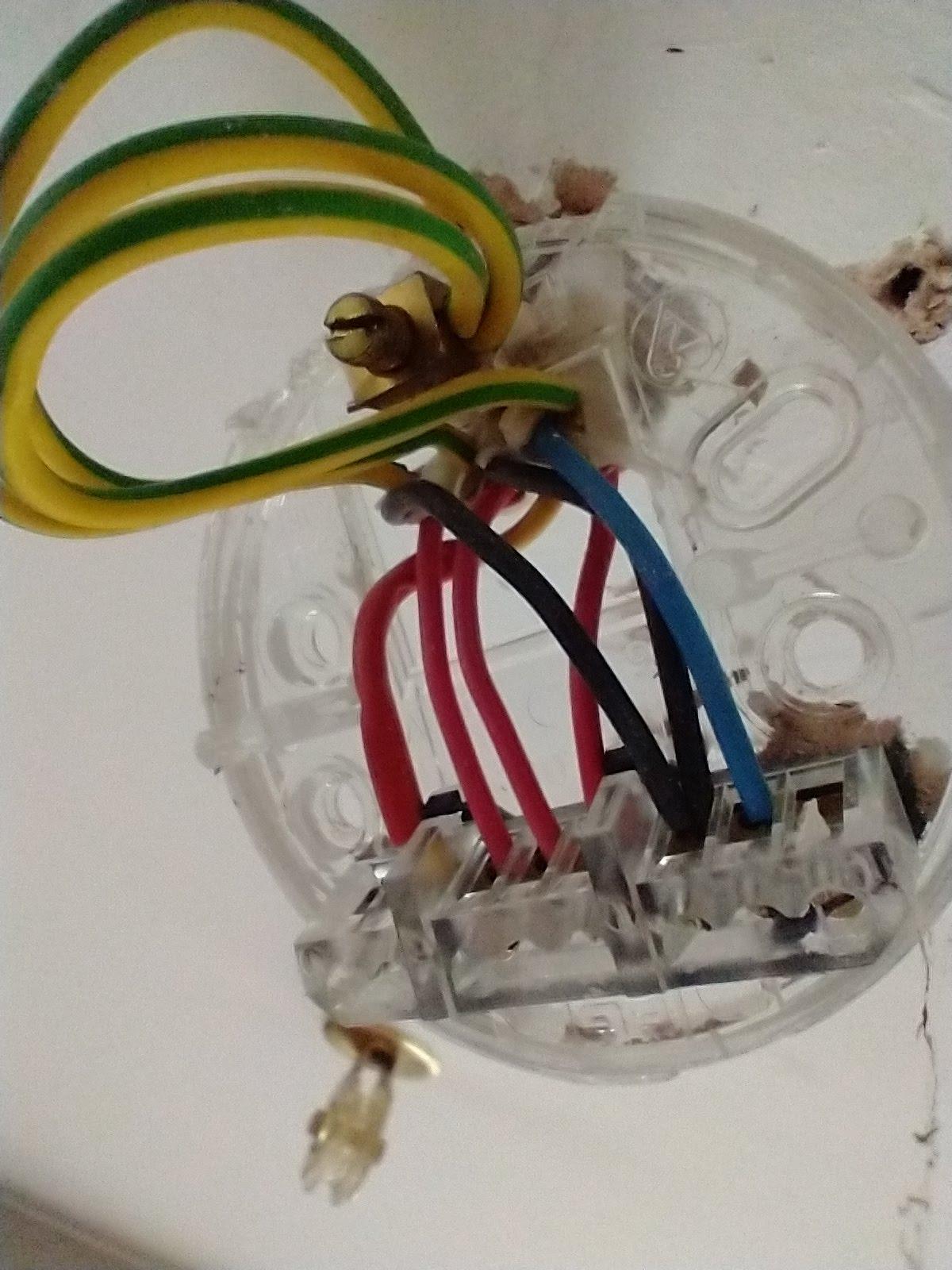

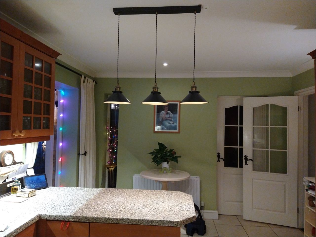

Radian Posted December 29, 2022 Share Posted December 29, 2022 Our kitchen had a single pendant drop at the far end of a peninsular worktop which never really lit the surface very well so we recently bought a triple pendant unit which works better but having just fixed it to the ceiling as far over as possible (as determined by the cable position) it's still not sat entirely over the worktop: It needs to be about 20cm to the left. Here's a close-up of the end where the cables come out the ceiling (originally into a pendant light pattress hence all the holes that need filling) and these cables are the reason I couldn't get it any further over: There's a floor joist directly above the black metal case of the pendant unit (ideal from the point of view of fixing it to the ceiling) and I can just see that the cables for the original light pendant are clipped to the side of the joist immediately above where they come through. Ideally I would access all the wiring from above and just move it over to a new hole but the room above has fitted furniture which makes this impossible without doing some major deconstruction. I'm not quite sure how to proceed. I don't want to enlarge the existing hole for the cables any more than I have to as it will all need filling. I don't know how much spare cable there is either. I can cut a new hole for the cable drop further along but again, I don't want to make the new hole too big as it's right out at the edge of the metal box. It's also a pain that there are three cables to terminate as the live and neutral is looped out to other ceiling lights. I'm not sure my luck would hold out if I pushed them all up into the ceiling void and tried to pull them back out again through another hole. Anyone got any bright ideas? Link to comment Share on other sites More sharing options...
ProDave Posted December 29, 2022 Share Posted December 29, 2022 Just to clarify. is the joist running parallel with the light fitting? or crossing it perpendicular? The number of cables suggests it is wired "loop at light" can you confirm? If so I would cut a small hole in the plasterboard straddling a joist. Yes really. This will give you room to terminate all the cables with maintenance free terminals in a suitable box with just one outgoing cable to the light fitting. Screw the square of plasterboard back to the joist, easy as it was cut straddling the joist, fill the gap where it was cut and paint. Link to comment Share on other sites More sharing options...
TonyT Posted December 29, 2022 Share Posted December 29, 2022 Looks like 3 twin and earths from the photo so totally agree with Dave above. Live/Line and Neutral in - 1 cable Live/Line and Neutral out- 1 cable 1 Live/Line and Switch wire - 1 cable Link to comment Share on other sites More sharing options...
Radian Posted December 29, 2022 Author Share Posted December 29, 2022 The long black box runs parallel to the joist and is barely wider than it (about 57mm wide on a 47mm joist): Of the three cables, one is 4-way with a red sleeved "switched live" to this fitting, and three other sets of lives neutrals and CPC's are connected in parallel. Link to comment Share on other sites More sharing options...

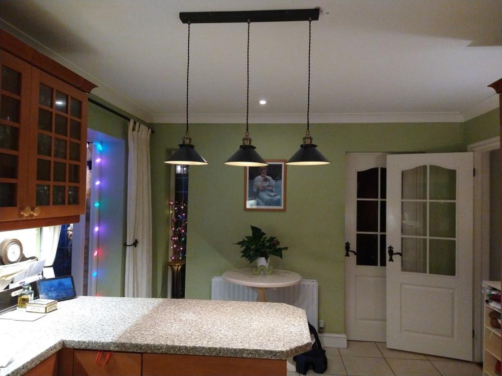

Radian Posted December 29, 2022 Author Share Posted December 29, 2022 Oh yeah, I forgot, I took a photo before I started: Link to comment Share on other sites More sharing options...

Radian Posted December 30, 2022 Author Share Posted December 30, 2022 10 hours ago, ProDave said: If so I would cut a small hole in the plasterboard straddling a joist. Yes really. This will give you room to terminate all the cables with maintenance free terminals in a suitable box with just one outgoing cable to the light fitting. You mean just enlarge the current hole by enough to get the three cables plus a new one (for the light fitting) up above the plasterboard? If I could pull the cables down far enough to strip more of the outer sheath and work with individual wires I might be able to use twist connectors to join them and push them through one at time I suppose. I think that Wagos would be too bulky. Link to comment Share on other sites More sharing options...

ProDave Posted December 30, 2022 Share Posted December 30, 2022 3 hours ago, Radian said: The first option means fixing the cut-out piece back in place (after fixing a support batten straddling the hole) and the cut out piece already has a big hole in it so it will be quite fragile I am talking of cutting a square about 4 inches /100mm square, with one edge of it at least on the centreline of the joist. You can than connect properly with maintenance free terminals in a junction box. Push that up into the ceiling, thread your new output cable to where you want it then screw your square of plasterboard back to the joist, or if you have some spare offcuts of PB cut a new square the same size that won't have the original hole in it. It is easy then to fill the gap with sandable filler, and end up with an invisible repair that can be painted. I very much doubt there will be enough slack on the existing cables to move the whole bundle over. Link to comment Share on other sites More sharing options...
