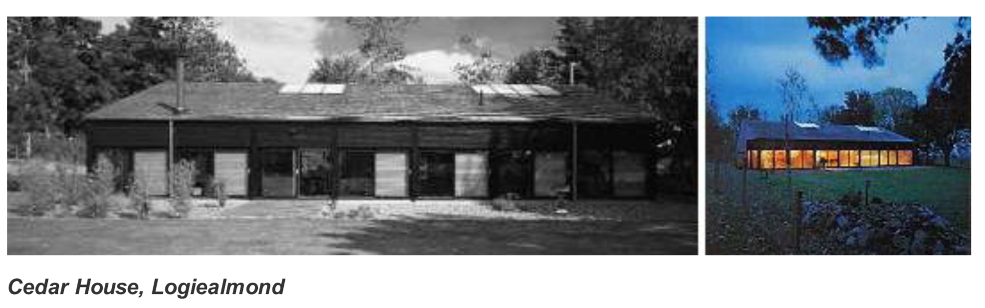

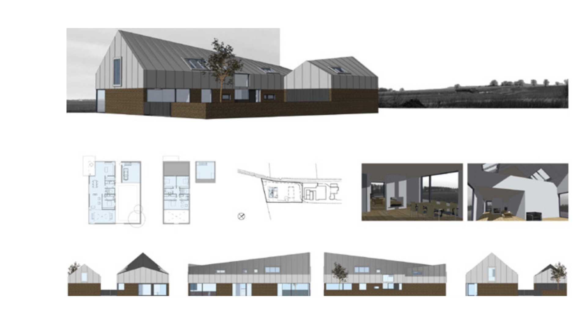

Papillon Posted January 7, 2023 Share Posted January 7, 2023 (edited) I forgot to add, the design with the arches and dormer windows is not very good from a design point of view. It doesn’t fit with the local style and it’s really ugly. from the place making guide you have to follow: Using existing onsite timber and stone, this award winning contemporary, sustainable home, has been designed with careful consideration to its context through form and finish. Built within budget ethos; this award winning building shows how appreciation for context and a subtle application of high quality building materials are two basic elements to get right for a well considered design solution whilst not having to cost the world. https://www.wowhaus.co.uk/2014/05/02/on-the-market-cedar-house-modernist-property-in-chapelhill-logiealmond-perthshire/ Edited January 7, 2023 by Papillon Link to comment Share on other sites More sharing options...
Kelvin Posted January 7, 2023 Share Posted January 7, 2023 18 minutes ago, Amateur bob said: Thanks yes ive had a good look through these scotframe ones, i liked the origional design we put in but they didnt want 2 storey and said it looked too suburban so thats why we were adapting it, im not sure of the new look though whats your own personal thoughts on it, do u like the arches and dormsr windows? Thanks I’m surprised your architect submitted a 2 storey design. It’s not common to get that approved in rural Scotland. The adapted design is still too suburban. Contemporary designs can get approved but they are still designed to meet the local vernacular. For example this was built just down the road from us. It’s within a farm setting. Link to comment Share on other sites More sharing options...

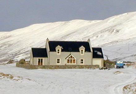

Mr Punter Posted January 7, 2023 Share Posted January 7, 2023 (edited) You could look at some plans and see what would suit. These are from an Irish site: http://blueprinthomeplans.ie/houseplans-sc.asp?sC_ID=117 but I am sure there are Scottish examples. I quite like this sort of thing but maybe without the side bits: Edited January 7, 2023 by Mr Punter Link to comment Share on other sites More sharing options...

Amateur bob Posted January 7, 2023 Author Share Posted January 7, 2023 2 hours ago, Mr Punter said: You could look at some plans and see what would suit. These are from an Irish site: http://blueprinthomeplans.ie/houseplans-sc.asp?sC_ID=117 but I am sure there are Scottish examples. I quite like this sort of thing but maybe without the side bits: Ill attach a similar one i saw on scotframes website what do you think of this compared to my design? Link to comment Share on other sites More sharing options...
