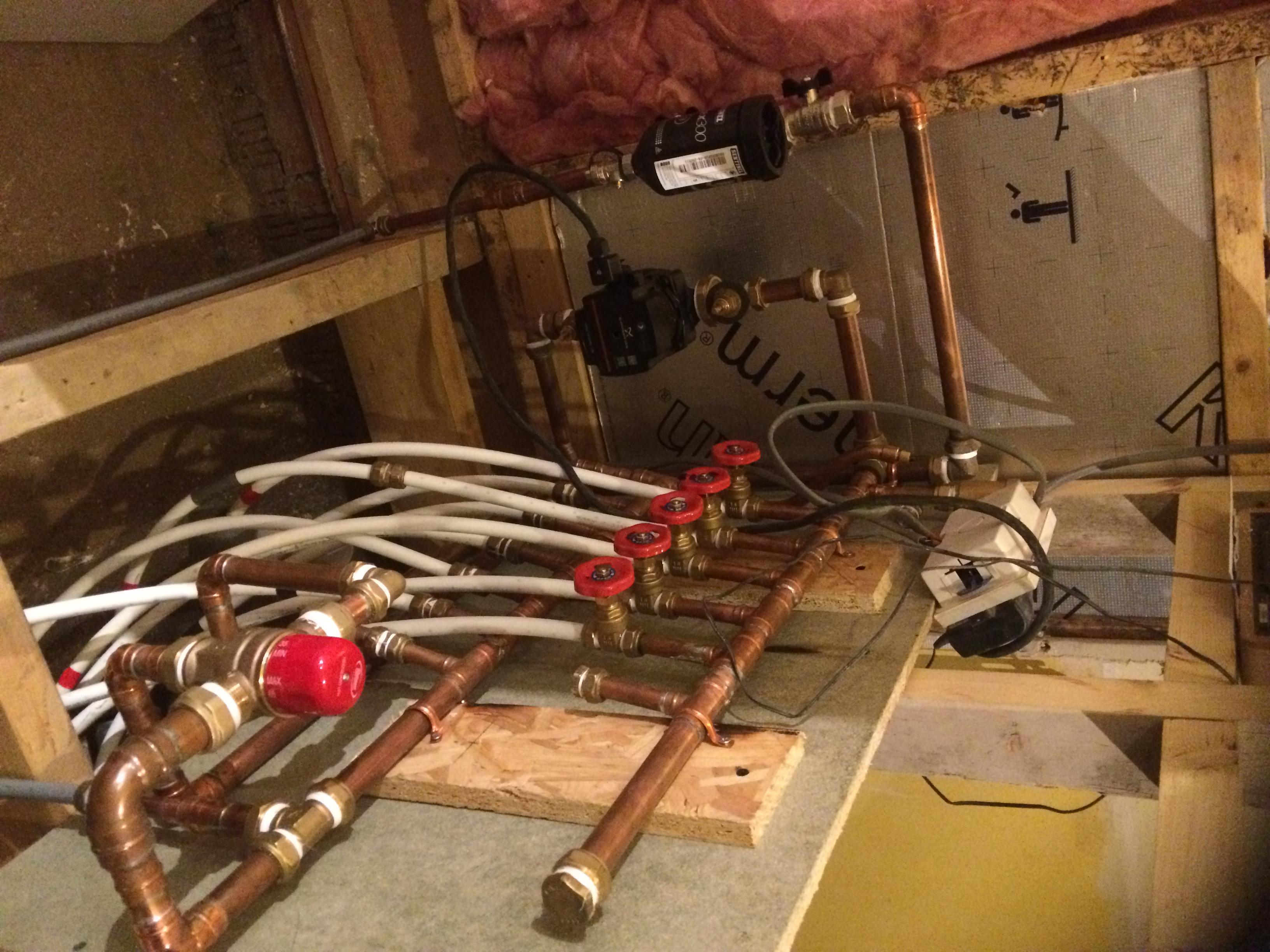

Gus Potter Posted December 28, 2022 Posted December 28, 2022 Thanks folk for all you comments and time spent writing. On 27/12/2022 at 15:09, tuftythesquirrel said: Sorry this is a bit long, Expand Trying to digest it all at my end and thought I would respond in a way longer than you.. I have an ex council house, extended with a hybrid system. Thus new solid concrete slabs and retro fitted timber suspended floors Rads on the top floor I oversized them to keep the flow / return temperature down to promote the boiler to condensate. Ground floor has a combination of retrofitted UF on the old timber suspended floor with and extenion that has a concrete slab. It sounds dog rough but I made my own manifolds and it is really simple. Few electronics. But it is user friendly and simple to maintain. The house is much bigger now and we use less energy to heat it even though the house is much bigger. If things break I can fix it in an hour roughly.. don't know as have had no problems. Look folks.. this home automation.. have you factored in how often you are going to have to replace the different parts? Also who other than you is going to be able to fix it? You could be doing something that detracts from the house value? I'm all for technology, I'm a pretty innovative designer, love working with new materials and learning about their behavoir.. but I also as a designer I need to give best advise to my Clients and that includes ongoing potential maintenance and often environmental cost. Relpacemnt of parts is also an environmental cost.. intuitively the less parts the lower the environmental cost? I'm just asking you to think about this, I'm not slagging the concept off. I'm not kidding you.. I got a guy in to service my boiler.. he has a PHD.. but became a heating enginneer, he had the cheek to say to me you are asking me tecky questions and you are asking me to give away my trade secrets, my response.. hey donkey if you want play that game.. and this is from a guy that works with a regular contractor that I do design work for. I am paying him to be techy with me and want sensible answers.. ground my gears. The point is .. keep it simple.. yes if you want to make your house high tech.. fine but I would not buy your house... unless you can produce a full and verified O & M manual.. otherwise you could buy a pup! High tech can be an appreciation of simplicity and how you get the best out of it. Folks UFH is supposed to be simple that is the elegance of the principle. I'l say agin UFH is supposed to be simple and environmentally friendly! It works great when you design the rest of the house to suit. It's holistic design. I designed my first UFH some 25 years ago. The Scandinavians have done it for much longer. Lets just look at the cost of all the controls, flow meters, zoning, automation. It will probalbly be fine at first installation but just wait for two or three years.. then when things start to fail, getting replacemet parts.. good luck to you. Yes weather compensation works but when you look at the lifetime of the buildings and they way folk use it.. I'm not sure about how friendly it all is. The house I have at the moment has hybrid floors, all sorts of nuances but as a kick off I just built a simple manifold DIY.. it's working great, to set it up I just put my hand on the flow and returns pipes and crancked down the really hot ones. yes folk say I should not use gate valves but I did this 25 years ago.. if one leakes.. a couple of quid to fix it. To say again..UFH is easy to design, the controls can be very simple. There are some basic conservative rules. For 15mm pipe keep the loops under 75m, DO NOT over bend the pipe. MAKE sure you get plenty flow rate.. it can be turned down. It is really simple with common sense. If you are using a pug mix my own view is that you should pressurise the UF pipes to say 4 bar then pour in the concrete. Reasoning is this.. the pipes need to last for 50 years. The heating system may run at about 1.5 Bar but will expand and contract over the length of the runs. They have bends that are in the pug mix.. thus abrasion will occur. The pressure relief valve on a typical system is set at 3.0 bar.. in the round the 4.0 bar pressure at time of laying the pug mix will be just enough to compensats for the screed shrinkage and movement in the sreed plus say movement in the structural floor.. my gut feeling is that this will allow the pipe to last 50 years. To put this into context. I did my first UF system some 25 years ago, have been keeping an eye on others and had hand in others for some 30 years.. have not seen signs of abrasion in the UF pipes in a pug mix to date. To be honest when these pipes were installed they were sold as barrier pipes.. to stop oxygen ingress, I though it was a bit bollocks at the time but the boilers have held up so maybe it was not sales bollocks after all. Nice to be proved wrong. Yes if the weather suddenly warms up there is a lag time.. but all that happens is we say.. it's warm outside and the house is a bit warmer.. but that can happen on a sunny day too as we get a lot of solar gain. The thing is that in the UK UFH is great but from time to time the house may get a little warm.. it is rare.. just open a window or the door! There will probably be folk going in and out the house anyway so any heat model you make it likely a bit rough. Save your money folks and go for the most simple system you can.. have a look at the Sputnik that the Russians sent to the moon. .it had gate valves (look like Screwfix today) brave boys right enough. Think.. how much is my home automation going to cost vs a Guses "Fintstone" design.. If there are any takers I'll be happy to defend my design approach as I think this is the best environmental choice and most cost effective in the long run. There is one caveat.,. you need to make sure we are debating on a reasonable insulated external house envelope. There you go have stuck my head above the parapet. In other words.. I'm saying that for UFH go for the simple stupid, low maintenance solution. Save yourmoney and spend it on the insulation envelope.. or if you have large areas of glazing then spend you money on sinking the solar gain into an internal wall to be released later. I know folks on BH debate thermal mass.. but that is not what I'm talking about.. more the concept of how a Tromb wall works and how you start with the paint finish and store the solar gained heat from that. @tuftythesquirrel When I say simple DIY UF manifold have attached the prototype I talk about above. Yes I know it is probaly a million miles away from what you envisage. But it works, is cheep maintainable and reliable. 2

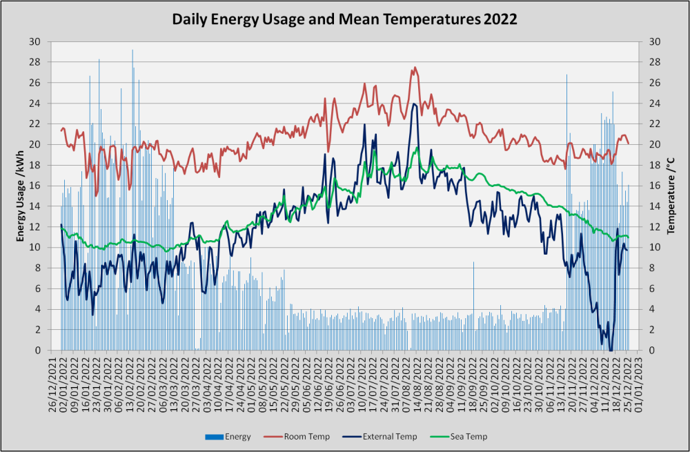

SteamyTea Posted December 28, 2022 Posted December 28, 2022 I am with @Gus Potter I dislike anything that is over complicated. I have very basic E7 storage heaters, they have two controls, energy in, power out. Sometimes I adjust them. Below is a chart that shows this year's energy usage and temperatures. This year has been useful as we have had extreme (for UK) heat, cold and dryness (more solar gain). At the beginning of the year, I was away for a few days at a time a lot, I would turn all the power off and let the house do its things. This used less energy, but larger swings in temperature. Heating was totally off by the 14/03/2022 and did not come back on till 15/11/2022, so 119 days of heating and 246 days without. A quick look at the data shows that at the start of the year, the mean external temperature was 7.5°C and the house temperature was 19.1°C. End of the year mean external temperature was 6.3° (1.2°C lower) and the house temperature was 19.3°C (0.2°C higher). Energy usage was similar at less than 0.8 kWh/day difference, with the beginning of the year using less. When looking at the variation in temperatures, at the beginning of the year, the min and max external temperatures were 0.1°C and 15.9°C, with the house swinging between 5.2°C and 23.3°C (this was when I was turning everything off). The maximum power draw was 10.6 kW. So far this winter, the min and max external temperatures have been between -2.7°C and 13°C, with the house temperatures between 16.1°C and 22.6°C, maximum power draw has been 8.3 kW. Two proper temperature distribution would show what is happening better rather than the extremes. 1
