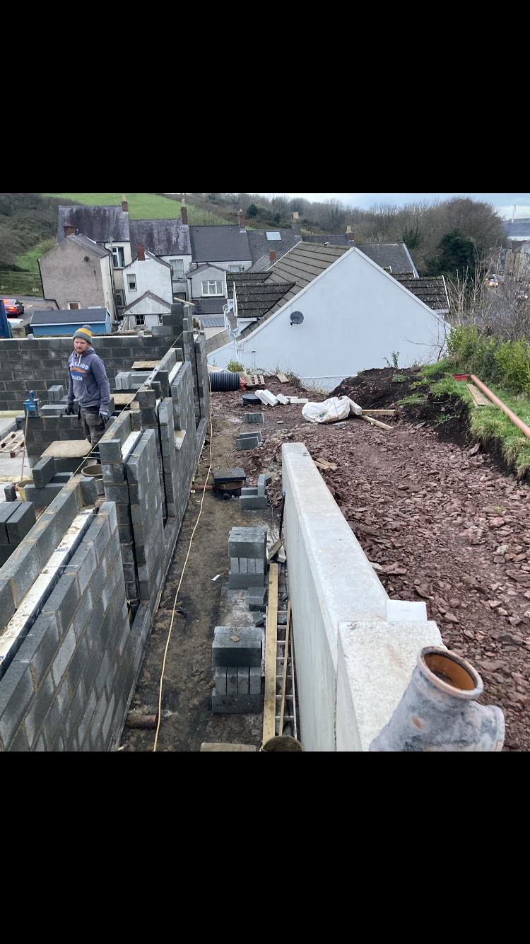

DeanoFromTheDock Posted December 27, 2022 Share Posted December 27, 2022 Hello all,, just a quick question before I send it off to the enginner, has anybody used beam and block for external use? as you can see by the pictures I have a retaining wall which is set back from the house.. I’m looking to bring a block and beam from the outer skin of the house and sit on a frame/retaining wall and this use this base as our patio screed over the top and then slab.. has anyone used beam and block for external use before? What I was thinking of doing is bitumen all external parts of the beam before cladding of some sort to keep it weather proof any replies would be appreciated Link to comment Share on other sites More sharing options...

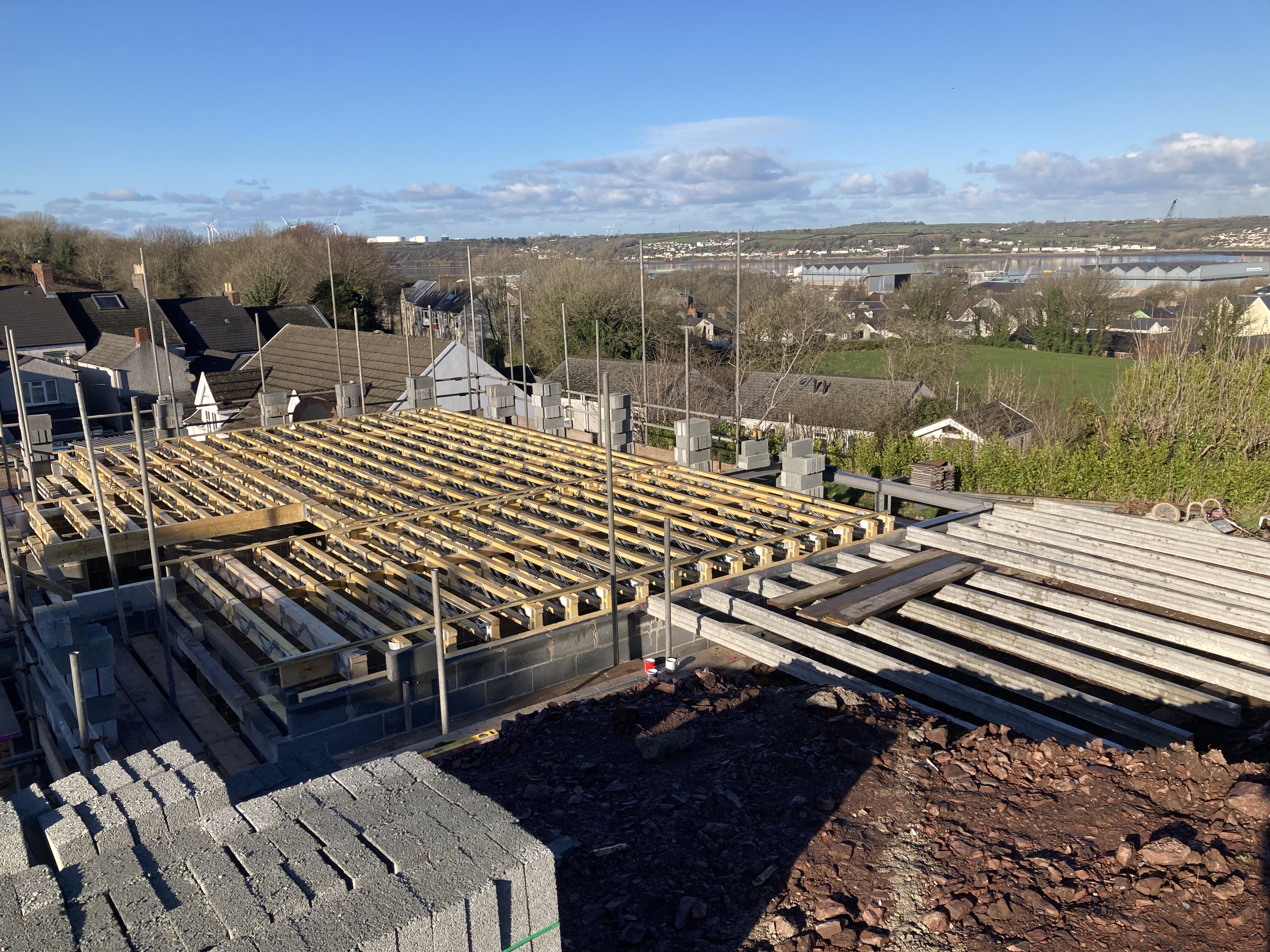

DeanoFromTheDock Posted December 27, 2022 Author Share Posted December 27, 2022 Thank you mr punter.. was a bit of a struggle but we are getting there. It is up to first floor level currently waiting on joists and scaffold after the new year so trying to sort this beam and block idea asap im only looking at using 4.2m beams build another small wall to carry the end of the beams.. the architect seems to think it will be fine but wants me to check with the enginner. I was just thinking of using a cement wash over the top and screed and patio slab on top.. but if anyone has any better ideas I’m open to listen? Link to comment Share on other sites More sharing options...

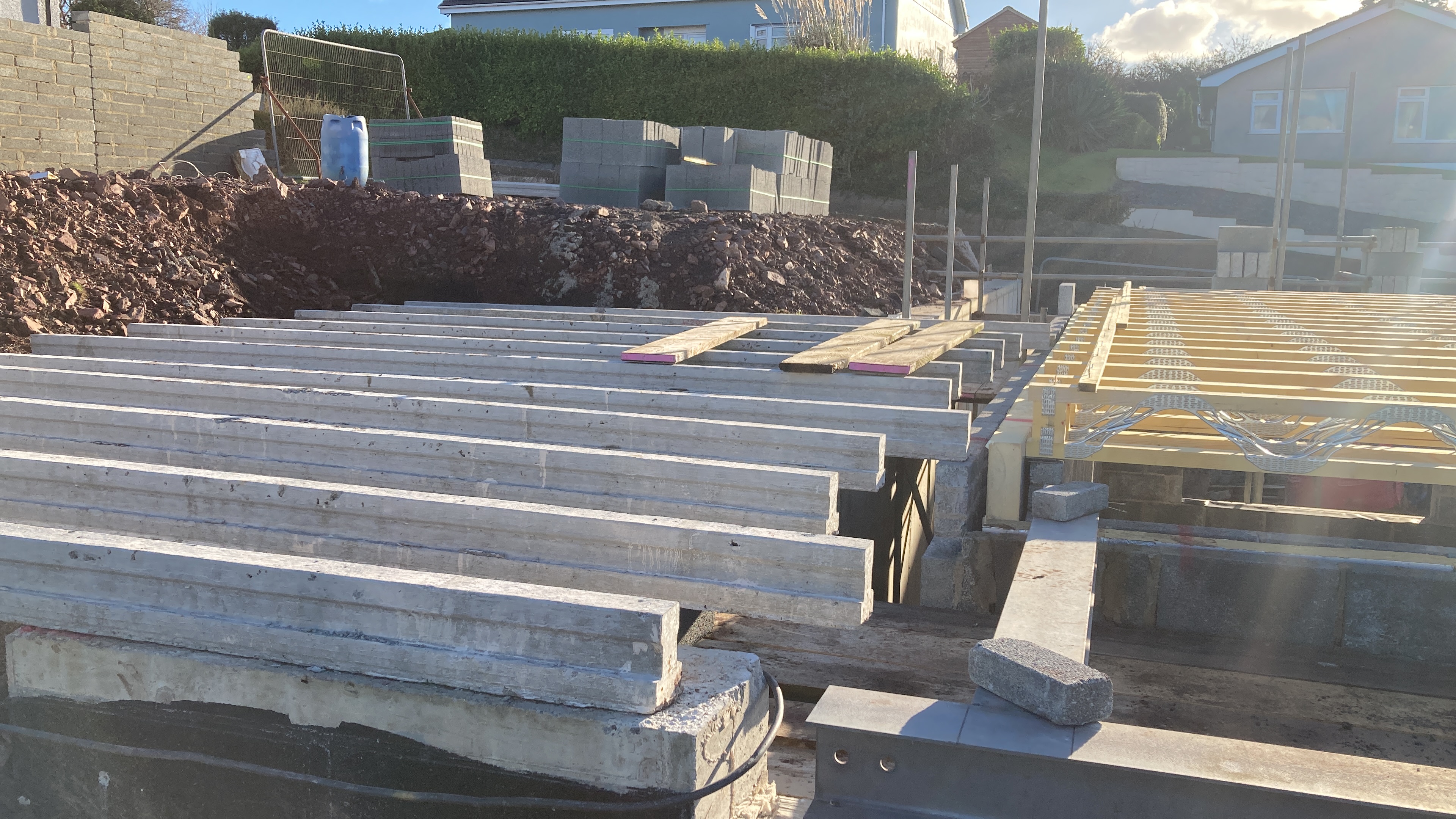

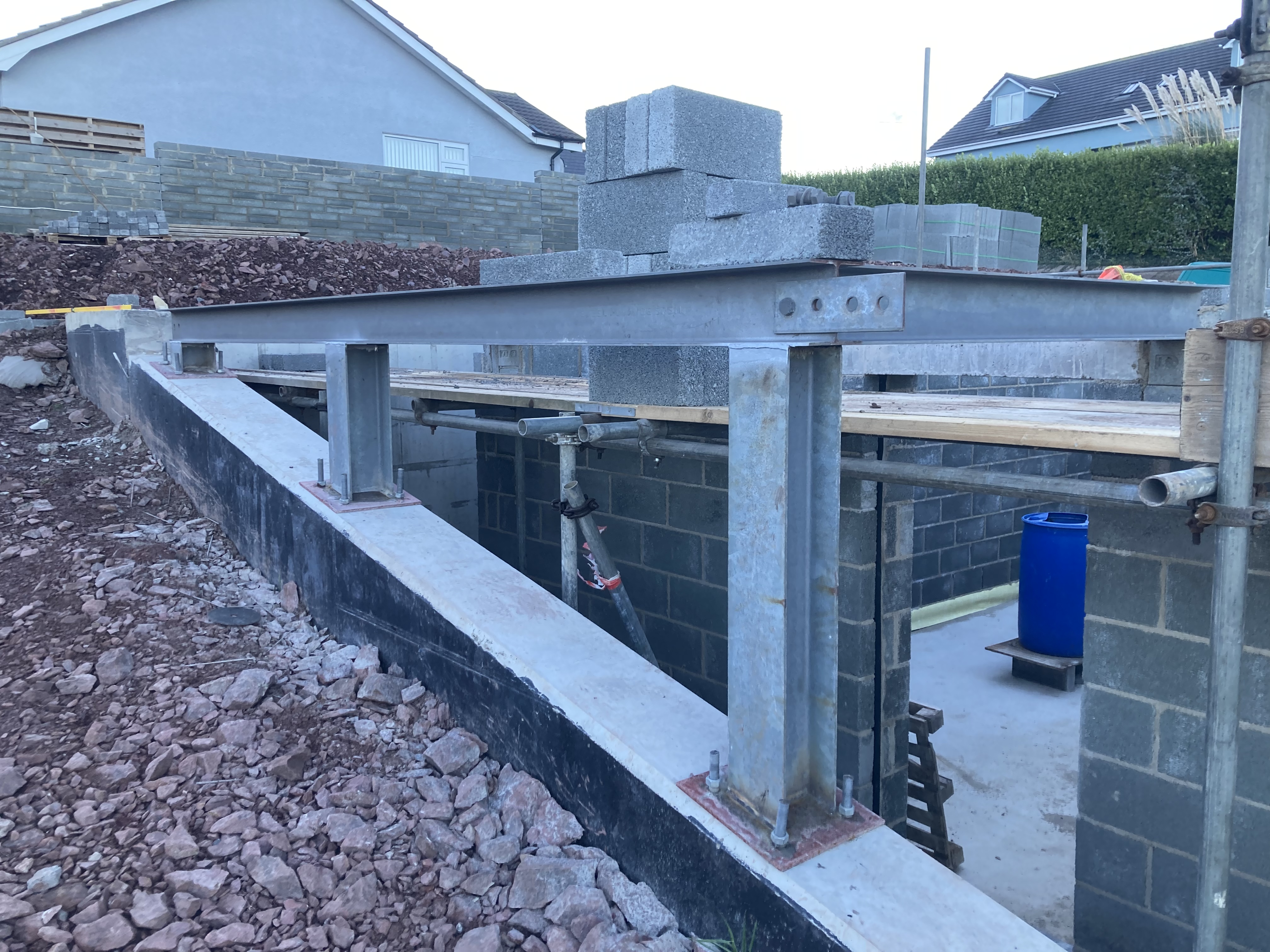

DeanoFromTheDock Posted December 28, 2022 Author Share Posted December 28, 2022 Thank you for the replies.. I’ve added another picture.. this span is about 1.5m.. I’m having a galvanised H beam frame being fabricated which will carry the beams from the house. as the first image.. I’m thinking same again as to tie into to the house, the retaining wall will carry the bull of the load plus I’ve dug a footing to build a small wall block on flat to carry the end of the beam.. I’m looking at 4.2m beams.. this will then become only a patio area no storage.. I was thinking of a slurry screed and to bitumen all external parts of the beams before slabbing on top?? the other option is timber and composite decking but I don’t really like this idea? What are your thoughts? I’ll be going to the SE first week of January with my idea Link to comment Share on other sites More sharing options...

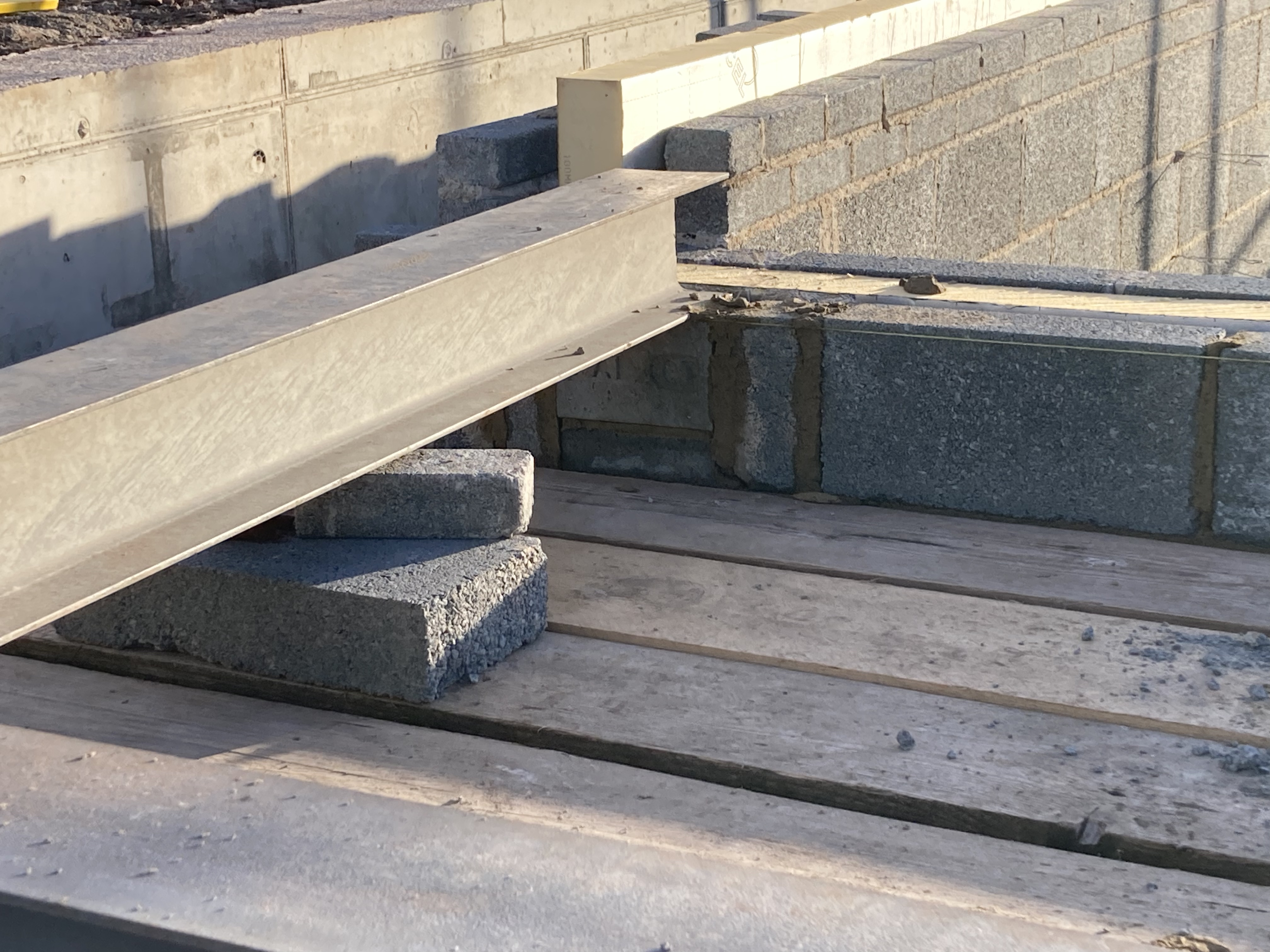

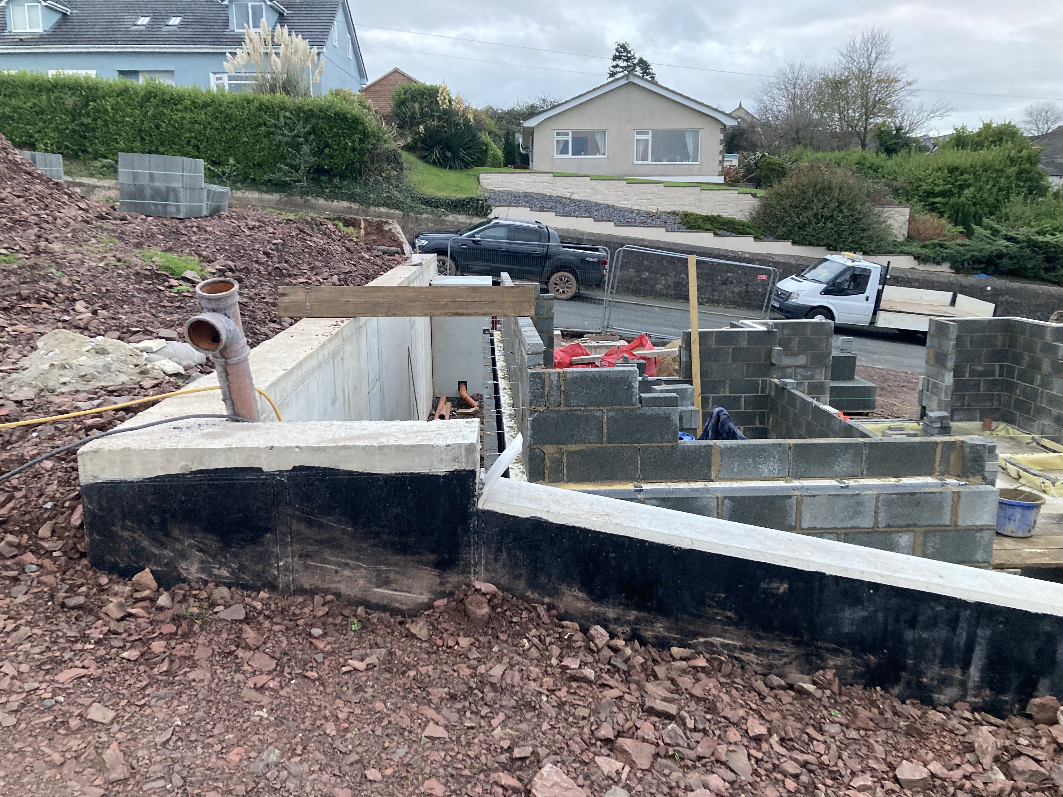

DeanoFromTheDock Posted January 24, 2023 Author Share Posted January 24, 2023 Good evening Gents, Just a quick update on what has been said by the SE I contacted the block and beam supplier in bristol and asked about external use and for a copy of the data sheet.. they informed me that external use for beam and block is fine. The SE originally way over specked the design for the north elevation balcony (in the pic where the brickie is) he wanted 8" steels to carry the block and beam at 2.1m long... wasn't happy with this as it would of meant having a small step from east side to north side... so i decided to change the design.. on the east side we have 4.2 b&b which will sit on the external skin of the house sit on the retaining wall and ive also built a block on flat wall at 4m to carry the load all agreed and happy with the SE... The only thing he wanted was an 8" lintel to carry the last 3 beams.. i will run a dpc tray for the beams sitting on the external skin of the house blockwork for the north facing balcony we have used 6" galvanised i beams which will now carry a timber frame and have composite on top.. we have built to supports into the house which are sitting on padstones.. thank you for the feedback gents Link to comment Share on other sites More sharing options...

DeanoFromTheDock Posted January 24, 2023 Author Share Posted January 24, 2023 The 2.1m lintel x 215 x 100mm will sit on the corner block work of the house and on the retaining wall to carry the last 3 beams for the patio Link to comment Share on other sites More sharing options...
