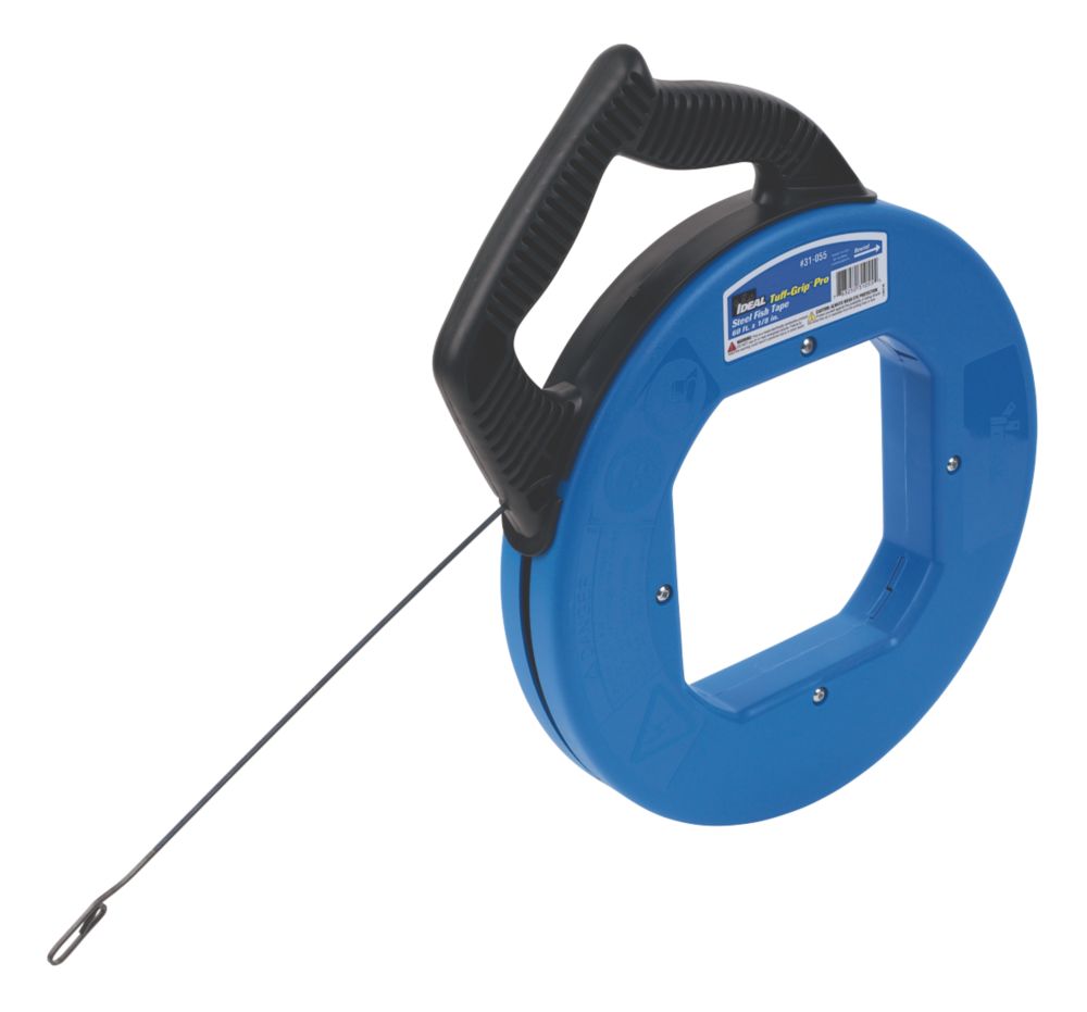

For fishing cables, this tool is up there amongst my "I could not do my job without it"
77205_P&$prodImageLarge$
