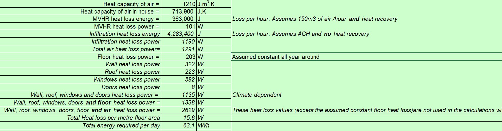

Furnace Posted December 19, 2022 Posted December 19, 2022 I'm hoping to build a passive house next year. Planning application is due to be submitted in the next few weeks. I have a PHPP consultant in the mix working with the architect. In the meantime I've been assessing energy requirements and on the basis that the cheapest energy is the one you don't use, I've spent some time in learning where it appears to be worth spending time, money and energy. I started with Jeremy Harris' spreadsheet to understand the orders of magnitude of the heat losses. Many people have different ways of wanting to look at data and I'm no different, so I wanted to break the losses into discrete areas: Walls Windows Doors Roofs Air via the MVHR Air via infiltration (leakiness) Jeremy's spreadsheet appeared to address air energy losses, but based on an ACH and MVHR efficiency. That doesn't seem right to me. I've modified the sheet (attached to this post) so it has 2 sources of air heat loss - one that uses 30m3/h per person and a heat recovery efficiency ratio (MVHR); and another that uses the air tightness ACH factor and no heat recovery (leakiness). Using this approach suggests that the air leakiness losses are about equal to the sum of all losses from roof, walls, windows and doors. If my calcs are correct, it would make sense to focus even greater efforts on air tightness. I understand that Justine Bere's recent build had a blower test result of 0.15 - that makes a big difference to the heat loss - far more than speccing better windows, for example. Does any of that make sense to you folk? Kind regards Mark Drag files here to attach, or choose files... Accepted file types: bmp, svg, jpg, jpeg, gif, tif, pdf, txt, png, odt, mp3, mp4, mov, qt, xls, xlsx, ods, doc, docx Max total size: 5.86 MB Uploaded Files Heat loss calculator.xlsHeat loss calculator.xlsx

ProDave Posted December 19, 2022 Posted December 19, 2022 I found Jeremy's spreadsheet very accurate, far more so that the SAP calculations (with the same input figures) arrived at. I thought the idea was just play with the air change rate. A totally sealed house without mvhr would be 0. Then add the air change rate of the MVHR to see how much is lost through that. Any further refinement beyond that is unlikely to tell you much. At the end of the day, you build it as well and as air tight as you can and if you meet the figures given by the estimate then you can be pretty sure you have not made any mistakes. But all very interesting from an academic point of view.

Furnace Posted December 19, 2022 Author Posted December 19, 2022 On 19/12/2022 at 17:40, ProDave said: I thought the idea was just play with the air change rate. A totally sealed house without mvhr would be 0. Then add the air change rate of the MVHR to see how much is lost through that. Expand I don't know the history of the calcs, but the issue I had was that it only calculated the losses from MVHR (and it used air change rate rather than an amount per occupant). By far the bigger energy loss is from air leakiness since there is no heat recovery. In my example leakiness is 10 times the heat loss of the MVHR. The numbers suggest an uncompromising approach to air tightness is hugely beneficial compared to tweaking a window's U-value Cheers
JohnMo Posted December 19, 2022 Posted December 19, 2022 You've used your 50 pa ach as your infiltration rate, but it's all not. It should about a 1/4 of that. You are basically adding heat loss. I would be careful with your form factor, i.e. you seem to have a big wall/roof area compared to floor area. So the likelihood of meeting passivhaus specs becomes more difficult. As said the spreadsheet as is pretty much spot on. At -9 the daily heat losses is only a couple of kWh out.

Furnace Posted December 19, 2022 Author Posted December 19, 2022 On 19/12/2022 at 18:17, JohnMo said: You've used your 50 pa ach as your infiltration rate, but it's all not. It should about a 1/4 of that. You are basically adding heat loss. Expand Thanks for that. Is the 1/4 factor used to simulate "typical" conditions for infiltration?
ProDave Posted December 19, 2022 Posted December 19, 2022 On 19/12/2022 at 18:13, Furnace said: I don't know the history of the calcs, but the issue I had was that it only calculated the losses from MVHR (and it used air change rate rather than an amount per occupant). By far the bigger energy loss is from air leakiness since there is no heat recovery. In my example leakiness is 10 times the heat loss of the MVHR. The numbers suggest an uncompromising approach to air tightness is hugely beneficial compared to tweaking a window's U-value Cheers Expand Jeremy created the spreadsheet for modelling his own build and then shared it with the forum. Quite a lot of people have used it since. I built my house as well as I could, but only got an official air test right at the end. I was disappointed with the result of 1.4 yet the tester was excited as it was the best he has ever tested. You might think 1.4 would make my heat loss high? Well in practice the heat i put into the house closely matches the results from the spreadsheet. You will only get the "leakage" air loss when it is blowing a gale, and in any event the air is likely to take the easy route, through the fan assisted mvhr unit and that is certainly how it appears to be. If you built the house with just trickle vents or other leaks, you can never say for certain what the air change rate is as it will depend a lot on where the leaks are, and how strong and even which way the wind is blowing. The lesson is do the best you can for air tightness. Just one of many aspects to detail properly.

Furnace Posted December 19, 2022 Author Posted December 19, 2022 On 19/12/2022 at 18:24, ProDave said: Jeremy created the spreadsheet for modelling his own build and then shared it with the forum. Quite a lot of people have used it since. I built my house as well as I could, but only got an official air test right at the end. I was disappointed with the result of 1.4 yet the tester was excited as it was the best he has ever tested. You might think 1.4 would make my heat loss high? Well in practice the heat i put into the house closely matches the results from the spreadsheet. You will only get the "leakage" air loss when it is blowing a gale, and in any event the air is likely to take the easy route, through the fan assisted mvhr unit and that is certainly how it appears to be. If you built the house with just trickle vents or other leaks, you can never say for certain what the air change rate is as it will depend a lot on where the leaks are, and how strong and even which way the wind is blowing. The lesson is do the best you can for air tightness. Just one of many aspects to detail properly. Expand That's good to know. I was looking at worst case losses, but can certainly see that there are many variables that can influence the leakage. Cheers

TerryE Posted December 20, 2022 Posted December 20, 2022 Some post build improvements try to make a house airtight without bothering with MVHR. Big mistake IMO, as the net result is a stuffy / smelly environment. The V in MVHR is very important for occupants' comfort: having a fresh environment without bleeding heat loss. I did my own version of J's spreadsheet, but the results are very much the same. All of the material losses are the big ticket items and something like the PHPP calculator just adds a huge amount of complexity on immaterial detail IMO. The devil is in the detail, especially in avoiding thermal bridging flaws in design, and quality cockups in construction e.g. insulation missing or badly installed; lack of attention to detail in air-tightness sealing. I am delighted with the overall characteristics of my MBC house: the build is performant by design and in detail of construction: e.g the passive slab with UFH in the slab; the larson strut twin-wall with cellulosic filler; ... the whole build was low energy by design, and in construction detail. MBC has some worthy competitors, and there are other build approaches, so it's very much your choice. However, I would emphasise that you are better off with a construction approach that is low energy by design rather than a convention build with some attempts to tweak it to get this goal as an afterthought. Also having the high thermal capacity internal to the insulated envelope (e.g. the warm slab approach) gives an extremely stable environment. We've just had our 5th anniversary since moving in and overall and we remain delighted at how well our house performs as a lived-in environment and how it has met all of our expectations.

Furnace Posted December 20, 2022 Author Posted December 20, 2022 On 20/12/2022 at 08:46, TerryE said: I did my own version of J's spreadsheet, but the results are very much the same. All of the material losses are the big ticket items and something like the PHPP calculator just adds a huge amount of complexity on immaterial detail IMO. Expand Thanks for that Terry. As far as energy losses are concerned, I also think a pretty simple spreadsheet covers the major contributors without getting into too much detail. The only modification I've made to J's approach is to include the infiltration (leakiness) losses, however these are very dependent on wind speed, direction, orientation on the site so I'm not sure how useful it is. However, addressing leakiness at build time can only help and is very cost effective compared to speccing ultra-low U-value glazing, for example I believe the area where PHPP will help me is in managing overheating risks. I'm inclined to go for certification too, partly to have as a declaration to motivate all those involved in the design and build. I look forward to picking your capacious brain in the future. Cheers
