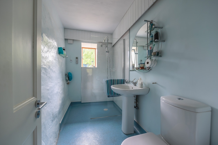

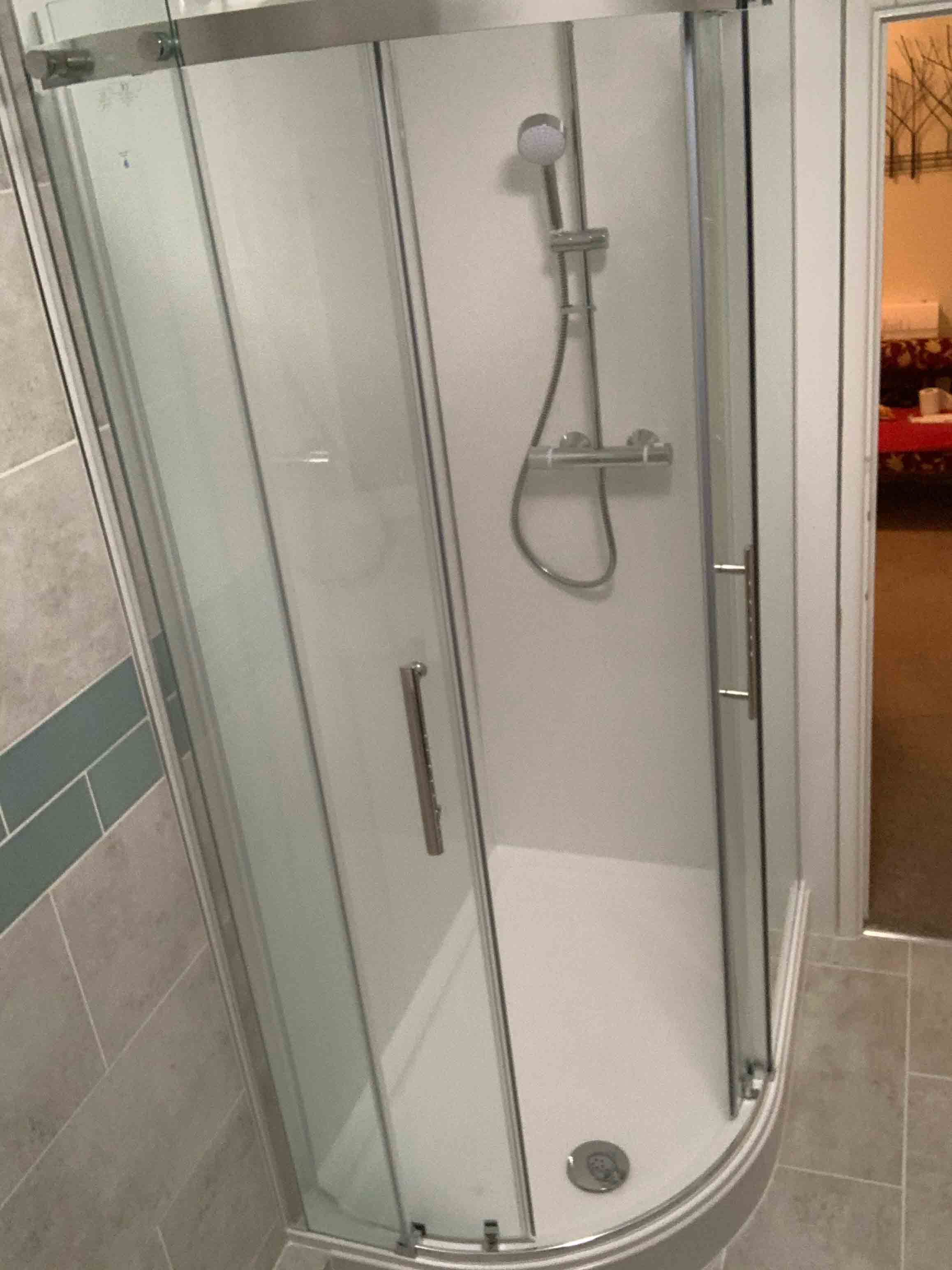

Well I've used Multipanel twice and I like them.
The first one I installed myself and used one of the methods they suggest which is to ovelap the panels with the floor covering but cut the back of the bottom of the panel back at an angle to form a drip. The panel can't sit in water and water shouldn't wick up behind the panel.
The second one was installed by a plumber I chose more or less at random. He did an excellent job but he didn't use the Multipanel sealing kit for the bottom edge which I had supplied, which should do a much better job of sealing the bottom edge than the standard sealer which he used. (This was done during covid and we weren't there much to supervise.)
A lot of the designs are pretty horrible (can't see the point of imitating tiles or stone myself). These are simple white background with small reflective speckles to break the white up a bit.
They are much easier to clean than tiles.
Can't speak for longevity as we left the house with the first one after 7 years, but there was no sign of deterioration. But we don't have 6 showers a day everyday.
