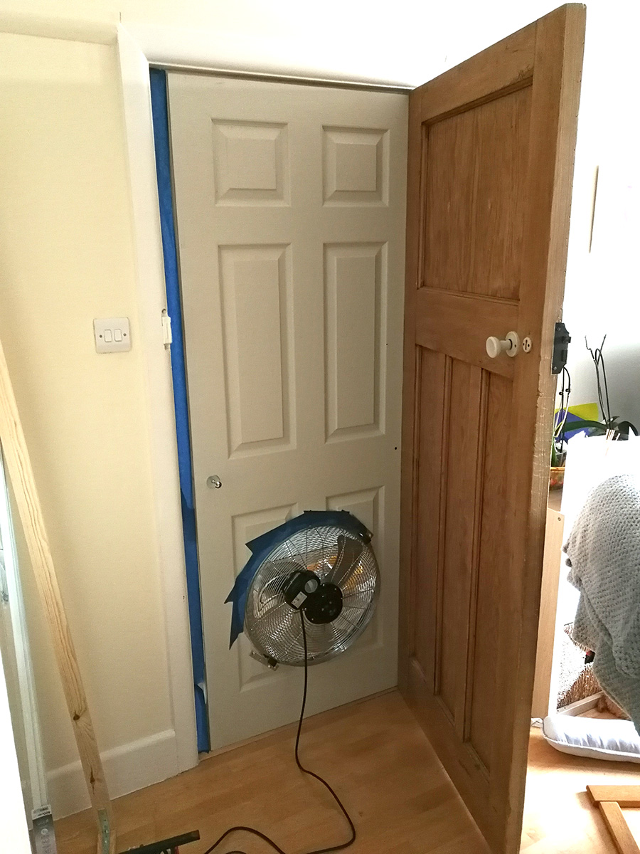

Blower door in action for the first time. I was pleasantly surprised by how airtight the main rooms downstairs were (I sealed the dining room door into the hall, and mounted the blower door into the lounge doorway into the hall). Even on the slowest setting the fan created enough pressure difference to find the major leaks, with the next speed up used for the smaller ones.
Now to start sealing the 40ish leaks we identified!

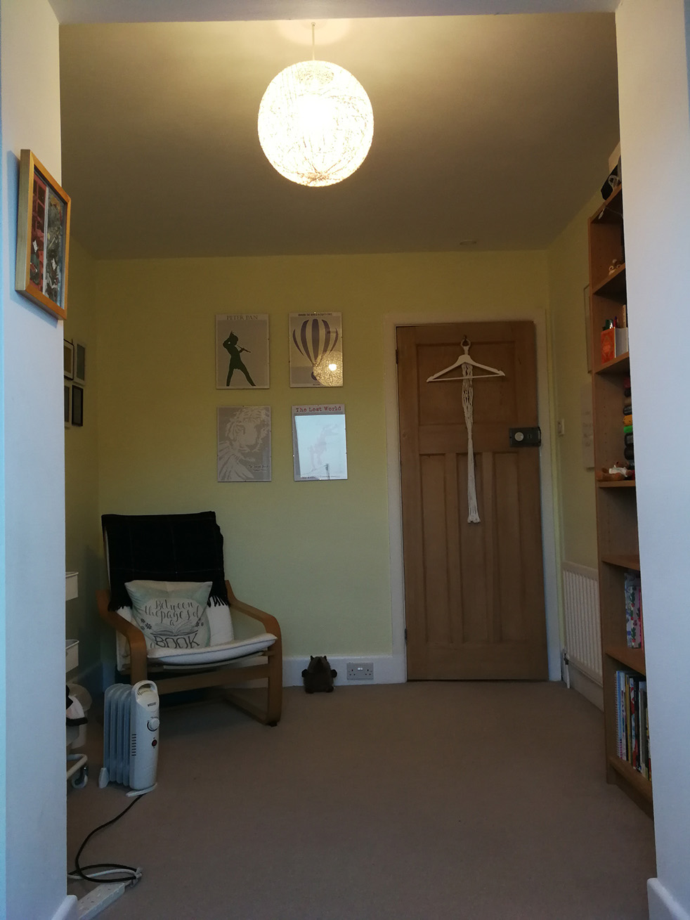

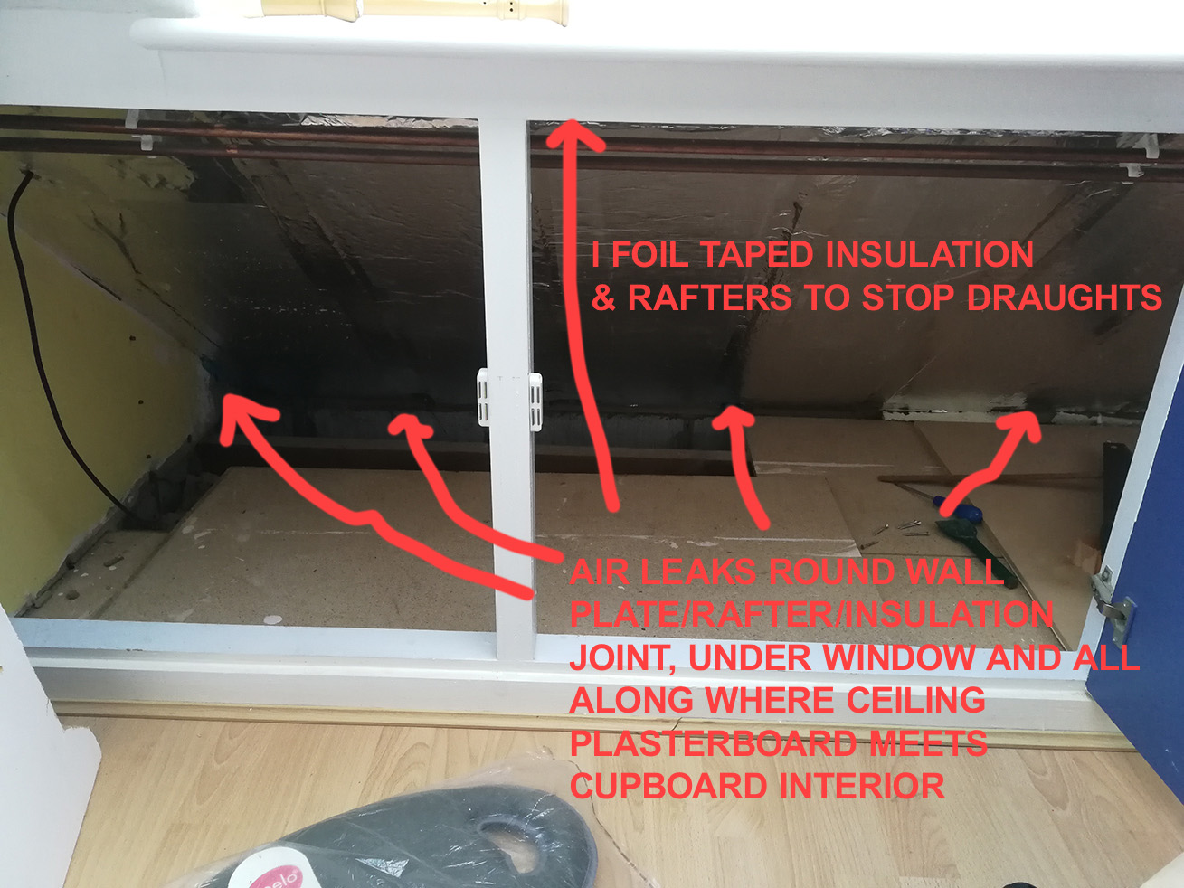

Photos first then replies!

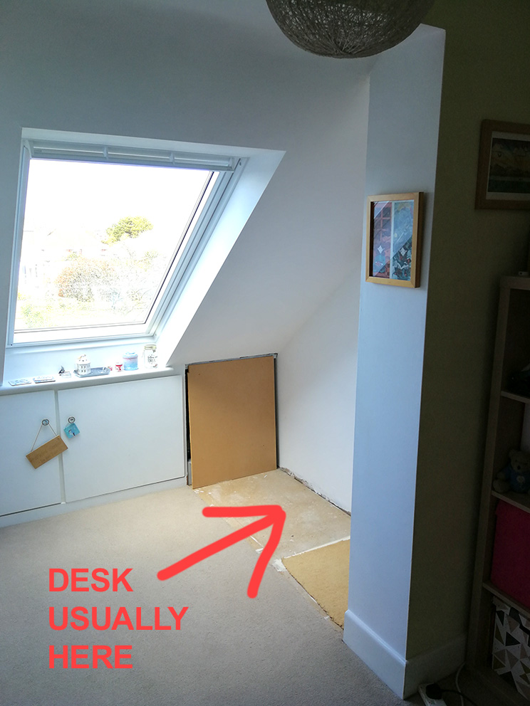

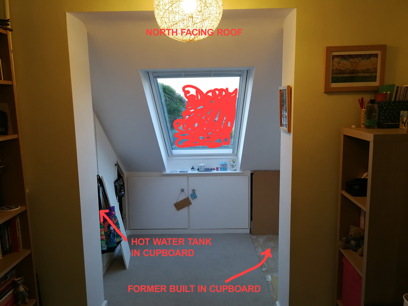

General ones to give a feel for the room. The green painted part is in the 1920s house, the white the 1997 extension.
The piece of loose MDF is where I knocked out a built-in cupboard to make space for the desk and open up the room. I have done a lot of taping in the eaves storage to reduce draughts as it was like a colandar when we moved in. I presume the PIR behind the plasterboard ceiling is just as bad.j-office-cupboard.thumb.jpg.4e650351c07aab63e3912771cfde653d.jpg

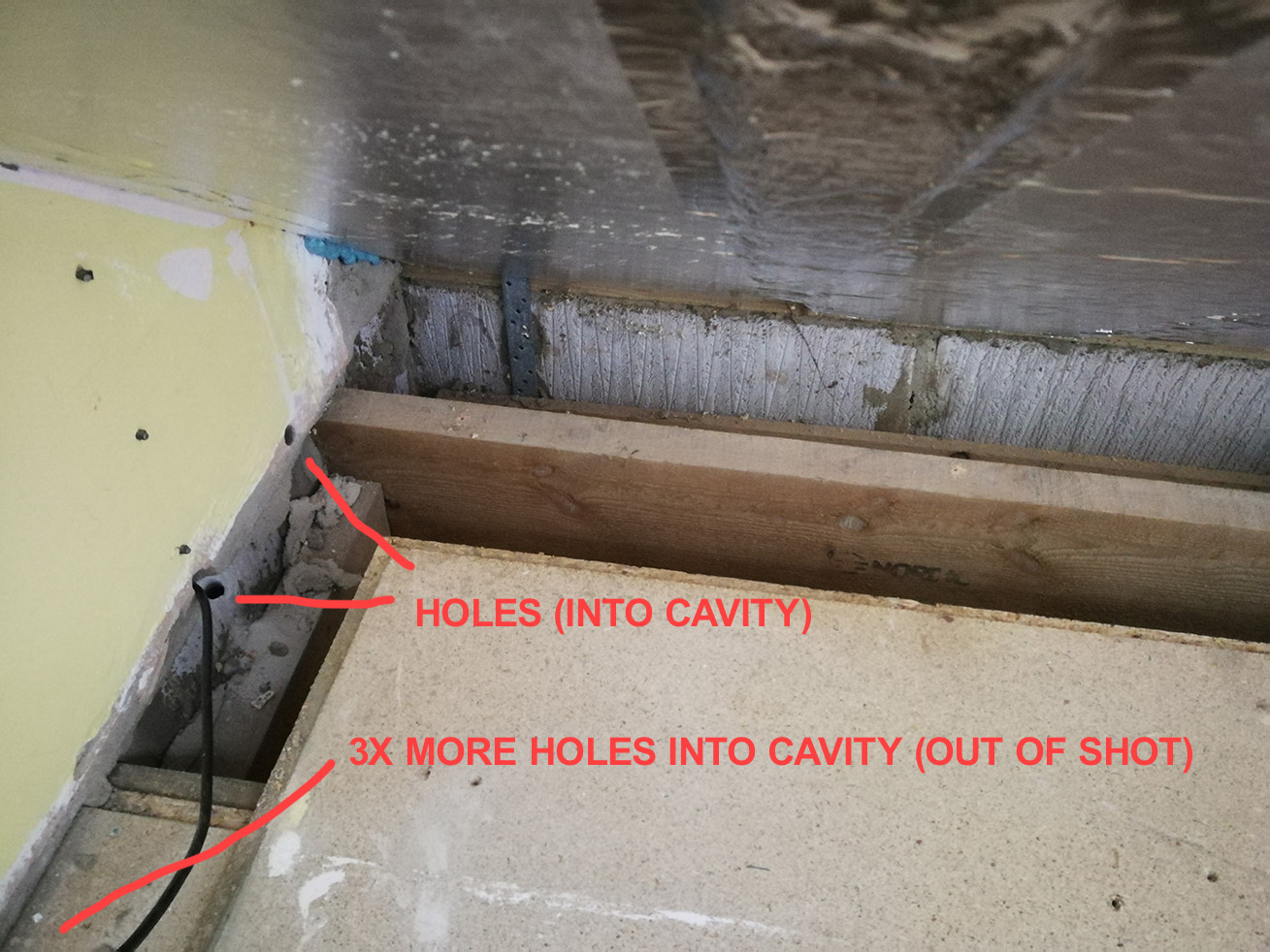

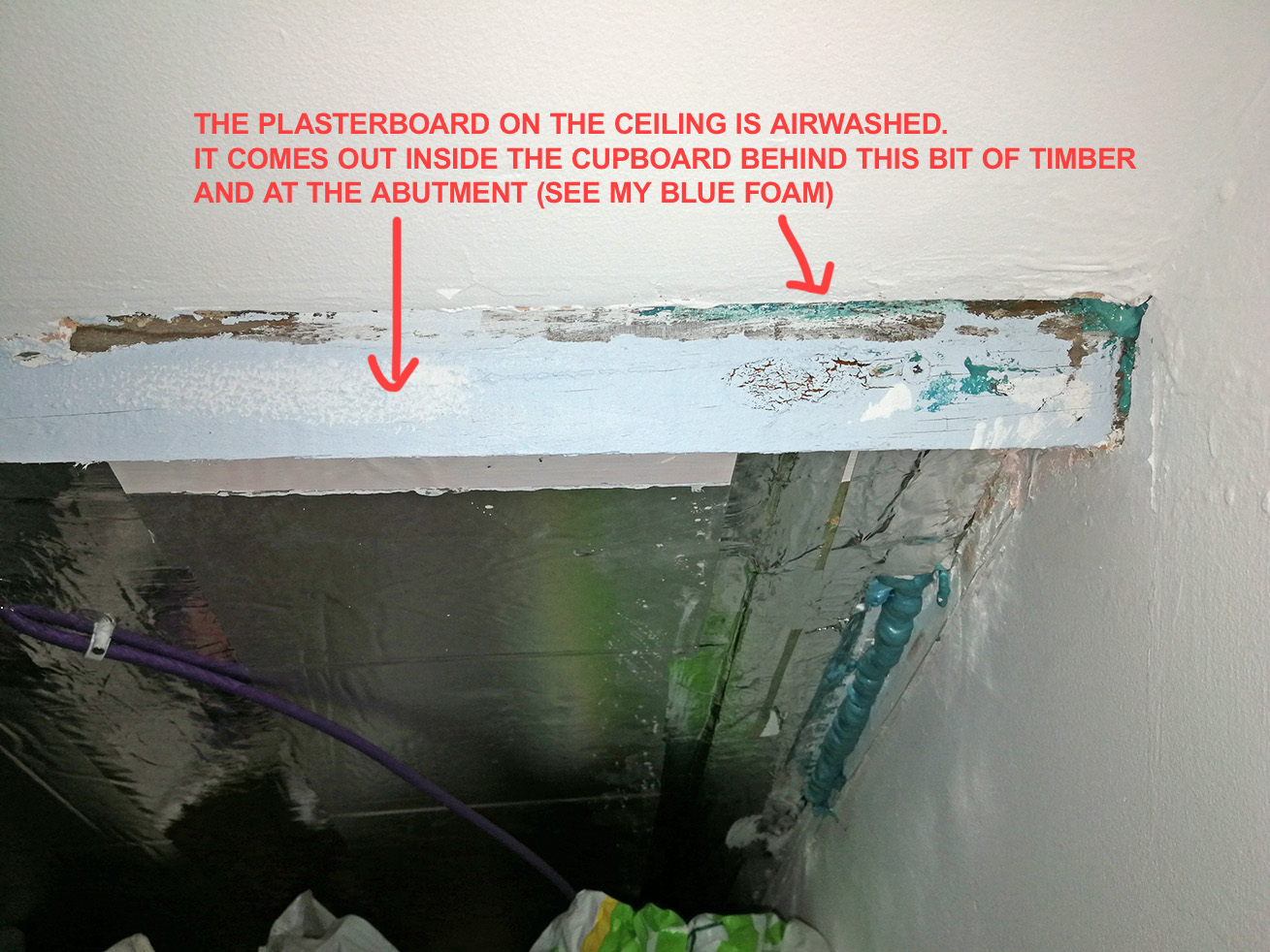

Sealing the draughts at the top of the cupboard - to the windowsill, all along the ceiling edge - has gone poorly. I tried foam with an extension tube, caulk, and most recently Tescon Vana tape. Getting anything tight into the point of a triangle is tricky.

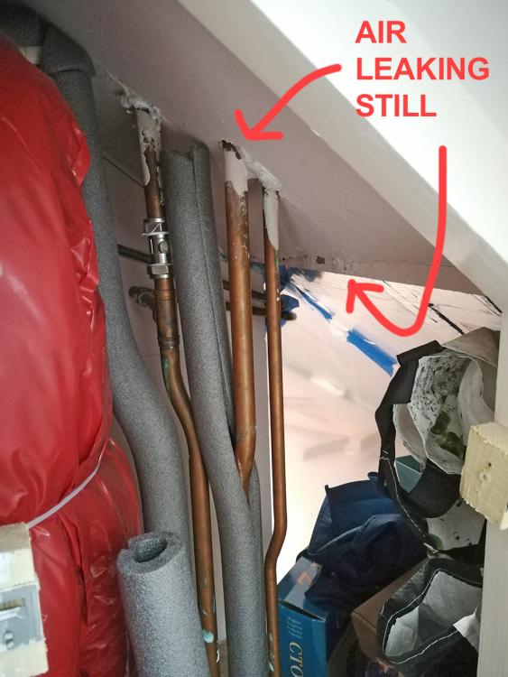

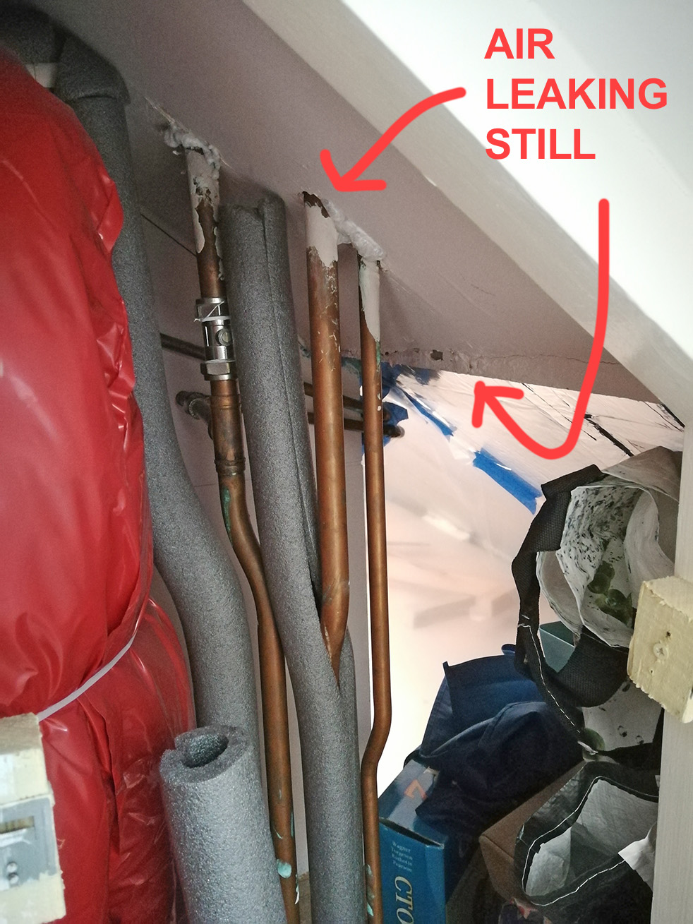

On the opposite side to the bit I knocked out is the hot water tank. Note the pipes that disappear into the ceiling and run up - above the insulation - into the loft. WTF are there 4 of them (3 here, 1 from top of hot water tank) and not just 2?
The neighbouring room has the same construction and eaves storage. I've emptied it to experiment and take up the flooring, and here are photos:

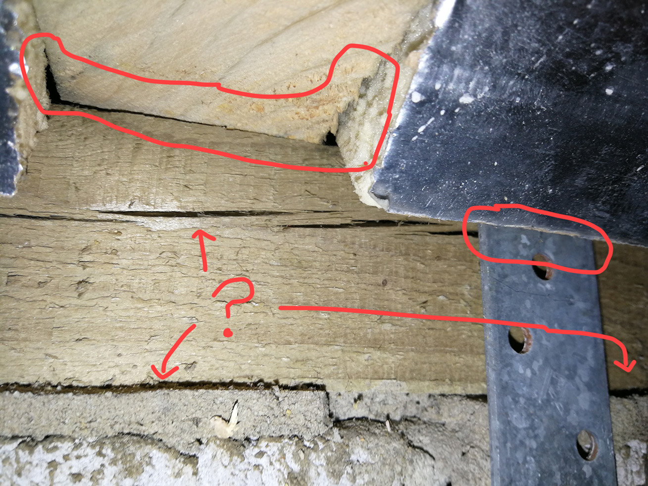

I forgot to annotate that air leaks at the wall straps, because they create a gap around the insulation and it's impossible to seal properly. I'm not clear if I could do better taking out the PIR and replacing it - the wall plate interface is always going to be a weak point with poor contact.
5 hours ago, ProDave said:
Get your blower door on that room and I bet you will find howling cold gales coming in there.
It is draughty but a lot better than when it started! The problem now is that apart from the rafter joist ends (photo below) it's become difficult to track down the rest. Even at the top where the cupboard meets the plasterboard ceiling and there's a cold draught, but none stands out as bad bad. I suspect it's the good old 0.1mm (max) wide gap, but in multiple places and each 2.5m+ long.
Here's a rafter/wall plate photo I left out of the previous post. There's 18 rafters at 30-36cm centres, and some are worse than this one.
The other common detail I often come across is you take a socket or switch off the wall on a windy day and get a cold icy draught coming out of the hole, meaning detailing is poor and cold air is able to get where it should not, and I am talking about switches on internal walls here.  What should be simple tings like sealing cable holes from a cold loft down into an internal stud wall.
Yes I've had those too! Plus we have that where the central heating pipes come up through the floor, even against internal walls. I have to lift some of this floor before the structural engineer visits in 2 weeks so will be interesting to see what's below.

Rafter. I mean rafter ends, not joists

All you are doing is show just how lousy the detail is on MOST houses in the UK.  You could spend a lifetime sealing each and every single hole and there will be as many more left that you can't see / reach.
Most on here will agree it is easy building a house from scratch to get it well insulated and air tight, by correct detailing while you have access and use of membranes, tapes and sealants where appropriate.
What you are showing is the outstanding problem of just how do we significantly improve the older UK housing stock (and in some cases not so old!!) that was built without such care and detail.
I have a friend who has been doing that to an old stone cottage with surprisingly good results, but it has been a LOT of work.  Room by room, over many years, one room at a rime he has stripped it back to a bare shell, all plasterboard off walls and ceilings and all floor boards up.  Then and only then can he seal all the poor detailing, insulate it, and finish off with an air tight membrane before re boarding and re flooring.  I doubt many want to go to those extremes?

Let's say I take down this sloping ceiling and remove the current PIR. How would I make the replacement airtight at the wall plate and at the top where it enters the cold loft? I have found a lack of technical drawings for those two areas.
Could you do it with a Tyvek type material?
It lets moisture out, but reduces air mass flow rate to virtually zero.
