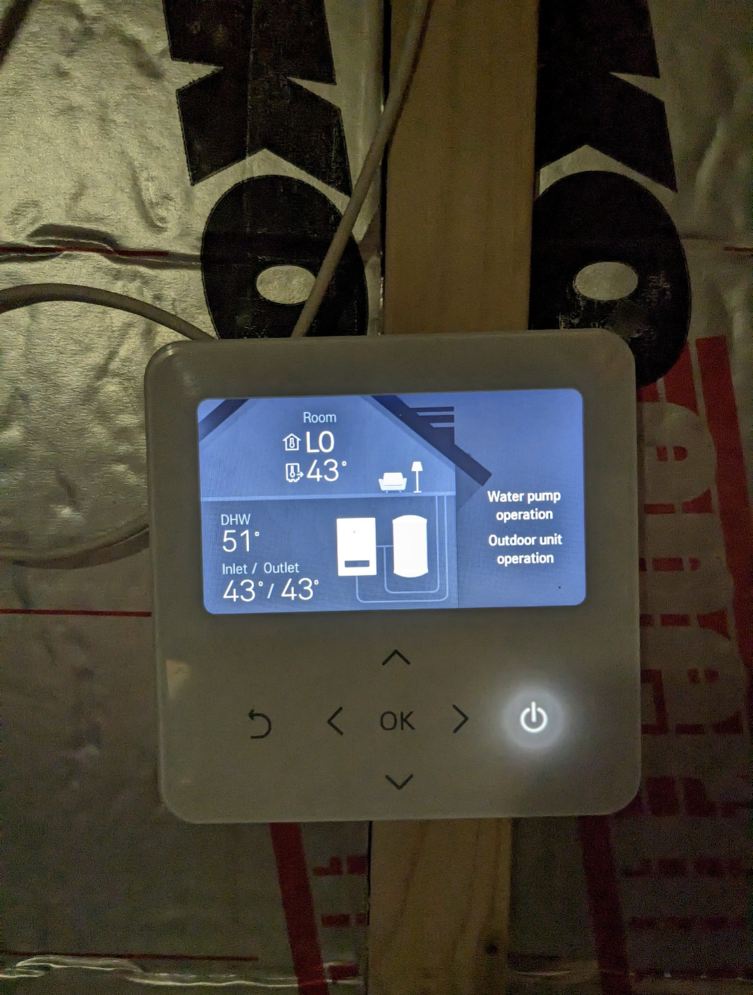

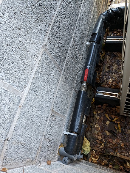

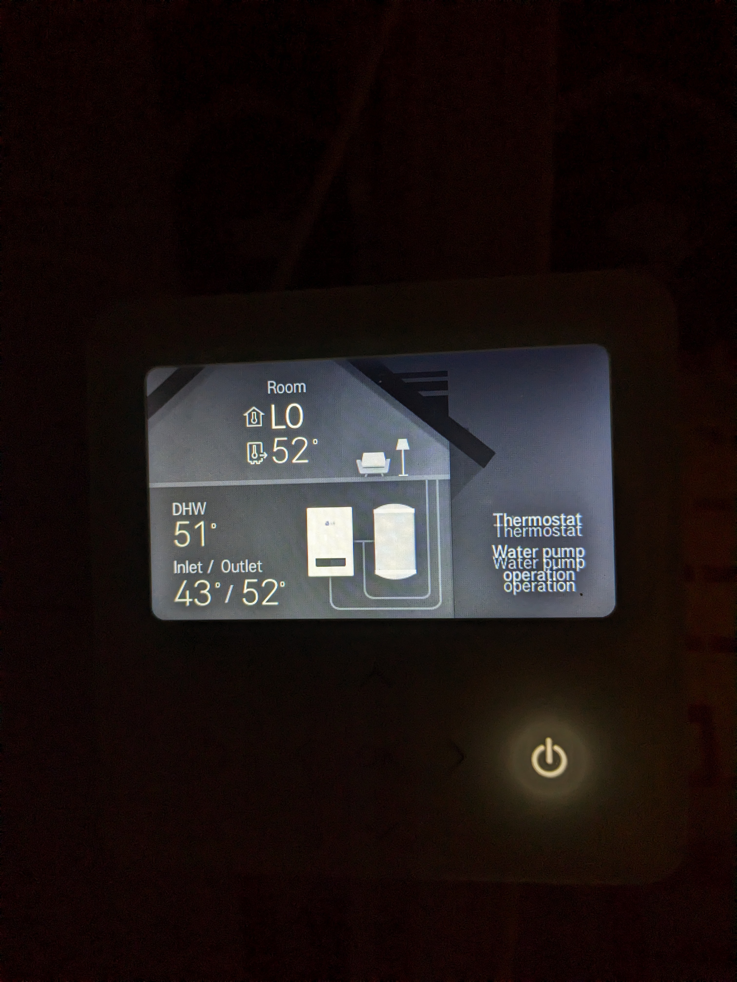

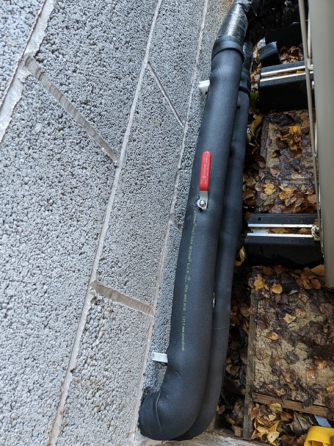

Rupe30 Posted December 16, 2022 Share Posted December 16, 2022 Hi all, Been trying to get to the bottom of why my 16kw lg therma is unable to heat the first floor of my property. We have underfloor heating but only a thin layer of screed (6mm I believe) so the temps need to be fairly high to get any heat into the rooms. I noticed the temperature of the buffer tank displayed on the lg monitor differed considerably from the temp gauge on the maniflow. If I turn the thermostats off and on the lg stat suddenly drops down to the temperature on the manifold. It then starts to heat up to target temp of 55, however before it gets there the same thing happens again, the temp of the buffer gets ahead of the temp on the maniflow, I turn the stats off and on and it drops down to the manifold temp. So it appears the ashp is losing signal to the buffer tank. To add to my confusion earlier today the lg controller was showing buffer tank at 52, but the inlet pipe to the buffer was barely warm. After resetting stats it dropped to 25 degrees on the lg controller. I don't understand where the lg is getting it's temperature reading from and why it thinks the buffer is hotter than it is. It's a 300l buffer. Not sure what other info is useful so let me know! Thanks Link to comment Share on other sites More sharing options...

ReedRichards Posted December 16, 2022 Share Posted December 16, 2022 I don't have UFH, just radiators so I have no direct knowledge of how the controller works with UFH. In my case the top number in the top section is the temperature of the room where the controller is installed, whereas yours says "Lo". And the number before that is the same as the outlet flow temperature, as with you. I think the inlet and outlet temperatures are exactly as they say and are measured within the outdoor unit. My buffer tank has no electrical connections at all so I know it cannot report its temperature. Inlet and outlet temperatures both 43 imply to me that the buffer tank is at 43 C and there is no demand for heat. Sorry, I don't know enough about UFH to offer more advice. Link to comment Share on other sites More sharing options...
Rupe30 Posted December 17, 2022 Author Share Posted December 17, 2022 10 hours ago, ReedRichards said: I don't have UFH, just radiators so I have no direct knowledge of how the controller works with UFH. In my case the top number in the top section is the temperature of the room where the controller is installed, whereas yours says "Lo". And the number before that is the same as the outlet flow temperature, as with you. I think the inlet and outlet temperatures are exactly as they say and are measured within the outdoor unit. My buffer tank has no electrical connections at all so I know it cannot report its temperature. Inlet and outlet temperatures both 43 imply to me that the buffer tank is at 43 C and there is no demand for heat. Sorry, I don't know enough about UFH to offer more advice. The "Lo" is just because the controller is in my cold garage, below 12 degrees it just says lo. What I'm confused at is why the LG Controller was showing 53 outlet temp i.e calling for heat, but the outlet temp was actually 43, which it reverted to when I turned the stat on and off. Link to comment Share on other sites More sharing options...
Rupe30 Posted December 17, 2022 Author Share Posted December 17, 2022 So I've just felt the outlet pipe from the ashp and it's hot, so I think the 53 displaying on the LG controller is correct. The manifold thermostats are both showing 26 degrees. One thing I have noticed is we have a thermostatic mixing valve entering our manifolds which ahould be for high temp heat only. They are open fully, could this be mixing cold in? Link to comment Share on other sites More sharing options...
