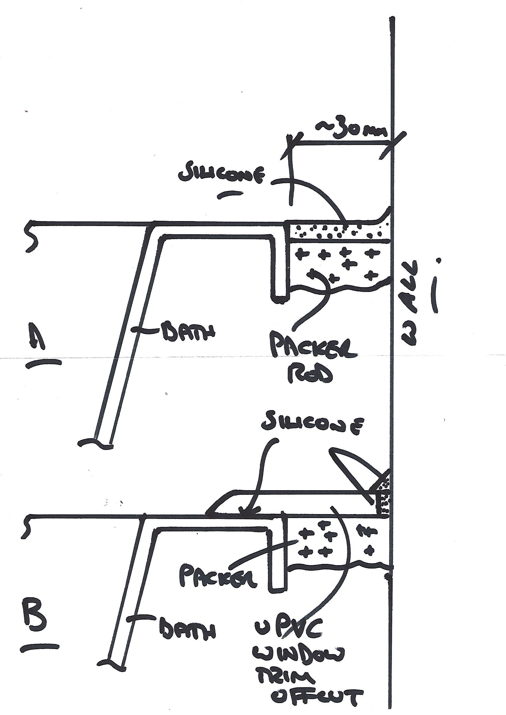

Onoff Posted December 22, 2022 Share Posted December 22, 2022 I see massive, silcone beads on site. Like 50mm wide. Have you got any upvc window trim left over? If so go B) below. The packer rod will help support it whilst it sets. Cut the plastic trim to suit, nice rounded edge towards the bath 1/2 fill the bath with water or more if you're a FC. Fit the packer rod - it'll help support the plastic whilst the silicone sets and stop it from sagging Clean the bath edge and trim with Multisolve Run a line of silicone along the bath edge Run a line of silicone along the back of the plastic trim Push the plastic trim down onto the bath and against the wall Wipe off the excess with a baby wipe. Tbh a Fugi Cramer kit here would help remove most of the excess and cleanly too There is zero need for "soapy water" or a British Standard wet finger. When set run a decent bead against the wall You could use BT1 for both the sticking down and finishing bead. Link to comment Share on other sites More sharing options...
zoothorn Posted December 22, 2022 Author Share Posted December 22, 2022 Hi Onoff, great that helps make it clearer. But this "packer rod" I'm still struggling with. I understand its there to support the trim above now, & solely there for this. But isn't it circular in profile? On your sketch it's a rectangle. This could be possibly: bc the top is to be cut flat, or, bc the the idea is this stuff is to be squeezed into this shape (but if so the top is still circular). Ok. Are we talking the grey foam stuff, circular shaped in diameter, that has a slit one side, used for cladding copper pipe-? If yes, I'll go from here, try to figure out the shape discrepancy. Thanks for sketch! zoot Link to comment Share on other sites More sharing options...
Onoff Posted December 22, 2022 Share Posted December 22, 2022 You can just cut ordinary grey pipe insulation to shape with a box cutter, like I did. Cut it square, triangular, whatever. "Packer rod" is used to give some insulation to a gap as well as stopping you pumping copious amounts of silicone (or foam) into the void behind the gap aka under the bath in your case. In my case I used it to make cavity closers that conformed to the shape of the cavity around the window. Cut in half / pushed in: Foamed over with Illbrück FM330: Cut flush: Link to comment Share on other sites More sharing options...
