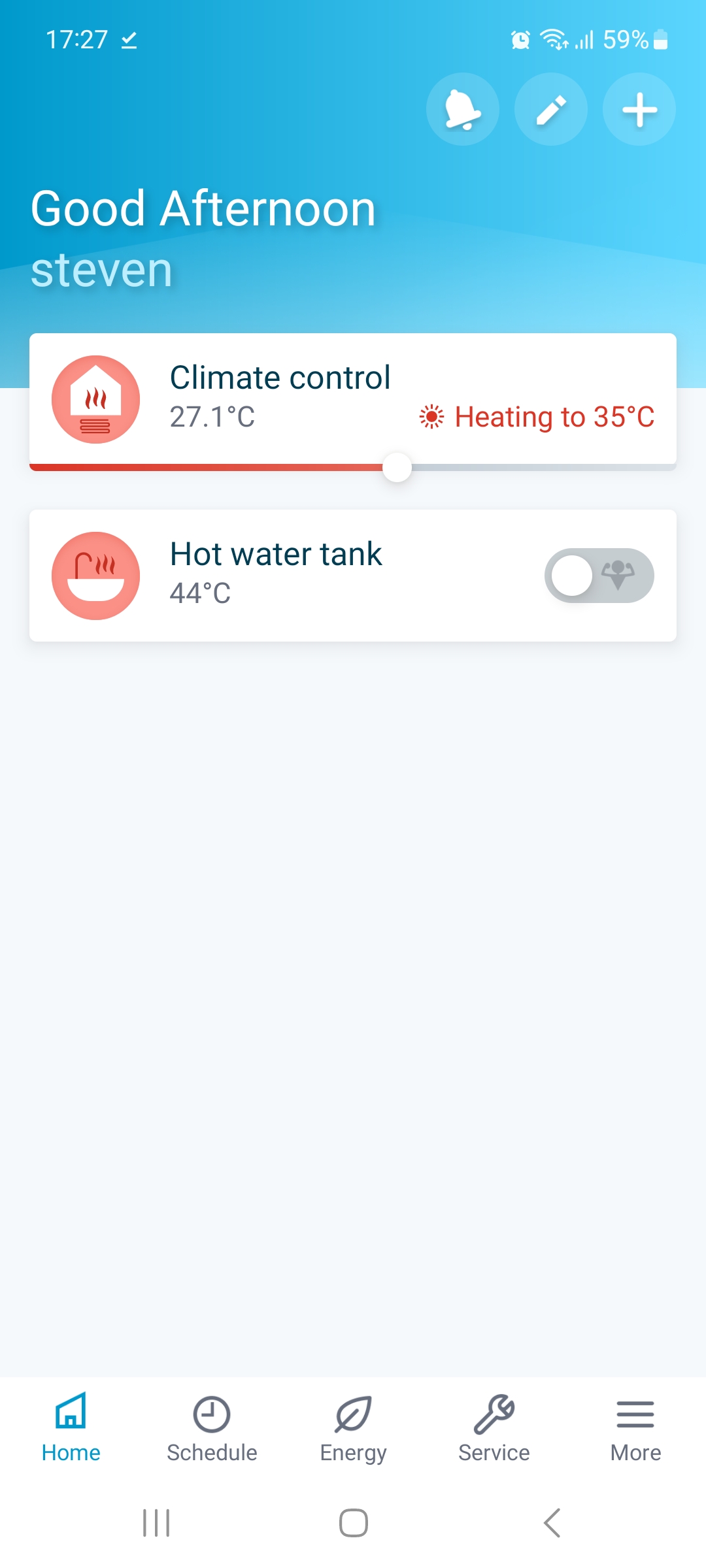

Steve W Posted December 10, 2022 Author Share Posted December 10, 2022 Screenshot from the Daikin App eith LWT SET TO 35C, no demand heat. Not sure why there are two temperatures, climate control 27.1 and heating to 35C. Link to comment Share on other sites More sharing options...

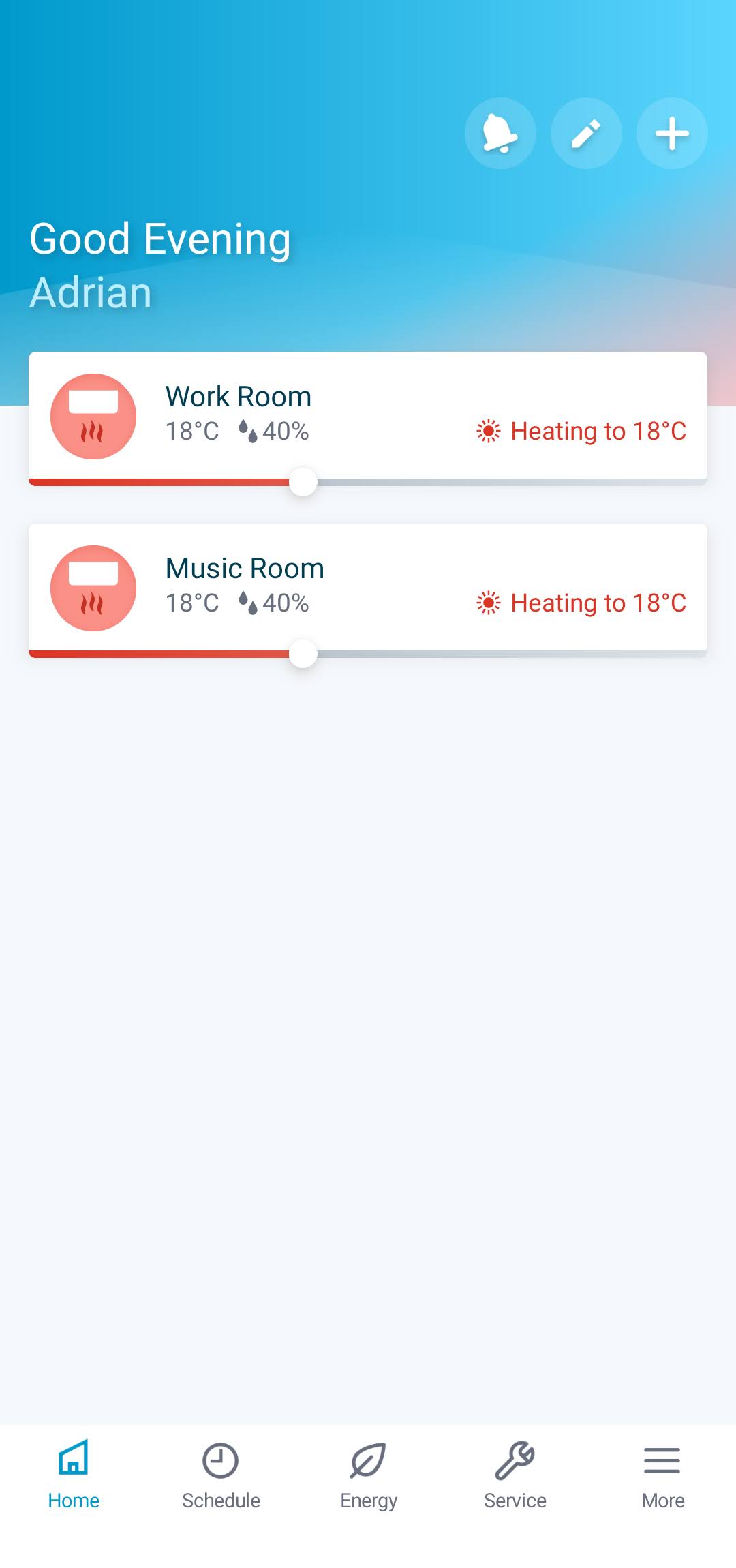

Radian Posted December 10, 2022 Share Posted December 10, 2022 1 hour ago, Steve W said: Not sure why there are two temperatures, climate control 27.1 and heating to 35C. I can only tell you that with my Daikin A/C units the Onecta app shows actual room temperature/humidity and setpoint in those locations: Link to comment Share on other sites More sharing options...

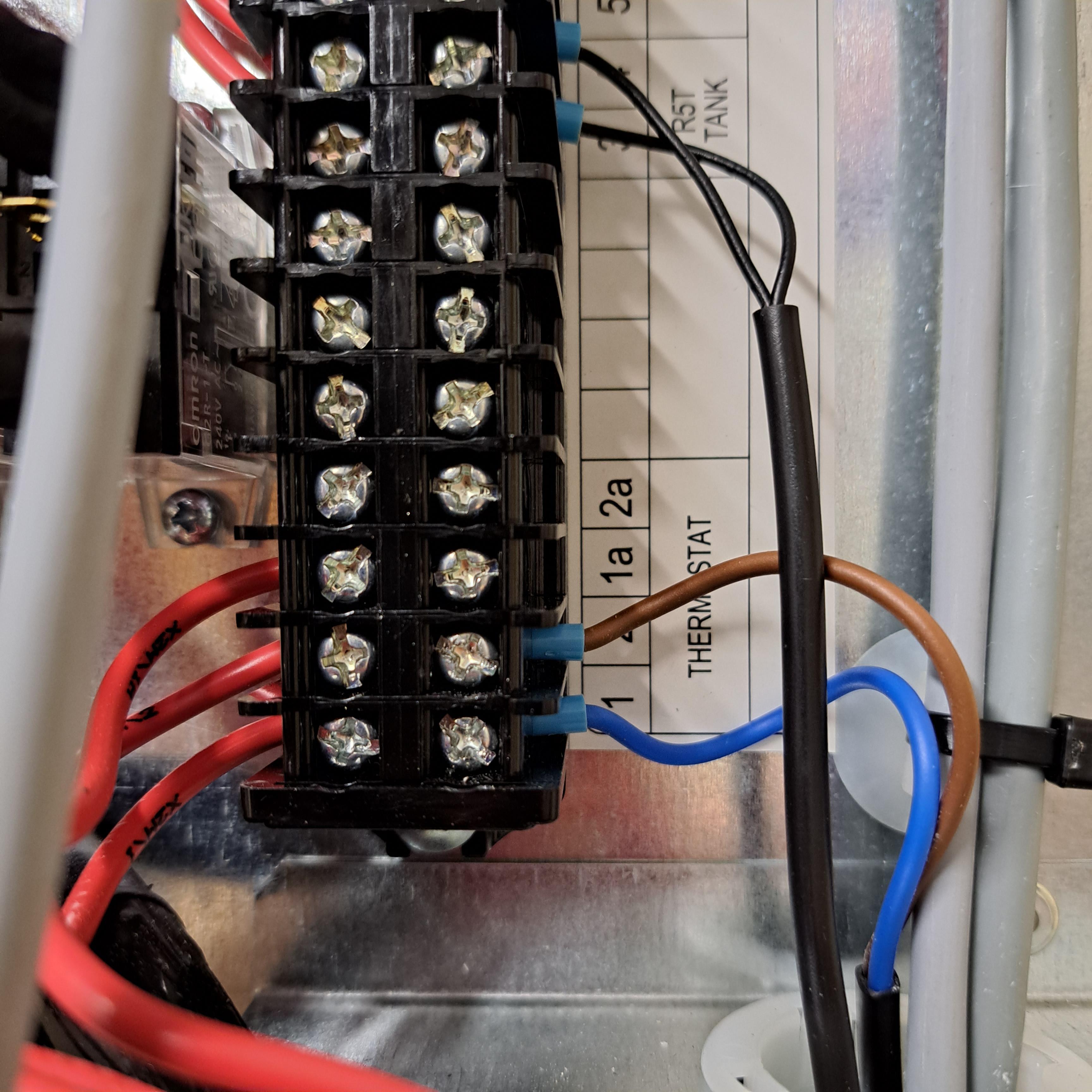

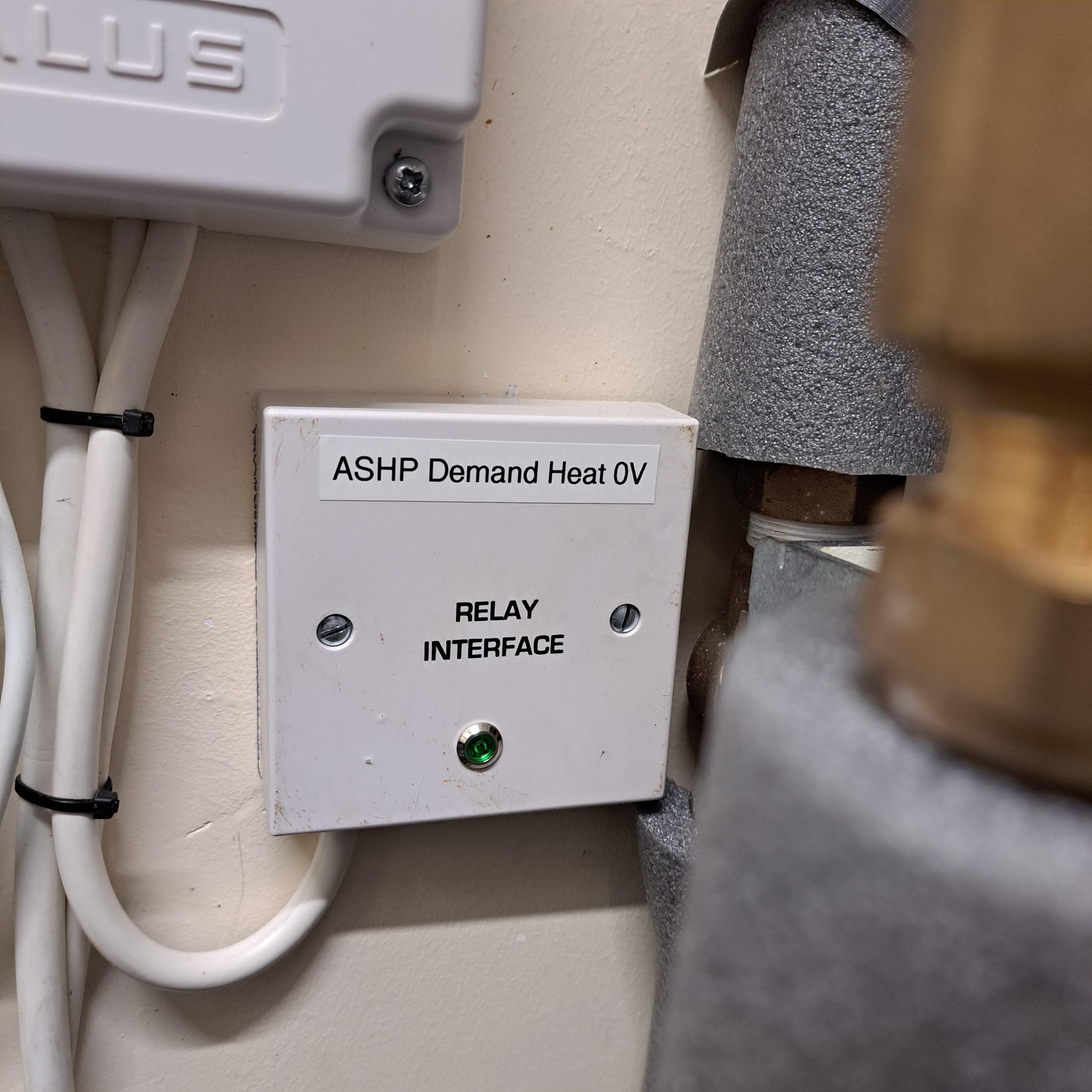

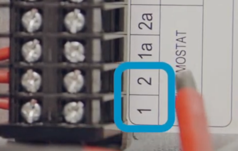

Steve W Posted December 11, 2022 Author Share Posted December 11, 2022 I've attached the wiring diagram from the Daikin installation Guide, the connections inside the controller and the external shot of the 0V relay. There is a green LED that lights when heat is called for. The 0V end has been metered to verify the on/off and that the relay is acutally working. EBLQ05-07CV3-EDLQ04-07CV3_4PEN405544-1D_Installer Reference Guide_English.pdf Link to comment Share on other sites More sharing options...
ProDave Posted December 11, 2022 Share Posted December 11, 2022 The only thing I can pick out from that poor diagram in the manual is that it is expecting terminals 1, 2, and 2a to be used, you only have 2 wires. I wonder if it is expecting a changeover contact rather than an open / close contact? Other than that, if you are SURE the contact is opening and closing (measure the voltage between terminals 1 and 2, relay closed =0V relay open = some higher voltage) then it has to be some setting needed to tell the HP to use the external thermostat. What does the installer say? Link to comment Share on other sites More sharing options...

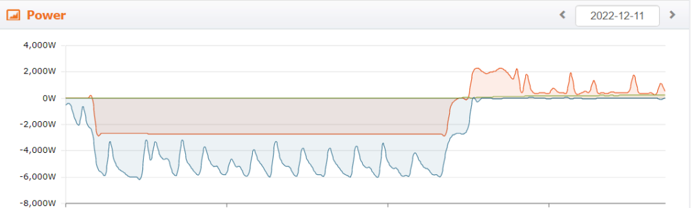

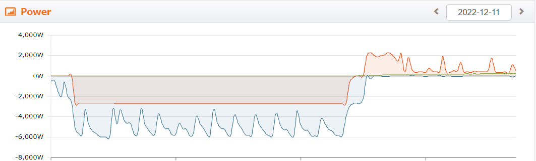

Steve W Posted December 11, 2022 Author Share Posted December 11, 2022 There is also a video on YouTube Connecting a 3rd party thermostat to a Daikin Altherma unit - YouTube (later part) that definitively confirms that it is 1 and 2 and it is volt free. I have checked that the relay is definitely working (more than once). I probably need a warmish day as at the moment the ASHP is running intermittently (without the display showing its running). Left hand side shows the batteries charging pink and the ASHP running in blue. At 7.30 the system swaps over from Economy 7, hence the pink areas above the line. at 8.30 the heating switches off (as expected). There are then a number of peaks (including the toaster), the later ones correspond to the heat pump running up. It may be the intended operation when the weather is cold? Link to comment Share on other sites More sharing options...
ProDave Posted December 11, 2022 Share Posted December 11, 2022 My LG ASHP when it is "off" will periodically start up the water circulation pump as an ante frost measure, to replace the cold water in the ASHP with something less cold. Is this what you are seeing? It typically takes less than a minute to do that. Link to comment Share on other sites More sharing options...
Steve W Posted December 11, 2022 Author Share Posted December 11, 2022 It appears that it periodically heats the water up and runs the pump. If I knock the water temperature down to 15C it doesn't appear to do anything other than circulate the water (I may be wrong but there aren't any significant blips on the power consumption). It also appears to do this regardless of whether it is switched on or not. I will keep an eye on it. Mechanically the unit seems to work well. From a control point of view it is bizarre, for instance you can program different time periods with temperatures but there isn't an off - best you can do is set it to 15C which means the pump runs constantly pushing around 15C water. Link to comment Share on other sites More sharing options...
ProDave Posted December 11, 2022 Share Posted December 11, 2022 It really sounds to me like it is ignoring the remote call for heat input, and when your heating is "off" it still tries to maintain a now very short loop of pipework up to temperature. I keep hoping someone that knows this particular unit will come along and help you check the settings to make sure it really is reading that input. Link to comment Share on other sites More sharing options...
