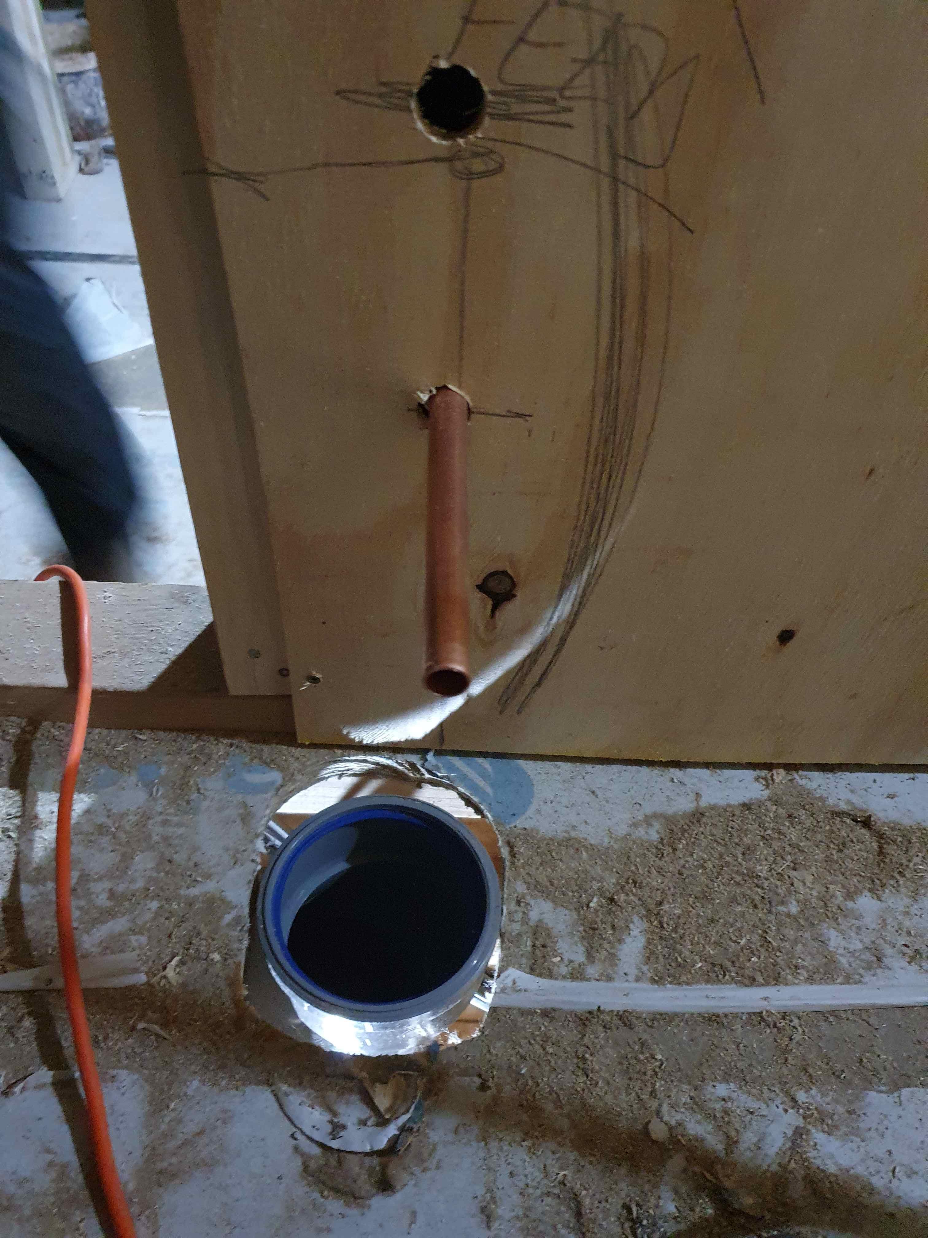

Moonshine Posted December 8, 2022 Share Posted December 8, 2022 This isn't going to work is it (or be a major pain in the arse). Cold water feed for the toilet coming out the wall bang on where the toilet waste is. Link to comment Share on other sites More sharing options...
ProDave Posted December 8, 2022 Share Posted December 8, 2022 Why not? Elbow as close to the wall as you can get it, job done? Link to comment Share on other sites More sharing options...
Redbeard Posted December 8, 2022 Share Posted December 8, 2022 Maybe I am being simplistic or misunderstanding, but if that is a stud wall can you simply not elbow up inside the wall and come out further up? Link to comment Share on other sites More sharing options...

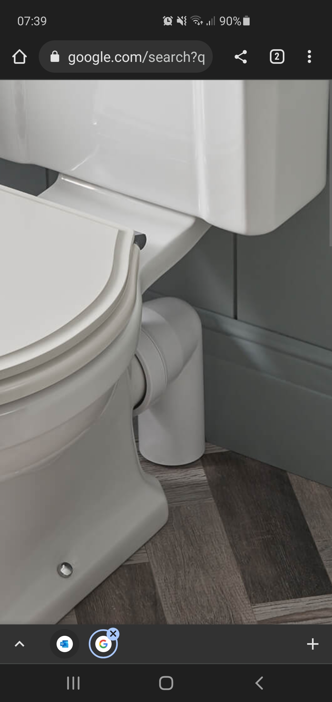

Moonshine Posted December 8, 2022 Author Share Posted December 8, 2022 21 minutes ago, ProDave said: Why not? Elbow as close to the wall as you can get it, job done? I thought that the waste would get in the way.. This is how the plumber has left it, I would have thought that it would be off to the side a little so as not to get in the way of the waste Link to comment Share on other sites More sharing options...
Jenki Posted December 8, 2022 Share Posted December 8, 2022 WC connections are usually 180mm on centre. I think all is ok. and if your paying a plumber, its his issue anyway? Link to comment Share on other sites More sharing options...
Redbeard Posted December 8, 2022 Share Posted December 8, 2022 Maybe I am missing something, but it seems simpler to me than you feel it is. The WC is forward of that spigot, so there is room between the wall and the connection going into that spigot. Would my idea of elbowing within the wall depth not work? That way the 'Cold water feed for the toilet coming out the wall' won't be coming out of the wall until it's where you want it to be. Link to comment Share on other sites More sharing options...
Moonshine Posted December 9, 2022 Author Share Posted December 9, 2022 13 hours ago, Jenki said: WC connections are usually 180mm on centre. I think all is ok. and if your paying a plumber, its his issue anyway? Yeah but if there is a problem its a simple fix for him now rather than a ball ache later. I am imagining this will be the final type of fitment, if so that water feed is coming bang on where the waste is Link to comment Share on other sites More sharing options...
Bonner Posted December 9, 2022 Share Posted December 9, 2022 Have you told the plumber which cistern is being fitted, bottom or side inlet, left or right feed? It looks like he has put it where it can feed any type of cistern and is out of plain sight. Link to comment Share on other sites More sharing options...
Russell griffiths Posted December 9, 2022 Share Posted December 9, 2022 You should have your toilet choice by now and give him a pdf of the installation instructions. Link to comment Share on other sites More sharing options...
