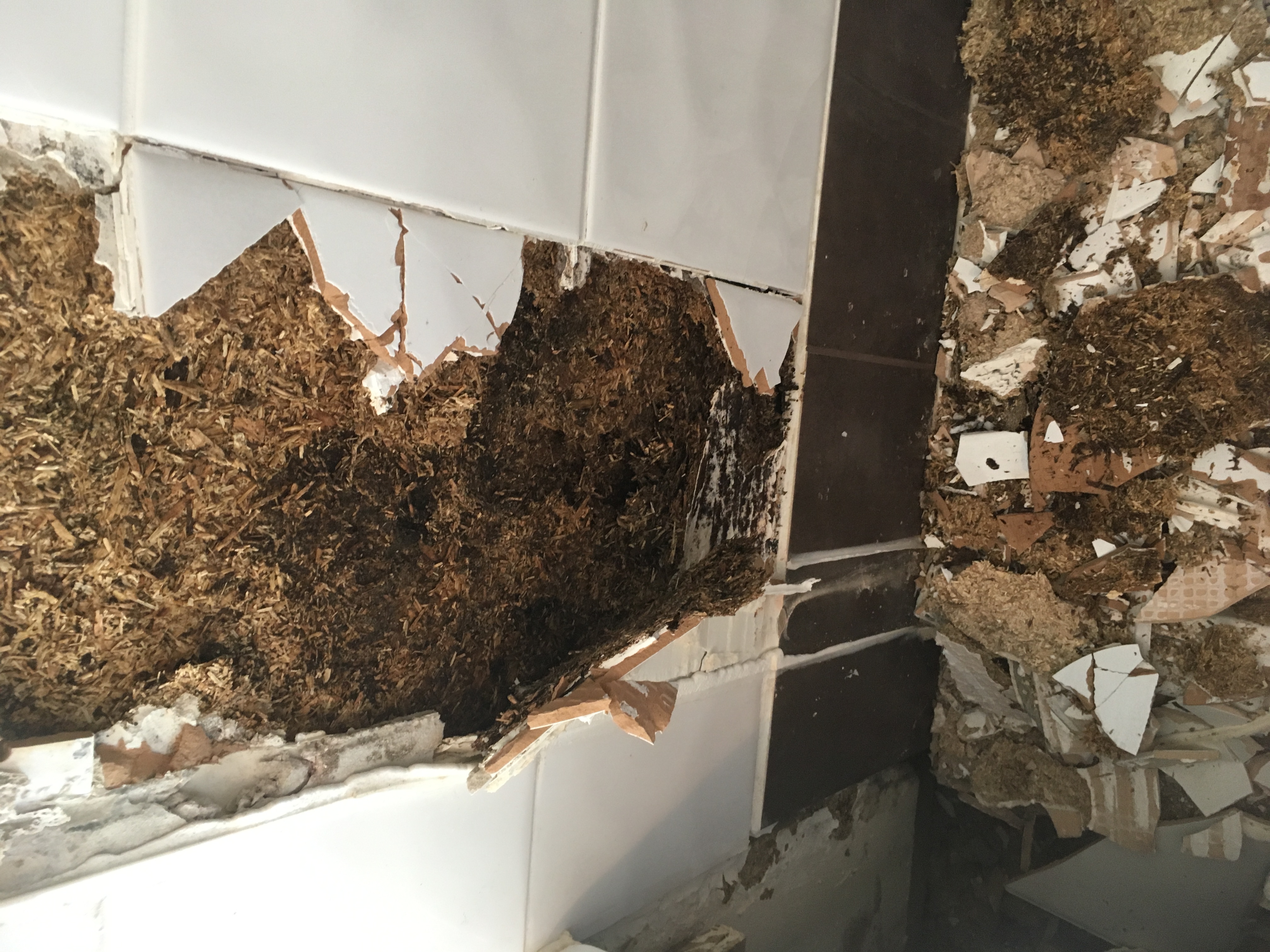

Russell griffiths Posted July 6, 2017 Share Posted July 6, 2017 Just want to do a little survey, would anybody recommend chipboard as a tile backer in a shower enclosure. Link to comment Share on other sites More sharing options...
Nickfromwales Posted July 6, 2017 Share Posted July 6, 2017 Not unless you want them to fall off . You can tile onto ply, but I use cheapo silicone NOT tile adhesive. Why chipboard? ?? Link to comment Share on other sites More sharing options...

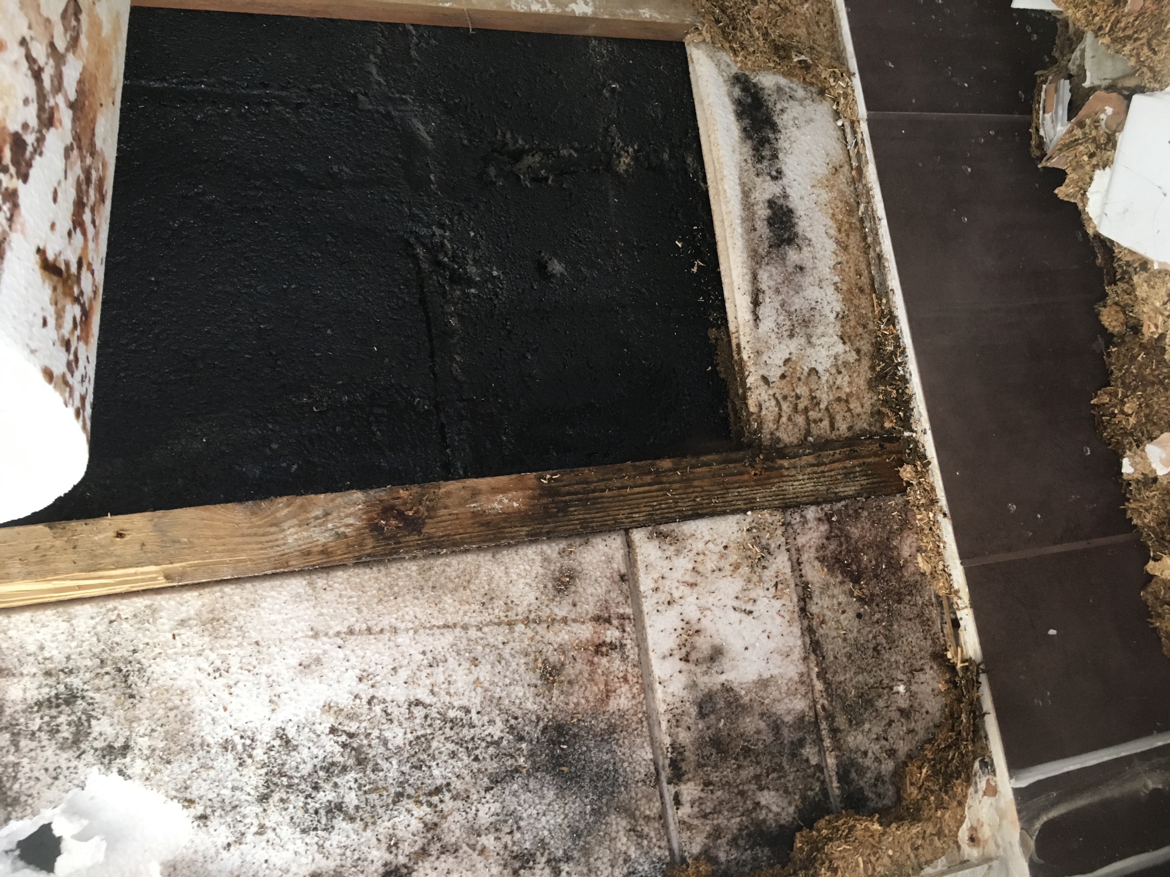

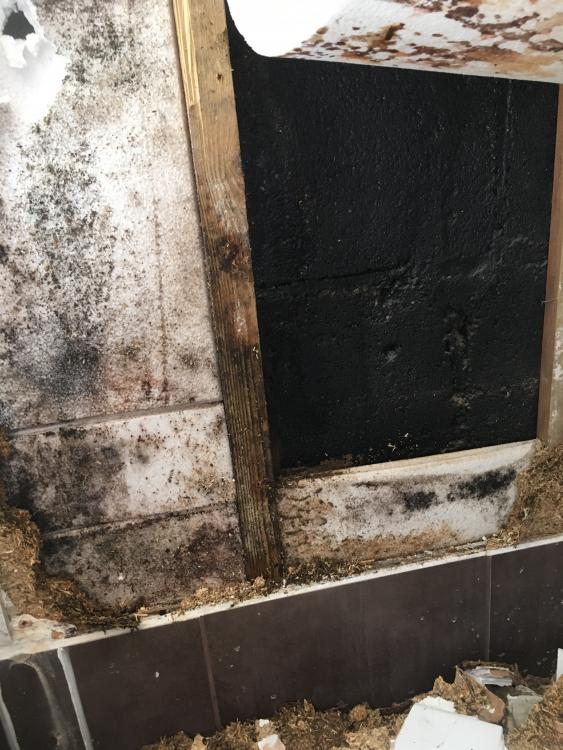

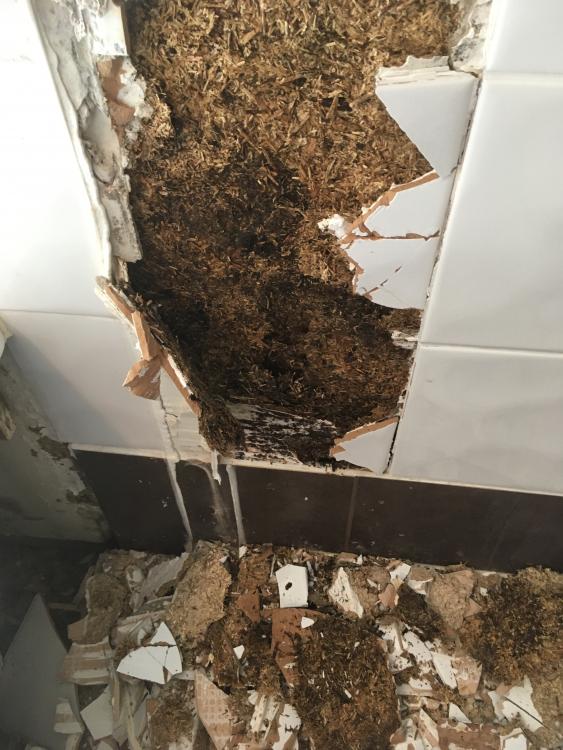

Russell griffiths Posted July 6, 2017 Author Share Posted July 6, 2017 I knew you wouldn't be far away. You want to see what I uncovered today in my house of horrors. Every job I do here confirms the need to knock it down. Pics to follow. Link to comment Share on other sites More sharing options...
PeterW Posted July 6, 2017 Share Posted July 6, 2017 Eeeeuuuwwww..!! Soggy chipboard ...??? Link to comment Share on other sites More sharing options...
Jeremy Harris Posted July 6, 2017 Share Posted July 6, 2017 The first house we bought had a disaster area of a bathroom, where the rough granite walls (it had been an outbuilding) were dry lined with chipboard and then tiled. When I ripped it all out it was a disgusting mess of soggy, rotten chipboard, really manky. Link to comment Share on other sites More sharing options...
Onoff Posted July 6, 2017 Share Posted July 6, 2017 Why not get some Weetabix and tile onto that, might last longer! Seriously, what about V grade "green" chipboard? Link to comment Share on other sites More sharing options...
Russell griffiths Posted July 6, 2017 Author Share Posted July 6, 2017 1 hour ago, JSHarris said: The first house we bought had a disaster area of a bathroom, where the rough granite walls (it had been an outbuilding) were dry lined with chipboard and then tiled. When I ripped it all out it was a disgusting mess of soggy, rotten chipboard, really manky. This is exactly what they have done. Except they have insulated behind the chipboard.............. see my other thread in insulation to see what they used. ?? Link to comment Share on other sites More sharing options...
Nickfromwales Posted July 6, 2017 Share Posted July 6, 2017 2 hours ago, Onoff said: Seriously, what about V grade "green" chipboard? Oi! I ask the stupid questions around here, OK ✊ Link to comment Share on other sites More sharing options...
Russell griffiths Posted July 6, 2017 Author Share Posted July 6, 2017 Yeeea haaaa had a red ants nest behind it that made me reach for the hoover quickly. What a bloody mess. Link to comment Share on other sites More sharing options...
Nickfromwales Posted July 6, 2017 Share Posted July 6, 2017 Stunning ?? Link to comment Share on other sites More sharing options...

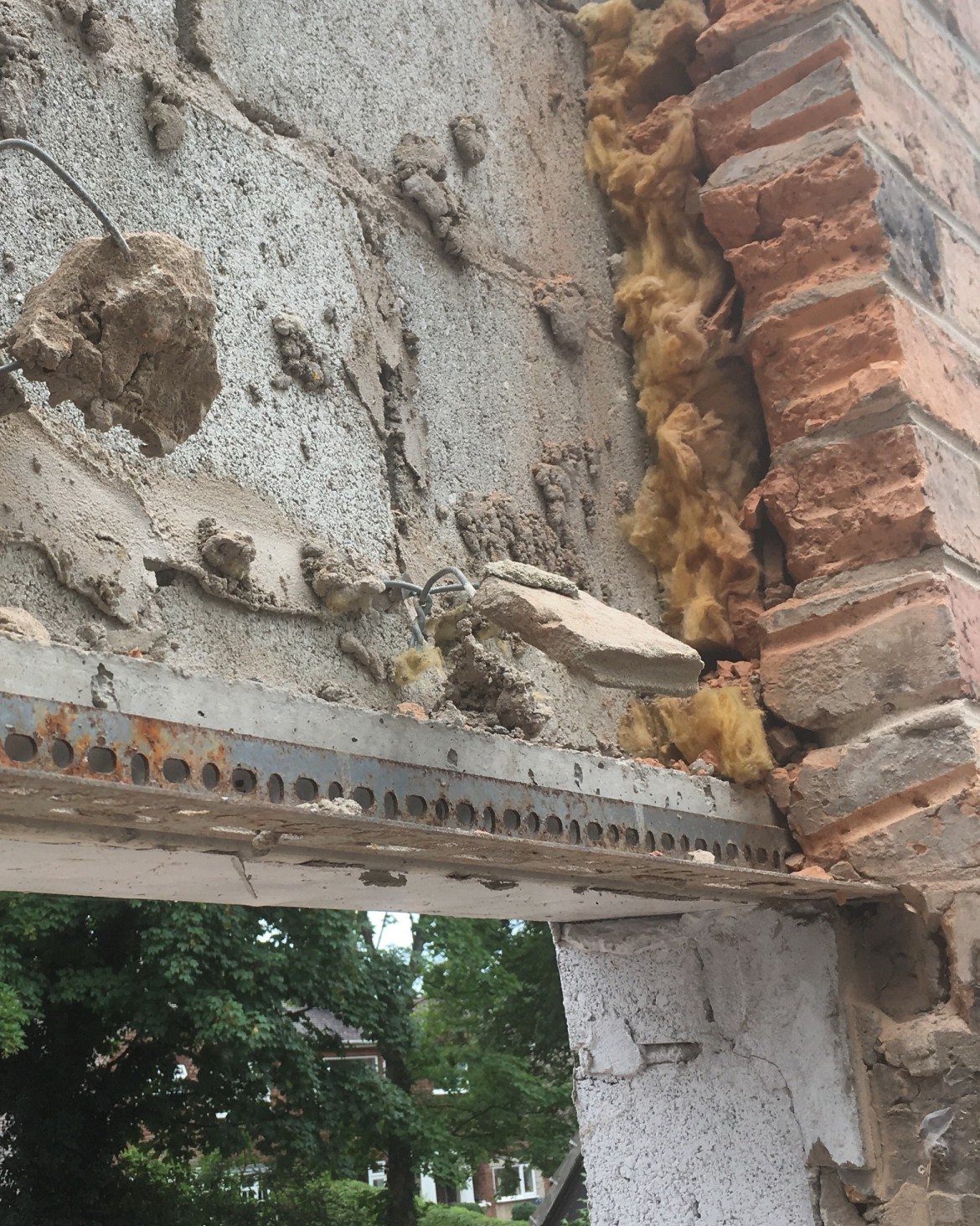

PeterW Posted July 7, 2017 Share Posted July 7, 2017 Bit like the "lintel" I found today holding up the outer skin brickwork ... Link to comment Share on other sites More sharing options...
joe90 Posted July 7, 2017 Share Posted July 7, 2017 Ah, dexion, I remember it well. I used it once to hold a gearbox in a car when converting from auto to manual! 2 Link to comment Share on other sites More sharing options...
Onoff Posted July 7, 2017 Share Posted July 7, 2017 2 minutes ago, joe90 said: Ah, dexion, I remember it well. I used it once to hold a gearbox in a car when converting from auto to manual! I'd have shelved that idea... 2 Link to comment Share on other sites More sharing options...
