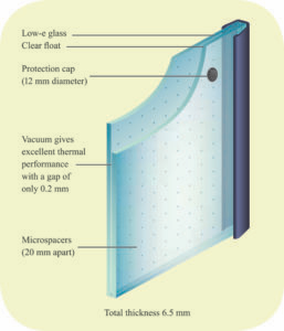

Russdl Posted December 7, 2022 Share Posted December 7, 2022 @anonymous it may be worth looking in to vacuum double glazing, apparently can be as good as triple glazing. Thinner, lighter, no idea of price comparisons though. 1 Link to comment Share on other sites More sharing options...
