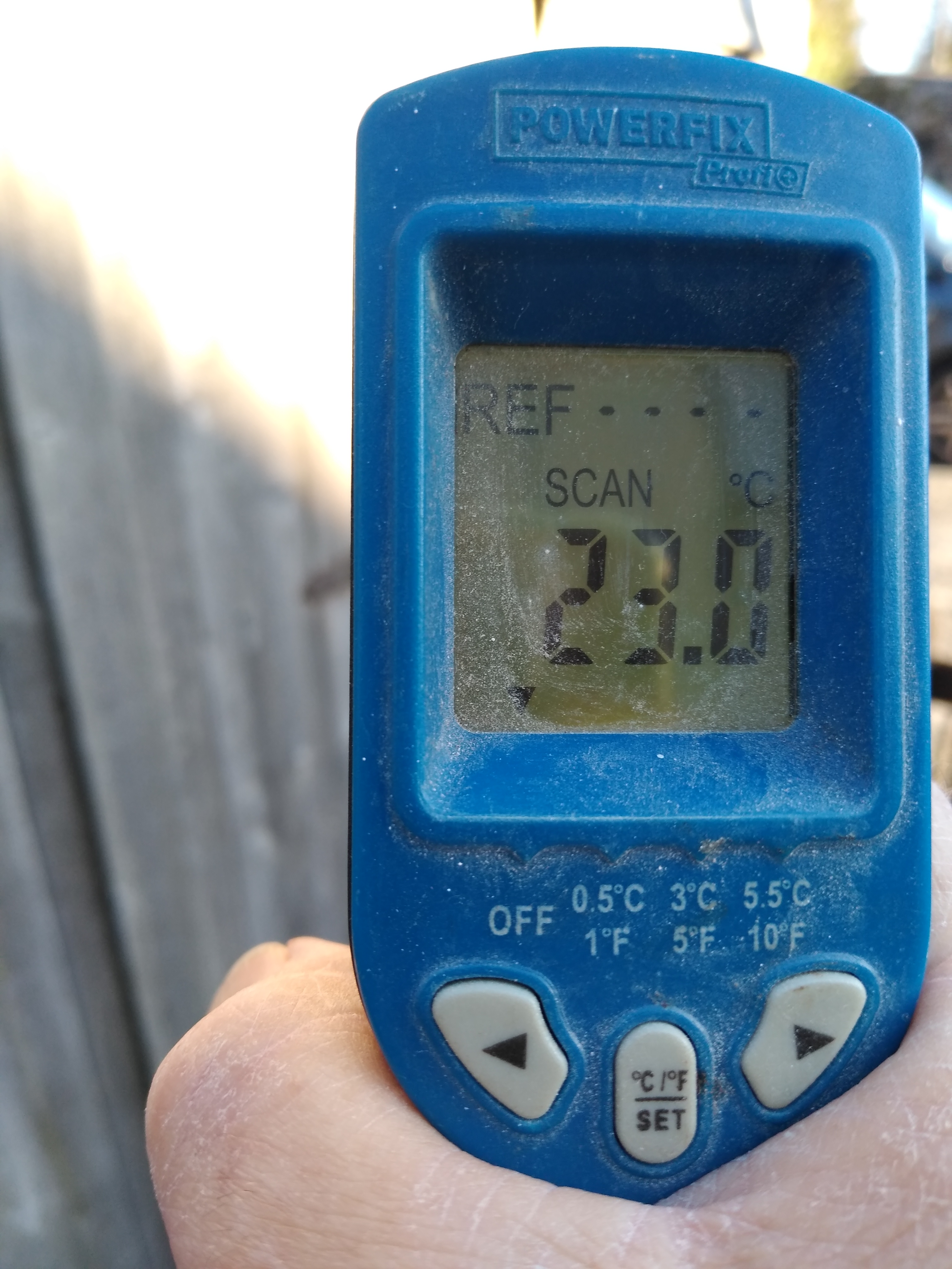

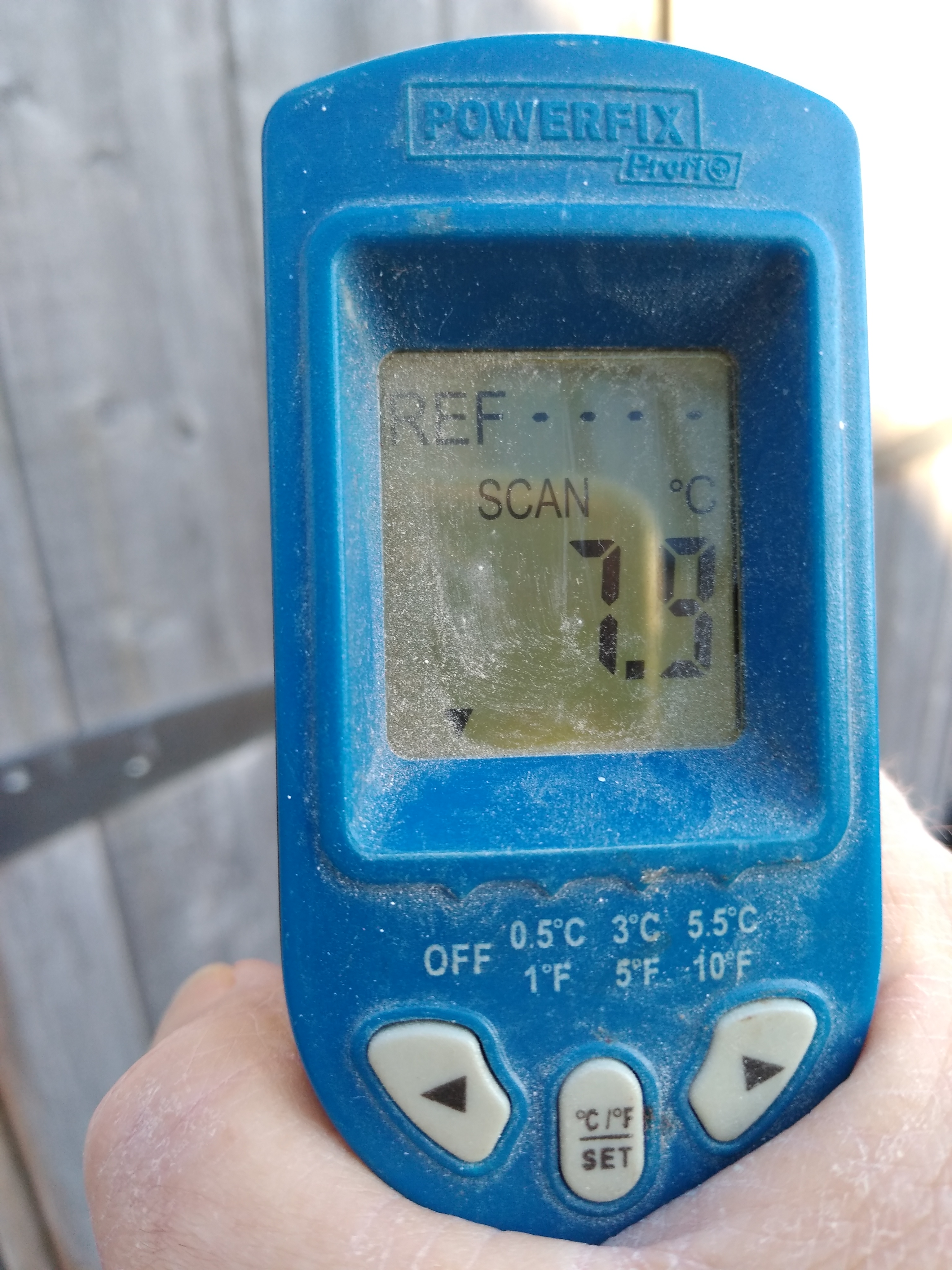

Here is my shed.
Same side, one part in shade  other part in sun.
It is 2⁰C air temperature.
7 minutes ago, SteamyTea said:
Is the shed in the sun?
If it is, it may well go over 10°C, even if the air is colder.
This should not be a problem as the colder, exposed side of the film will still allow evaporation.
Not really. There is a south facing side and an east facing side which would normally be in the sunfor a bit, except that both of those sides have an overhang/oversail roof which projects 60cm to allow for dry space underneath to store wood. The east facing side might get a bit of sun late morning, but not much as it's shaded by my house mostly. The south facing side is shaded by an old shed that we need to empty and get rid of.
I'm more concerned by the other two sides of the fence that don't get any raincover from the roof or any sun.
