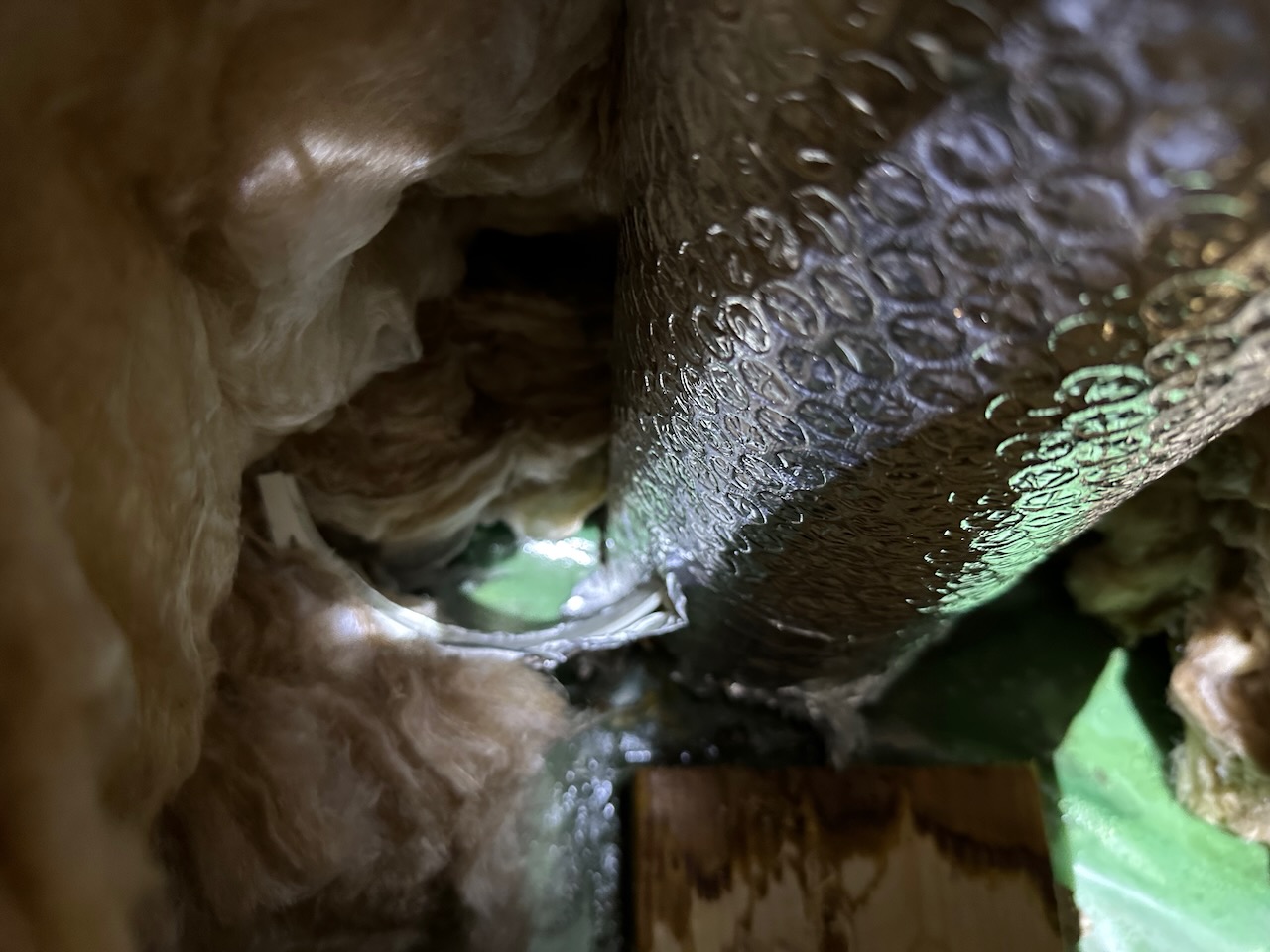

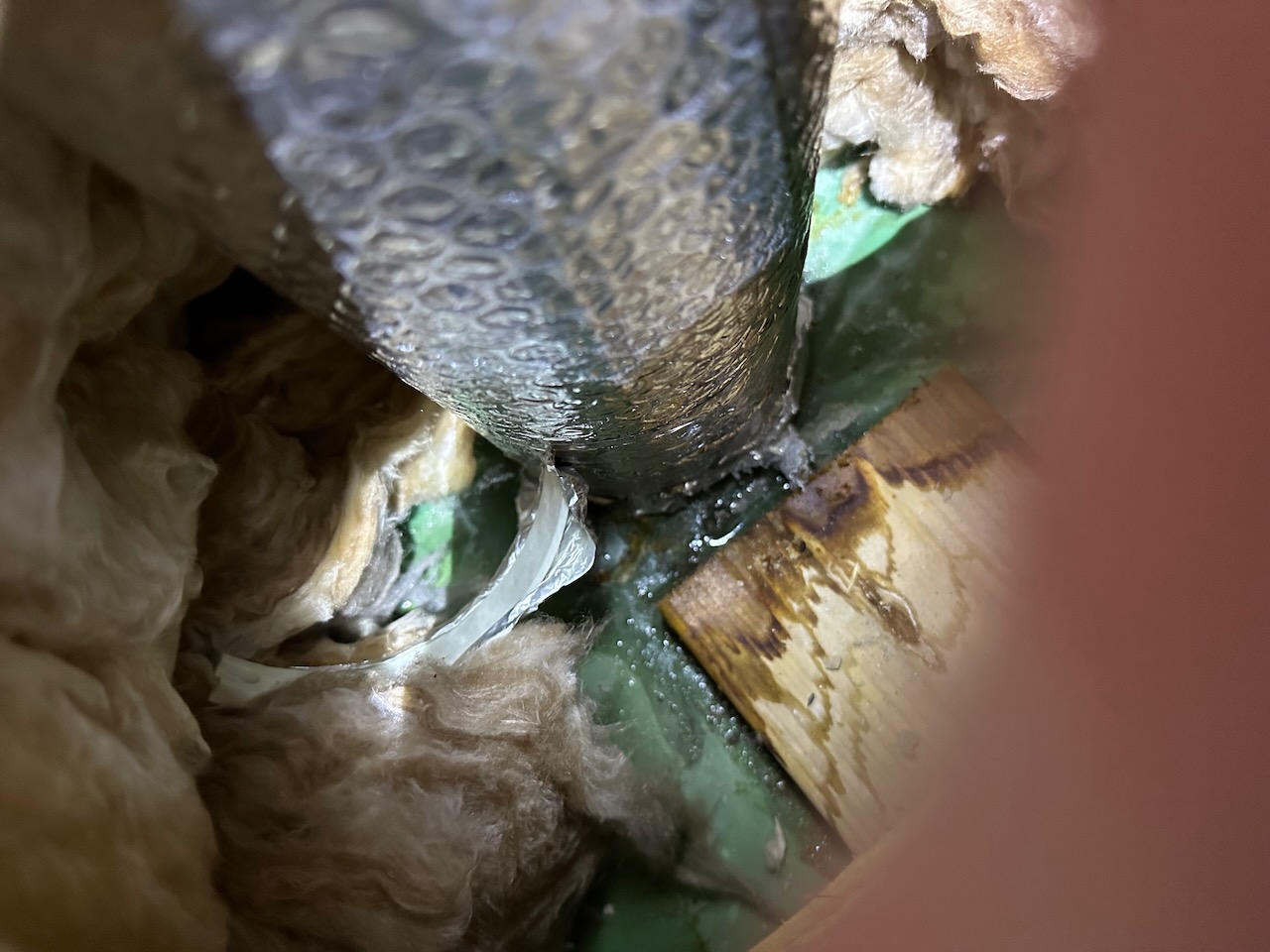

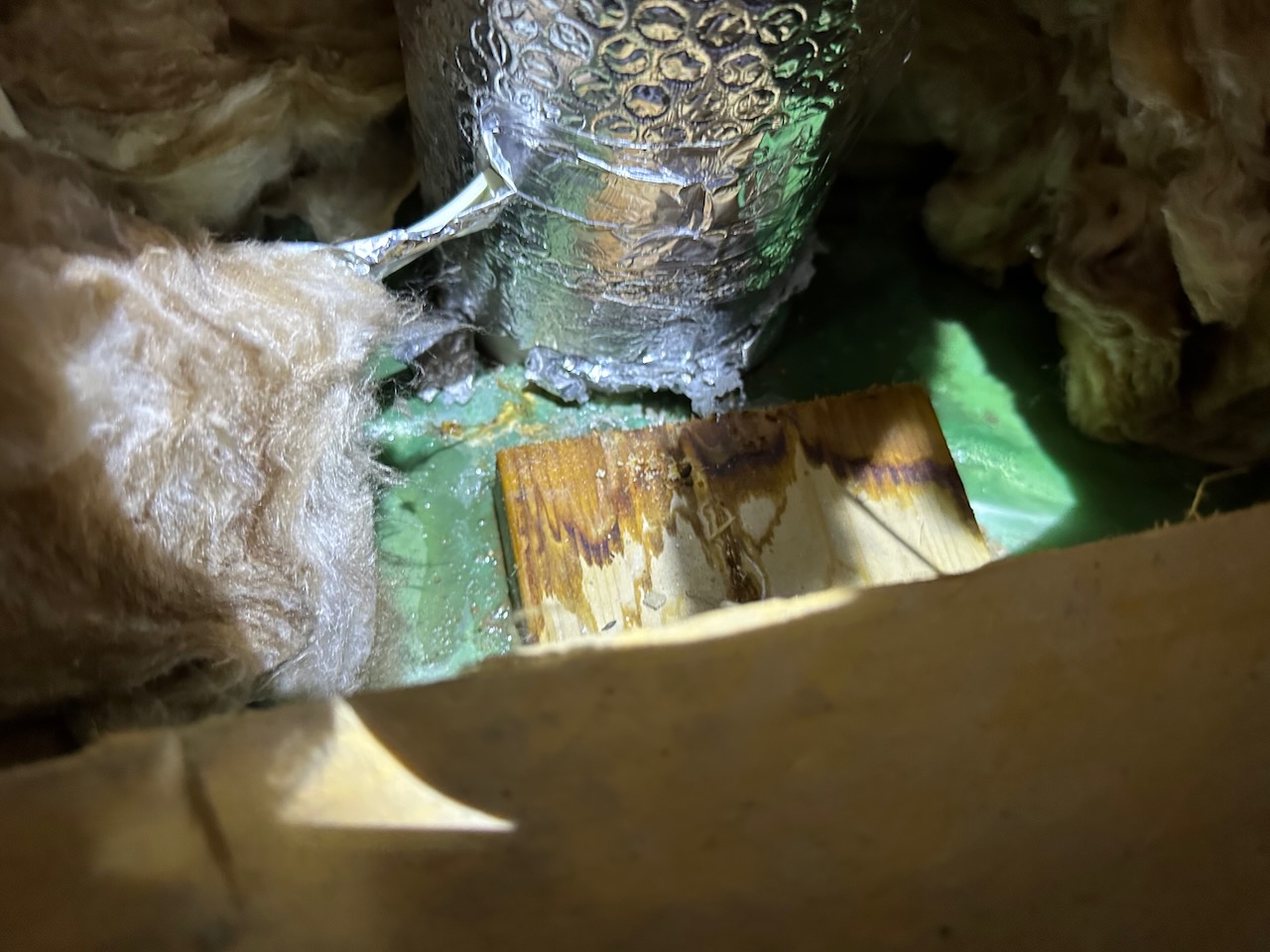

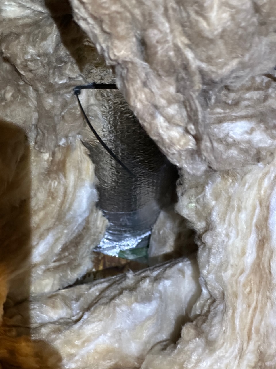

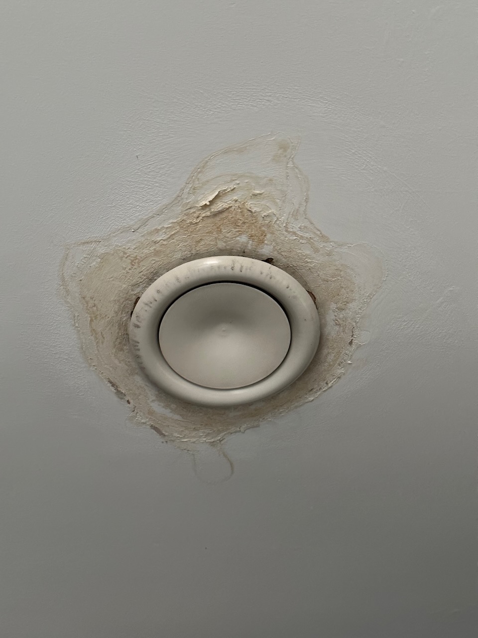

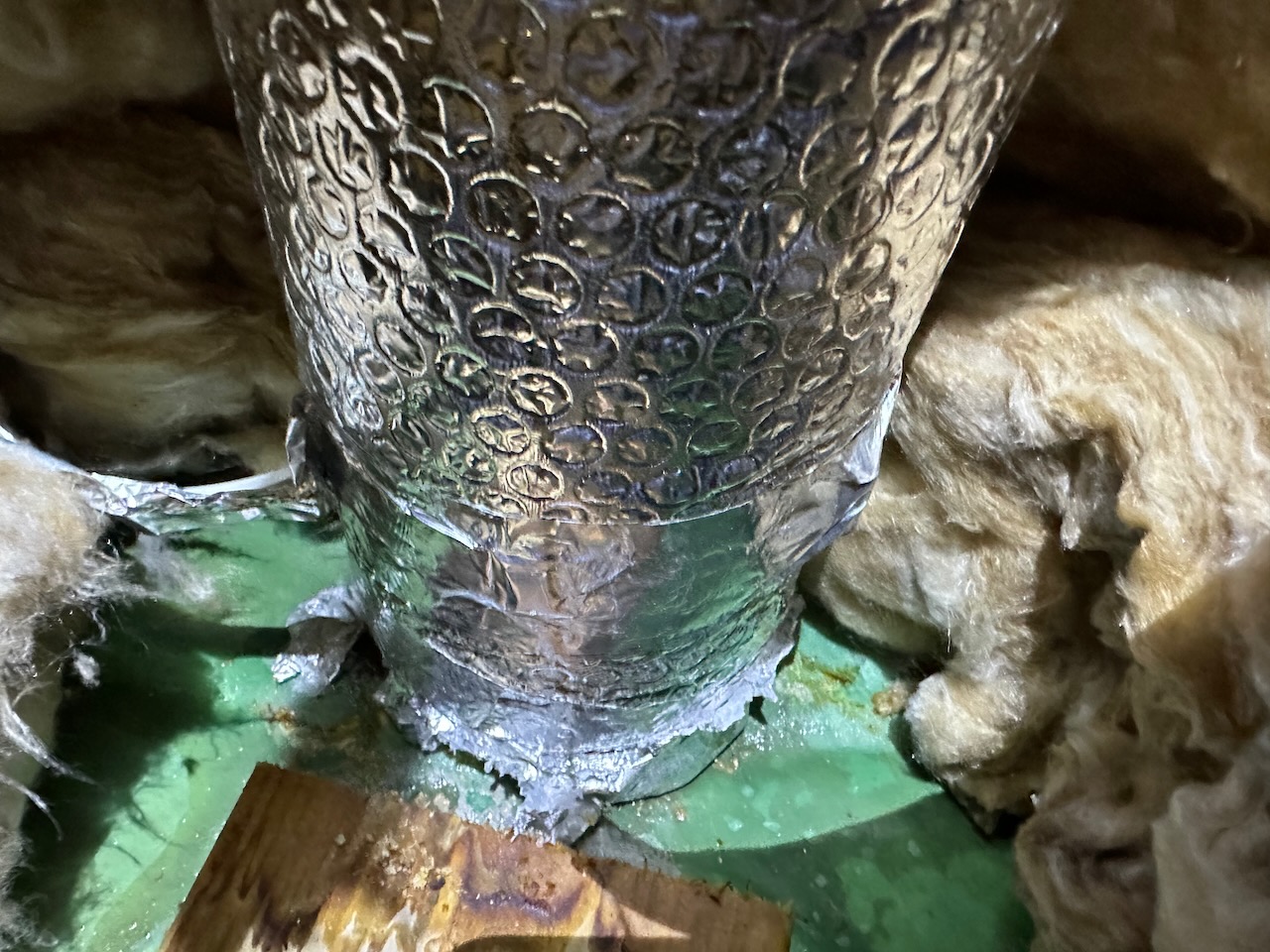

tomaus Posted December 4, 2022 Posted December 4, 2022 Hi all, I live in a 9 year old hour which has a Nuaire MRXBOX MVHR unit, the past few years I have had a reoccurring leak through the ceiling vent in one of the bedrooms. The issue only occurs in the winter in cold temperatures when the outside air temperature drops to close to freezing. Based on my reading I guess this is most likely a result of poor insulation on the ventilation pipe drop for this room, but I'm not sure what I should be looking for to find the fault and how to repair it. Does anybody have any experience troubleshooting an issue like this, or a guide on how to correctly insulate the pipework? Thanks in advance, Tom
Radian Posted December 4, 2022 Posted December 4, 2022 7 minutes ago, tomaus said: most likely a result of poor insulation on the ventilation pipe drop You would appear to have some serious condensation forming on the pipe. Is the heat exchanger set to summer mode? If it was set to winter and exchanging heat from the outgoing to incoming air isn't enough to keep the pipe above dew point then it's most likely due to poor insulation on that drop. But it's also testimony to the amount of water vapour in your loft. Why would that be?
ProDave Posted December 4, 2022 Posted December 4, 2022 This will be condensation in or on that duct. I am a little surprised to see it on an inlet pipe, that pipe at that point should contain "warm" air that has been heated by the heat recovered from the exhausted air. I do notice that vent terminal is shut down probably too much, so the airflow will be low. First you need to establish if the condensation is on the inside or outside of the pipe.
tomaus Posted December 4, 2022 Author Posted December 4, 2022 2 hours ago, Radian said: You would appear to have some serious condensation forming on the pipe. Is the heat exchanger set to summer mode? If it was set to winter and exchanging heat from the outgoing to incoming air isn't enough to keep the pipe above dew point then it's most likely due to poor insulation on that drop. But it's also testimony to the amount of water vapour in your loft. Why would that be? I wasn't aware the heat exchanger has different modes, there were no instructions left by the developers about needing to change settings on the unit. 2 hours ago, ProDave said: This will be condensation in or on that duct. I am a little surprised to see it on an inlet pipe, that pipe at that point should contain "warm" air that has been heated by the heat recovered from the exhausted air. I do notice that vent terminal is shut down probably too much, so the airflow will be low. First you need to establish if the condensation is on the inside or outside of the pipe. Thanks, I'm fairly certain the water is on the outside of the pipe as it seems to be pooling in the loft and the water coming through the ceiling is dripping from the outside edge of the metal ring on the ceiling. Interestingly this drop is no the closest to the heat exchanger and there are no signs of the damp on the other pipe drops.

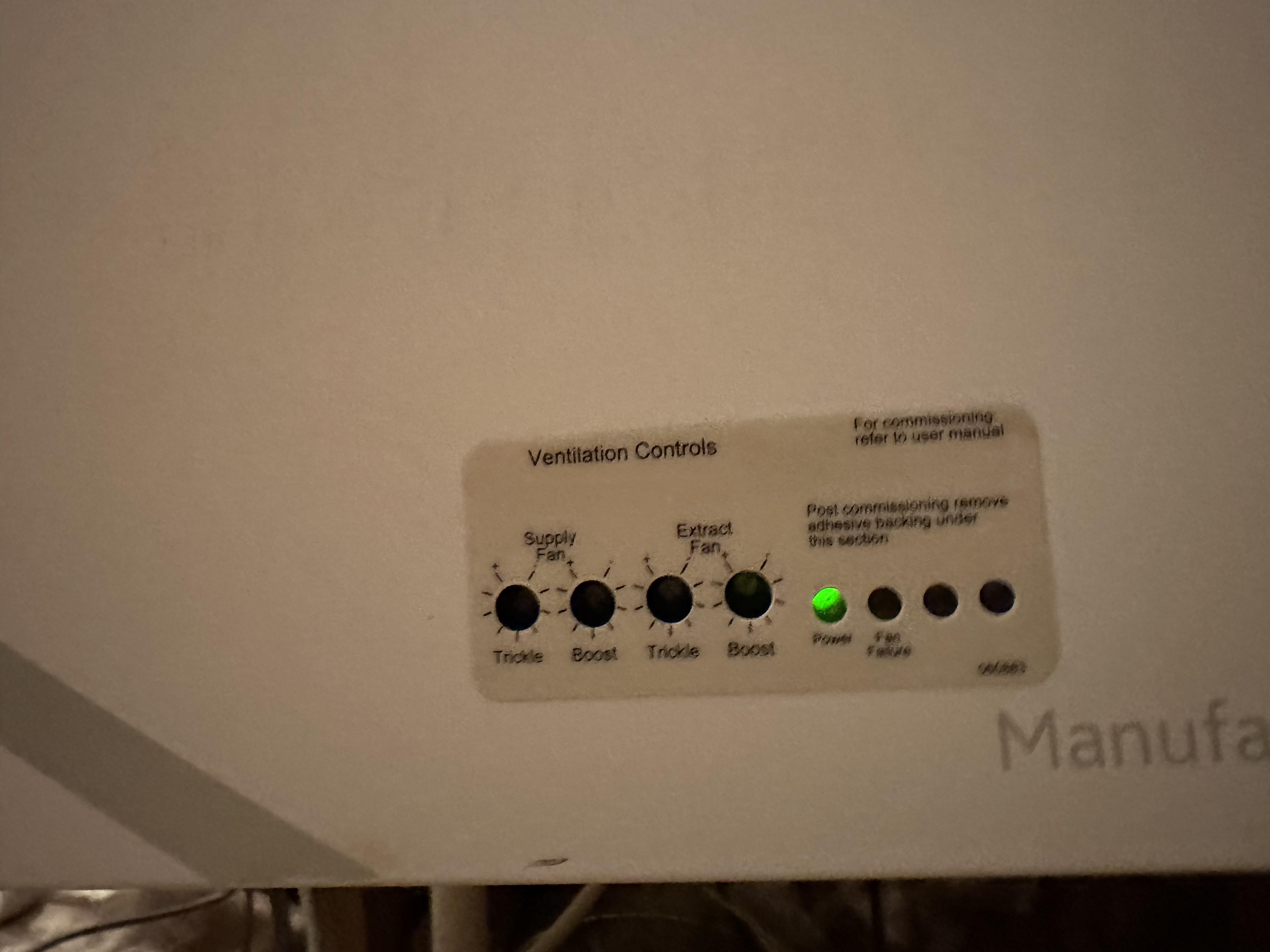

ProDave Posted December 4, 2022 Posted December 4, 2022 Post the model number of the MVHR unit and a picture of any controls you have associated with it. The place you usually get condensation is the external cold air pipe going from outside to the MVHR unit.
tomaus Posted December 4, 2022 Author Posted December 4, 2022 It's a Nuaire MRXBOX95-WALL, not much in the way of controls just some dials for fan speed.

tomaus Posted December 5, 2022 Author Posted December 5, 2022 I’ve just been up in the loft and there definitely isn’t a switch anywhere. The unit was installed when the house was built so not a DIY job. Based on the Nuaire instructions I think the bypass might be automatic, so maybe an issue with a sensor or the control board.
