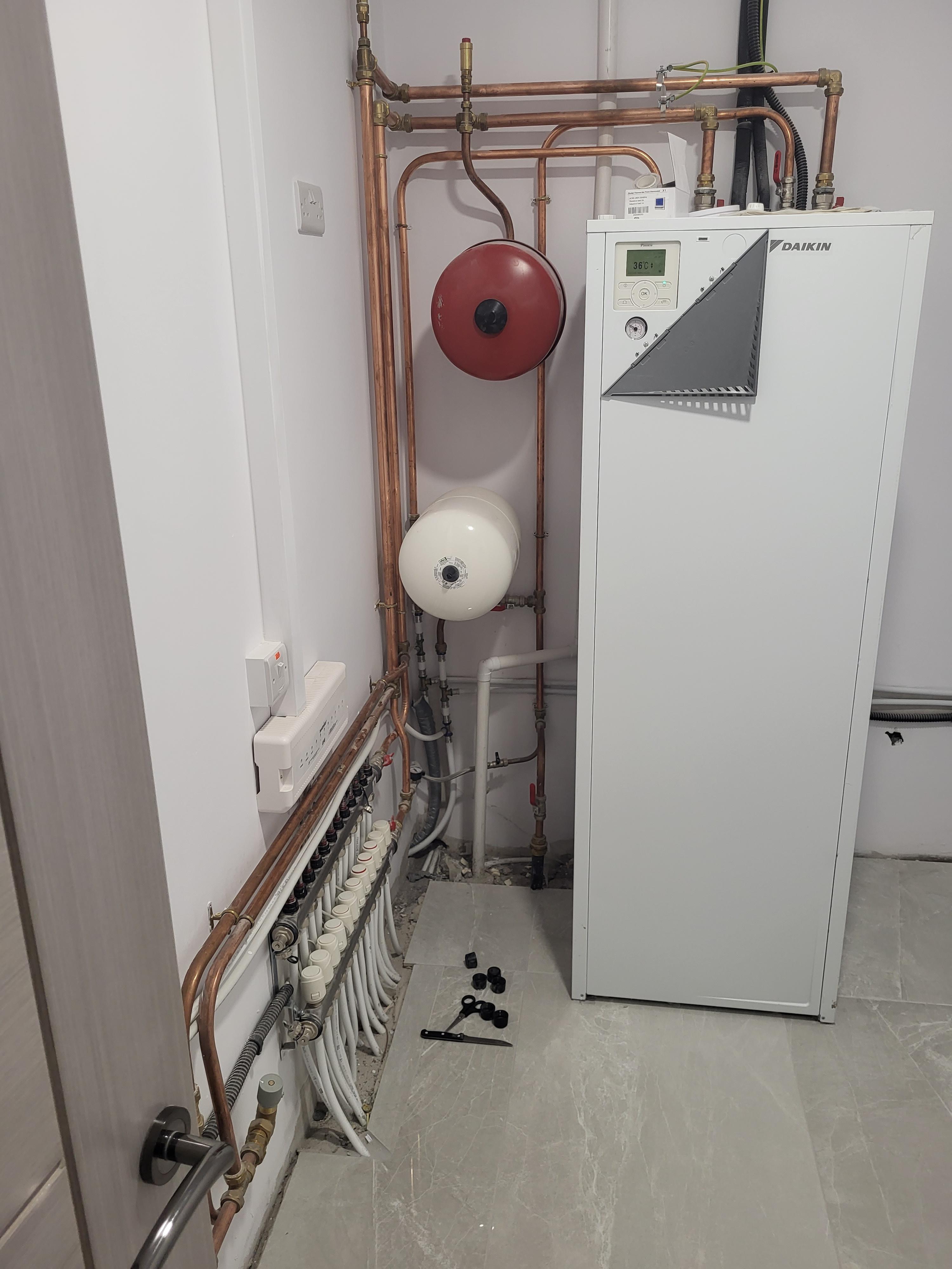

newhouse87 Posted March 2, 2023 Share Posted March 2, 2023 Can i still have flow showing on manifold but airlock on loop down along it. Left sitting room heating on all night and no heat increase and floor v cold to touch. Thought maybe stats wired wrong but that doesn't seem to be the case. Link to comment Share on other sites More sharing options...
PeterW Posted March 2, 2023 Share Posted March 2, 2023 7 minutes ago, newhouse87 said: Can i still have flow showing on manifold but airlock on loop down along it. Left sitting room heating on all night and no heat increase and floor v cold to touch. Thought maybe stats wired wrong but that doesn't seem to be the case. take the actuator off and put the commissioning cap on and open it all the way then check for pump flow etc - pipes will be warm if it’s working 1 Link to comment Share on other sites More sharing options...
newhouse87 Posted March 2, 2023 Share Posted March 2, 2023 the actuator heads are warm and flow meter on that loop is showing 2.5l. Would that mean no possible airlock down the loop? Link to comment Share on other sites More sharing options...
Temp Posted March 2, 2023 Share Posted March 2, 2023 (edited) On most systems the actuator heads press down on a pin to turn off the flow. Removing the actuatorcallows the pin to come up/on. This pin can get stuck down/off. Perhaps remove the actuators on that one and another to compare it with. Eg both/all pins come up to the same height? Does the flow increase with the actuator removed? If that all checks out I would try turning off the three good loops and turn on the problem loop. Does that cause the flow rate on the problem loop to go right up? If so sounds like balancing issue. Partial blockage? When you check for a blockage with a hose make sure you put the supply hose on the flow manifold and hose to drain on the return manifold. Make sure the actuator is open (pin up). Edited March 2, 2023 by Temp 1 Link to comment Share on other sites More sharing options...
newhouse87 Posted March 2, 2023 Share Posted March 2, 2023 (edited) ill do it when i get home after tonights shift. Thanks. I wont go near it with hose as im not most diy savvy. Could flow meter read ok on manifold yet still have air in the loop? Are actuator heads meant to be hot? Return pipes dont feel warm however. Edited March 2, 2023 by newhouse87 Link to comment Share on other sites More sharing options...

PeterW Posted March 2, 2023 Share Posted March 2, 2023 No circulation pumps on the manifold - there is your issue. 1 Link to comment Share on other sites More sharing options...
newhouse87 Posted March 2, 2023 Share Posted March 2, 2023 What? Im quite cluelss and my plumbers not the best. Most zones work ok. Bit slow to heat up but ok. Link to comment Share on other sites More sharing options...
newhouse87 Posted March 3, 2023 Share Posted March 3, 2023 Can this pump be added now? juts thinking its the rooms farthest away are slowing /not heating at all. Link to comment Share on other sites More sharing options...
Temp Posted March 3, 2023 Share Posted March 3, 2023 Yes they can be added. There would normally be a pump and mixer on each manifold. The manifold pump sends the same water round and round the floor loops. The mixer injects new hot water into the floor loops to maintain them it at a set temperature. Typically looks something like this (see photo). The pump is obvious. The mixer is at bottom left near the flow and return valves. You might also need a bypass added to the system to deal with a situation where the mixer on both manifolds is closed. We have seen all sorts of problems on here. Manifold pumps and mixers are normally fitted on the left of the manifold. We've seen problems where they have tried to fit them on the right due to a lack of space and they have ended up being fitted upside down or with the pump pointing in wrong direction. If your plumber doesnt know about UFH I would find another that does. I note a distinct lack of insulation on all your main flow and return pipes as well. 1 Link to comment Share on other sites More sharing options...

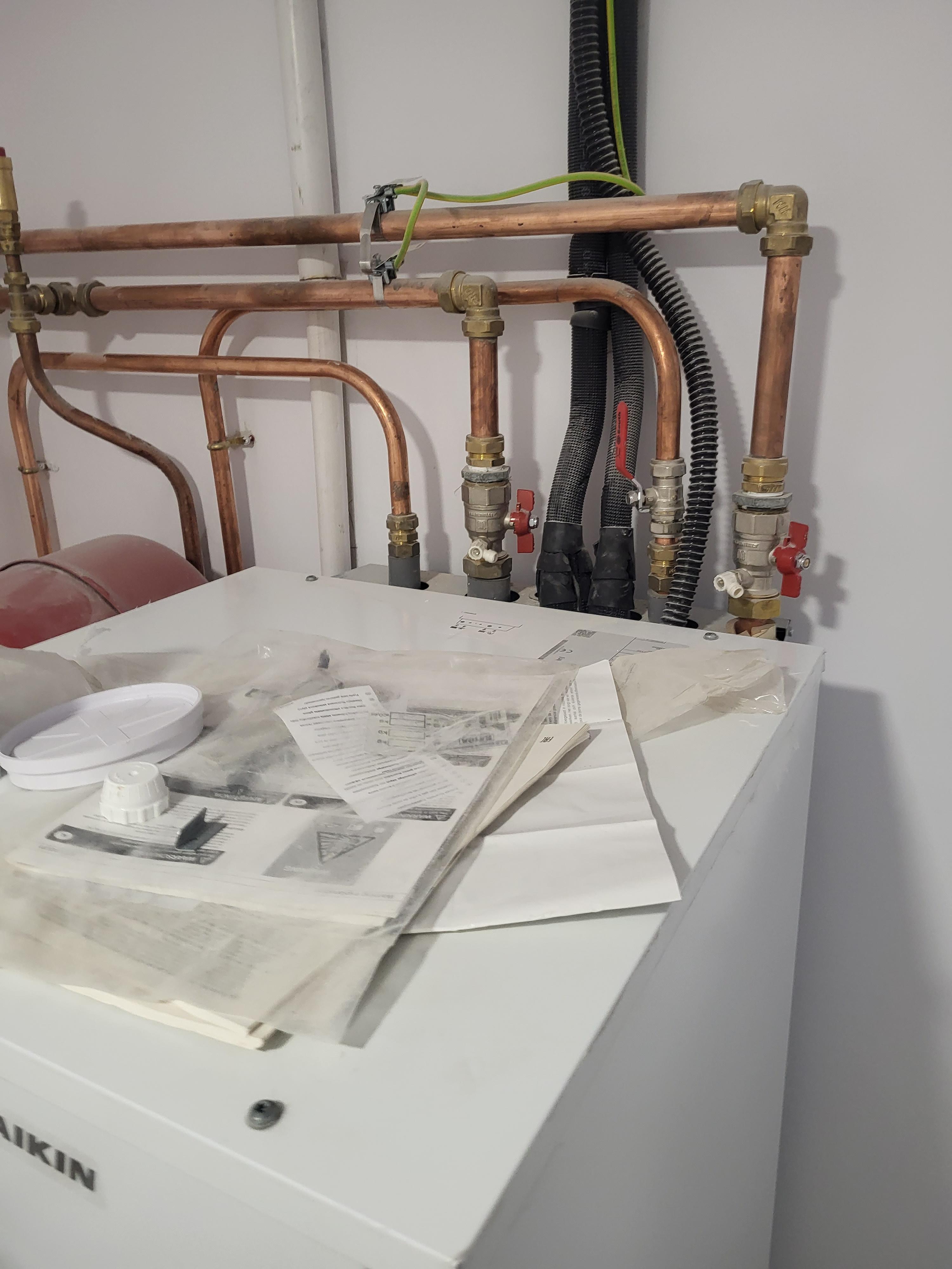

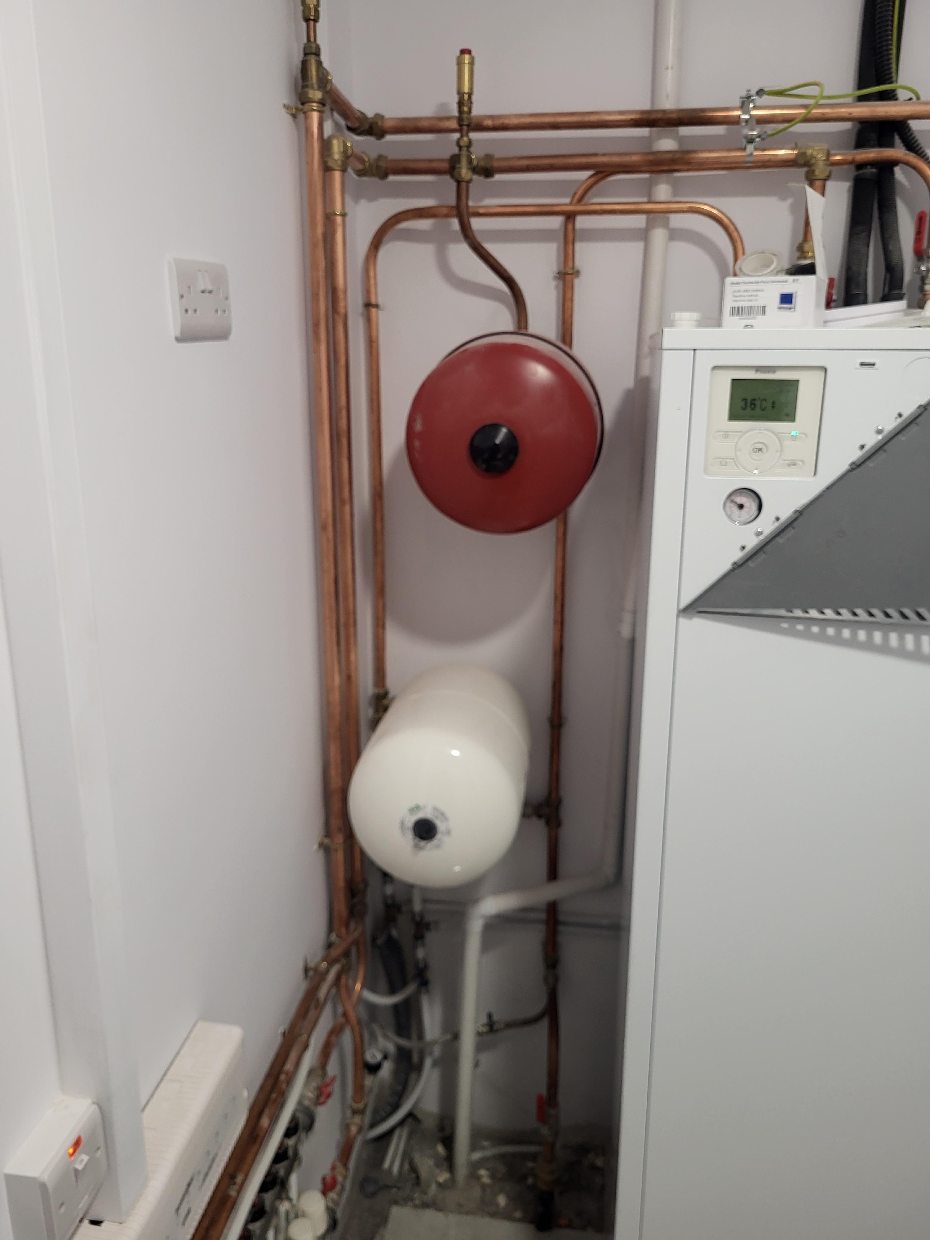

newhouse87 Posted March 3, 2023 Share Posted March 3, 2023 Thanks so much for the info, before i go asking my plumber who probably never heard of most of this a few more pics to see if any pump anywhere. would the fact my flows all seem ok not indicate my pump function is ok? Link to comment Share on other sites More sharing options...
newhouse87 Posted March 3, 2023 Share Posted March 3, 2023 it does seem be my sun and sitting room which are farthest away dont seem to get up to temp. Last few months i have been thinking maybe its loops wired to wrong stats. Would lack of circulation pump explain this? Link to comment Share on other sites More sharing options...
JohnMo Posted March 3, 2023 Share Posted March 3, 2023 Was the system ever commissioned by the plumber - or did he just install and walk away? First set all the thermostats so they are calling for heat. Check all actuators are open. Then reduce thermostat temp (one at a time) and which actuators close (after about 5 to 10 mins) mark the room on the actuator (s). Once you have rooms for each actuator, check if they match where you think they should be. Your pump from the heat pump/boiler may be just too small to cope with the flow to all your loops. Go through each loop and record the flow being recorded on the flow meter. Does your paperwork contain a pump curve? It will be a graph m3/h or litres/min on the bottom and pressure or m head on the vertical axis. You have a short run of pipe to the manifolds, but a lot of loops in the floor. The issue could be the amount of flow required? Link to comment Share on other sites More sharing options...
newhouse87 Posted March 3, 2023 Share Posted March 3, 2023 (edited) Plumber set up pipes and another guy came and commissioned the daikin unit, didnt leave any paperwork. Im doing it sunday. I know most of what turns on what just loops1-5 for sun/sitting room im not sure of. All flows get up to 2.5 so would that suggest i have circulation pump somewhere? All actuators do open fine. Edited March 3, 2023 by newhouse87 Link to comment Share on other sites More sharing options...
newhouse87 Posted March 4, 2023 Share Posted March 4, 2023 Just reading about my dakin unit, it has circulator pump in unit and says no third party components needed. Was thinking because flows are all ok so must be just stats wired to wrong loops. Link to comment Share on other sites More sharing options...
PeterW Posted March 5, 2023 Share Posted March 5, 2023 On 04/03/2023 at 04:04, newhouse87 said: Just reading about my dakin unit, it has circulator pump in unit and says no third party components needed. Was thinking because flows are all ok so must be just stats wired to wrong loops. Yep that’s fine for Rads but not for UFH - the manifold flow is finding it’s own shortest and least resistant route. I’m losing count of the amount of crap UFH installs I’ve seen or had to fix where pumps have been ignored to save £200 and then it’s a £4-500 job to fix retrospectively. On 03/03/2023 at 22:33, newhouse87 said: another guy came and commissioned the daikin unit, didnt leave any paperwork. So where is the G3 sign off for the pressure tank..?? Building regs/Manufacturer requirement Link to comment Share on other sites More sharing options...
JohnMo Posted March 5, 2023 Share Posted March 5, 2023 1 hour ago, PeterW said: the manifold flow is finding it’s own shortest and least resistant route Understand if the pump cannot supply enough flow to manage the flow requirements it will supply the lowest head loss loops and ignore the high loss loops. Which maybe the case here. But a conflicting statement is On 03/03/2023 at 22:33, newhouse87 said: All flows get up to 2.5 And On 03/12/2022 at 20:58, Newbuildnewbie said: but there is no flow at all showing in the flow meter Also if all flows show 2.5 l/min, would suggest zero commissioning has taken place and the flow are not balanced. Big pump or 2 maybe needed for 16 x 2.5l/min Link to comment Share on other sites More sharing options...
newhouse87 Posted March 5, 2023 Share Posted March 5, 2023 7 hours ago, PeterW said: Yep that’s fine for Rads but not for UFH - the manifold flow is finding it’s own shortest and least resistant route. I’m losing count of the amount of crap UFH installs I’ve seen or had to fix where pumps have been ignored to save £200 and then it’s a £4-500 job to fix retrospectively. So where is the G3 sign off for the pressure tank..?? Building regs/Manufacturer requirement BUt if the manifold finding flows that are heating rooms is that not ok? Dunno where any of that stuff is but he was daikin engineer. Link to comment Share on other sites More sharing options...
