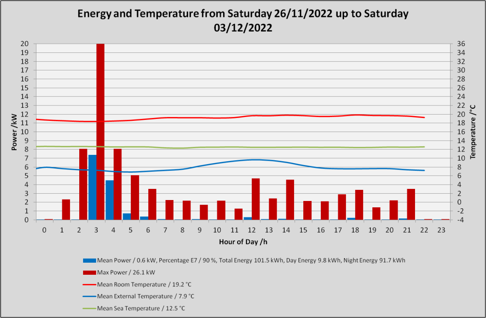

SteamyTea Posted December 4, 2022 Posted December 4, 2022 10 minutes ago, saveasteading said: Can you explain simply and approximately what these terms are compared to normal brick etc? Simply, yes, it is in the numbers. Feolite has a SHC 0.92 kJ.kg-1.K-1, k 2.1 W.m-1.K-1 and rho 3900 kg.m-3 Clay brick has a SHC of 0.8 kJ.kg-1.K-1, k of 1.3 W.m-1.K-1 and a rho of 1700 kg.m-3 Thermal Inertia is calculated from the square root of the product of the above three Feolite is 87 kJ.m-2.K-1.s-0.5 Brick is 42 kJ.m-2.K-1.s-0.5 So basically, in the same amount of time, and at the same temperature differences, for the same exposed surface area, Feolite can release (or absorb) twice the amount of energy as ordinary clay brick. But it has a mass of over twice that of clay brick. So building a a house of out Feolite would not really make it more thermally stable, just heavier. The reason it is used is it takes up less space. Doing the same for pine and you get 371 kJ.m-2.K-1.s-0.5 around 6 times the energy released. Why the term 'thermal mass' is a nonsense term. Though you would not want to stick an electrical element into a block of pine and heat it up. Material properties from here: https://material-properties.org/ 1 1
saveasteading Posted December 4, 2022 Posted December 4, 2022 44 minutes ago, SteamyTea said: twice the amount of energy Twice as fast, or twice the total energy storage regardless of time? Excuse me, covid does not allow consideration of equations.
SteamyTea Posted December 4, 2022 Posted December 4, 2022 (edited) 13 minutes ago, saveasteading said: Twice as fast, or twice the total energy Twice the energy, in the same time, for the same area. Or twice the power for the same area (power is J/s). With heat transfer, area is important. Storage heaters take advantage of this by opening the flap and allowing more air to pass by. This is the same as increasing the area. Edited December 4, 2022 by SteamyTea

SteamyTea Posted December 5, 2022 Posted December 5, 2022 (edited) 2 hours ago, zoothorn said: just can't understand the 'flap' thing It is really quite simple. When the storage heater is charging up at night, the flap is automatically closed. When it stops charging up, it opens to the pre set position. The reason this works is because a storage heater is a convection heater i.e. air passes through it. All the flap does is limit, or stop the airflow. Now don't tell me you cannot understand that. Edited December 5, 2022 by SteamyTea
saveasteading Posted December 5, 2022 Posted December 5, 2022 2 hours ago, zoothorn said: the 'flap' thing, I took some to bits to salvage the bricks. It's such a simple, primitive thing. Heater heats the blocks which are enclosed in a box. Lift flaps to release heat from blocks to air. Hot air rises and draws room air in to be heated, and rise. Close flaps and repeat. If there was any insulation to contain the heat until wanted, I can't remember.
SteamyTea Posted December 5, 2022 Posted December 5, 2022 38 minutes ago, saveasteading said: If there was any insulation to contain the heat until wanted, I can't remember. There is a thin layer on the metal panels. Probably asbestos wool on the really old ones from the 1960s. 39 minutes ago, saveasteading said: It's such a simple, primitive thing Did you notice the small element on the the flap control to shut it down when charging?
saveasteading Posted December 5, 2022 Posted December 5, 2022 10 minutes ago, SteamyTea said: Did you notice No, it wasn't forensic standard. And it was due to the skip in the morning. how does that work?
SteamyTea Posted December 5, 2022 Posted December 5, 2022 18 minutes ago, saveasteading said: how does that work The flap is controlled by a bimetallic strip. Too hot, it closes, too cold, it opens. The output knob just mechanically limits the amour it can open. On the bimetallic strip is a resistance heater that warms up when the E7 (or any power) is applied. This closes the flap and reduces losses when they are not needed (not so brilliant for really early risers like me, but lockout timers can easily sort that, or thick pyjamas). Really simple and elegant solution to a problem. If it fails, the heater still works, just takes longer to heat up as losses to the room are higher.
