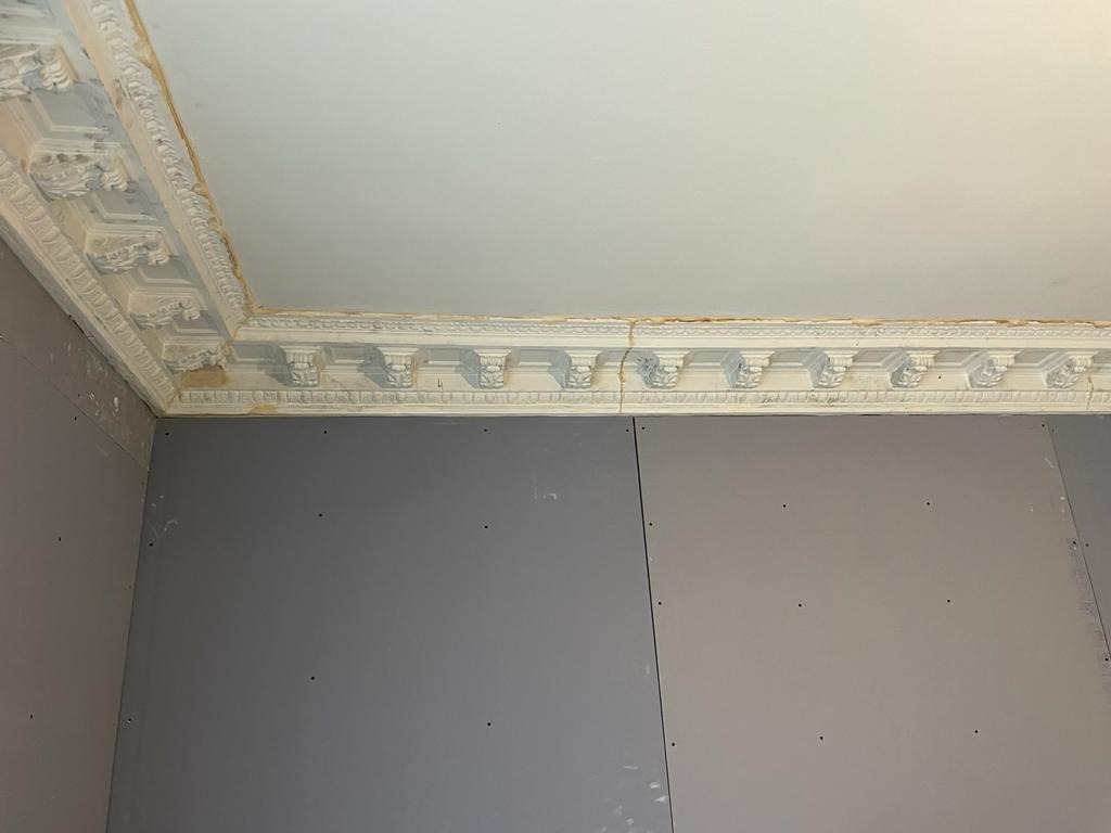

Garald Posted December 12, 2022 Author Share Posted December 12, 2022 8 hours ago, SteamyTea said: PSI (thermal bridges) could soon add up on a complicated shape. By the way, as I said in another thread, the foreman and workers took the initiative and removed the moulding before installing insulation, and then managed to reattach it, thereby avoiding a thermal bridge that the architect and I didn't have a good solution to. Nice! (The foreman says not to worry about the glue spots - he'll deal with that in a bit.) Link to comment Share on other sites More sharing options...
