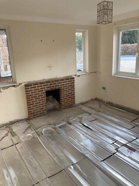

HughF Posted November 29, 2022 Share Posted November 29, 2022 On 29/11/2022 at 11:02, PeterW said: With no cavity wall and the spacing on those pipes I’m surprised you’ve not got bigger bills ..! Get the insulation in, nothing you can do about spacing now. Also - is that filled with a pug mix or just spacers as the spacers shouldn’t be hanging down between the joists. Basically you need to get them tight up against the boards above, looking at that they are draped. Expand It’s almost certainly just a bent mess of spreader plates under the chipboard. It’s a miracle it works at all really…. Shocking install. 1 Link to comment Share on other sites More sharing options...
