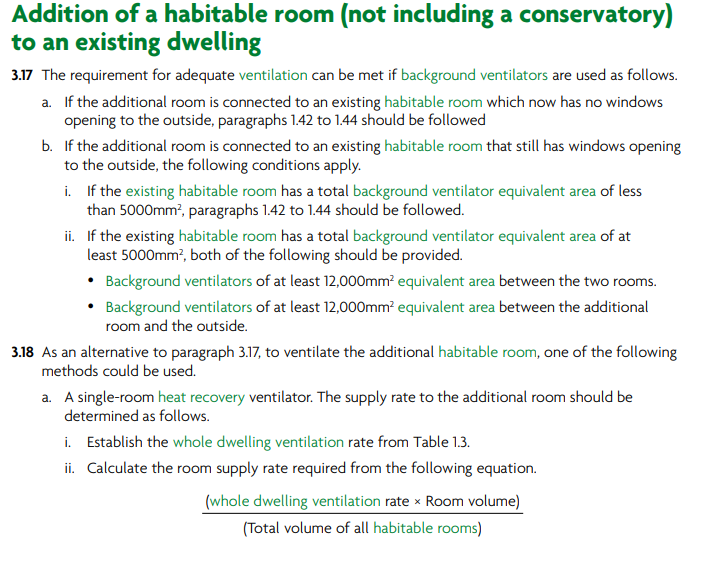

HughF Posted November 24, 2022 Share Posted November 24, 2022 We are starting on our single story rear extension next spring and I'd like to get ahead of the curve and get the 2x windows ordered up. My understanding of the latest regs is that BC will expect trickle vents, or 'other ventilation'. I'd prefer to fit a dMVHR through the wall to handle air changes. Either a Partel Lunos, or something similar. I don't have trickle vents on the rest of the house. Can I go ahead and order my windows up without trickle vents? We will be using the builders preferred BCO, not the council officer. Link to comment Share on other sites More sharing options...

HughF Posted November 25, 2022 Author Share Posted November 25, 2022 5 hours ago, nod said: In England You don’t need trickle vents in an extension Sorry if this has already been answered The FAQs I've read from two window suppliers say otherwise, but from reading ADF1, it seems that a single room heat recovery ventilator is acceptable (as expected). Link to comment Share on other sites More sharing options...
craig Posted November 25, 2022 Share Posted November 25, 2022 Stick them on with double-sided tape, then take them off when BCO sign things off 6 hours ago, nod said: In England You don’t need trickle vents in an extension You do, rule changes from June. Unless alternative means of background ventilation exist. https://assets.publishing.service.gov.uk/government/uploads/system/uploads/attachment_data/file/1045918/ADF1.pdf 0.7 New extensions to historic and traditional dwellings should comply with all ventilation standards in this approved document unless there is a need to match the external appearance or character of the extension to that of the host building. Link to comment Share on other sites More sharing options...
