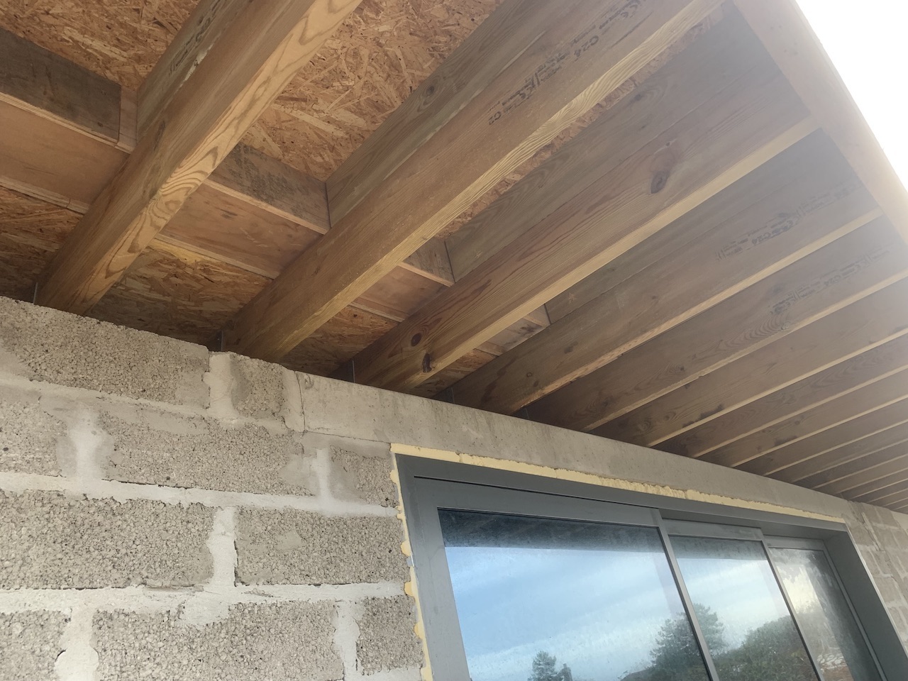

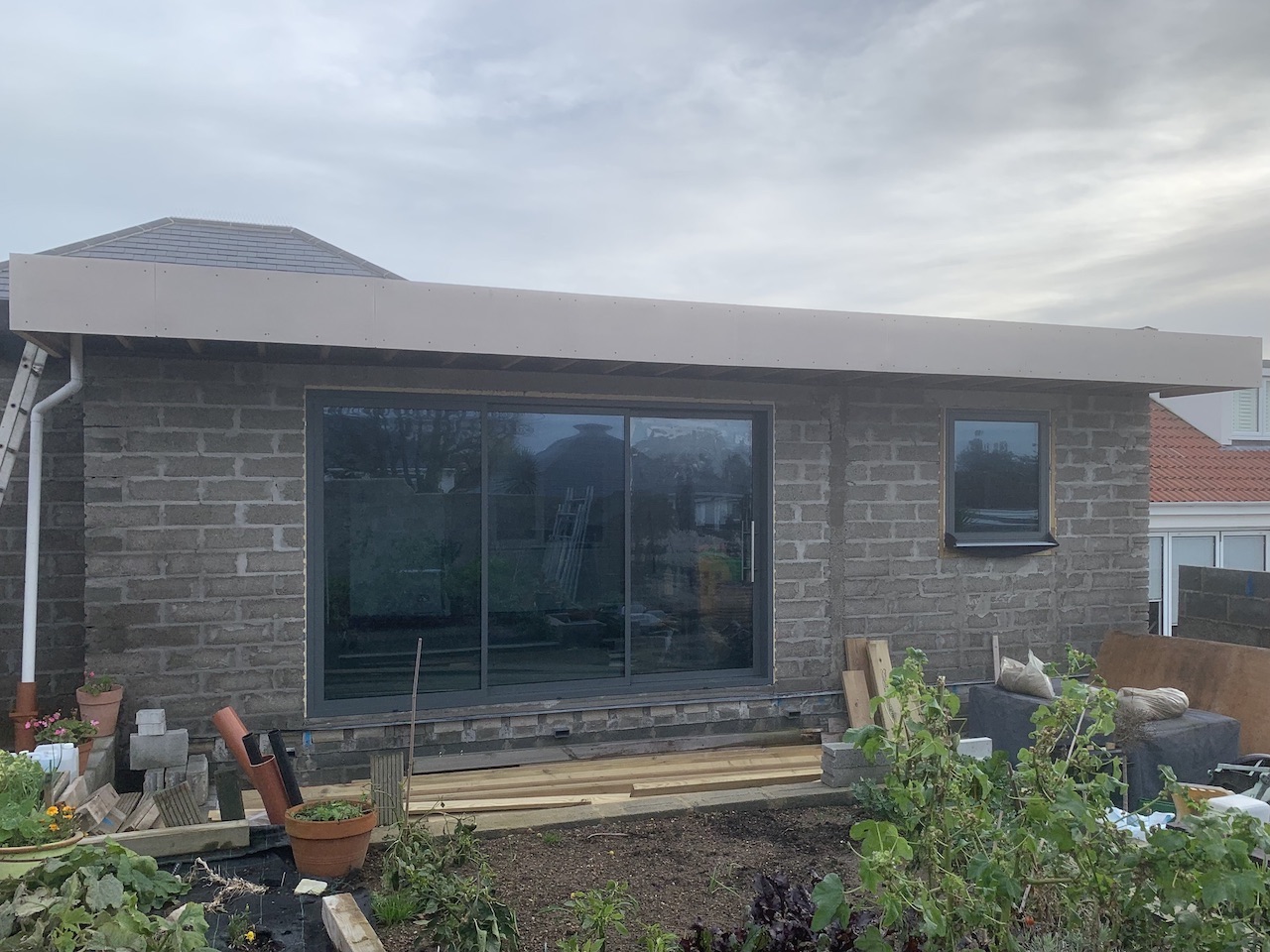

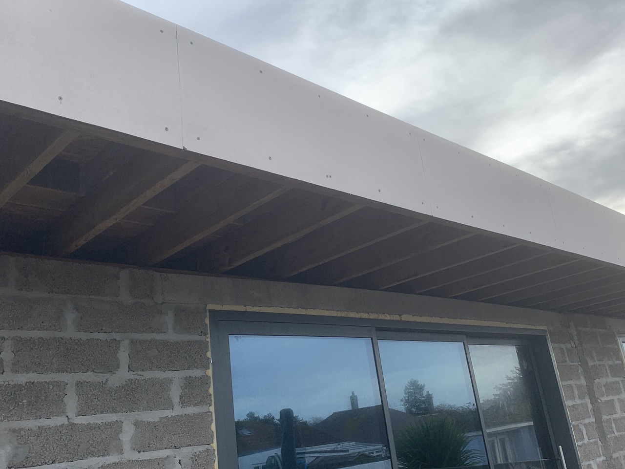

phatboy Posted November 24, 2022 Share Posted November 24, 2022 (edited) Hi all, Sorry for the long confusing topic name. I'm hoping for a little expertise on a design detail. The extension I am part way through building has the flat roof overhanging the building by 1m on the south side. It will all be externally insulated (no cavity), and the overhang will be clad on the underside and down the wall. It is likely to be cladding with gaps. This leaves me unsure how I will close between the joists above the walls, so that the inside is airtight and remains a warm roof. Will cutting the EWI boards tight around the joists and foaming, then rendering be enough? I worry it may end up with gaps as the seasons change? Not really sure what other options I have. Please see photos to clarify what I'm trying to do. Thanks! Edited November 24, 2022 by phatboy Link to comment Share on other sites More sharing options...
Russell griffiths Posted November 24, 2022 Share Posted November 24, 2022 Isn’t your airtight layer on the inside? seal up the inside then bring your external insulation up to soffit height, then do separate insulation between joists. Soffit on and render bead under soffit for a neat finish. Link to comment Share on other sites More sharing options...
Andehh Posted November 24, 2022 Share Posted November 24, 2022 Yep, exactly that. I would cut and fit rigid insulation tightly between those joists, and expanding foam to seal tight. Then external insulation/cladding right up over it 1 Link to comment Share on other sites More sharing options...
phatboy Posted November 24, 2022 Author Share Posted November 24, 2022 4 hours ago, Russell griffiths said: Isn’t your airtight layer on the inside? seal up the inside then bring your external insulation up to soffit height, then do separate insulation between joists. Soffit on and render bead under soffit for a neat finish. Well that gap currently goes into what will be the ceiling void. Thanks, I wonder if there is benefit to doing separate insulation, or just letting the EWI boards all the way to the top? It won't be a closed soffit, it will be some kind of cement cladding, Millboard etc 3 hours ago, Andehh said: Yep, exactly that. I would cut and fit rigid insulation tightly between those joists, and expanding foam to seal tight. Then external insulation/cladding right up over it Thanks, nice that someone else would do what I was thinking! Just wondering if the seasonal changes will open gaps between the timber and insulation..... Link to comment Share on other sites More sharing options...
ProDave Posted November 24, 2022 Share Posted November 24, 2022 I would have closed them with noggins where they crossed the outside wall, then insulate up to the noggins on the inside. Link to comment Share on other sites More sharing options...
Andehh Posted November 25, 2022 Share Posted November 25, 2022 Rigid insulation will be very thermally stable, even the wood will be providing it doesn't get wet & is dry when installed. A thick bead of silicone or expanding foam to seal the insulation in will be flexible enough to cope none the less. 1 Link to comment Share on other sites More sharing options...
phatboy Posted November 27, 2022 Author Share Posted November 27, 2022 Thanks all, I'll go with cutting and pushing the insulation all the way up, then foam it well, and also silicone it after it's rendered. Thanks for the help :) Link to comment Share on other sites More sharing options...
JohnMo Posted November 27, 2022 Share Posted November 27, 2022 If you zoom in you will see how I did mine. Basically lots of PIR off cuts, tight fitted into the gaps, plus spray foam. Did mine before the roof was plywood sheeting over, so it was quite easy to do and get at. 1 Link to comment Share on other sites More sharing options...
