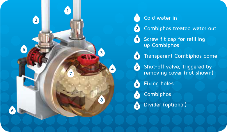

As an alternative to a conventional salt-gobbling, kitchen-cabinet filling, water-wasting softener, I'm planning on installing a whole-house Combimate (made by Cistermiser).
This is one of those polyphosphate micro-dosing thingies (it adds about 2–3 ppm of food-grade polyphosphate, which sequesters the dissolved calcium, so reducing scale). @JSHarris almost certainly knows about the idea, but I thought of him when I read the claim that it's also good for red/brown water from boreholes.
I was going to get a BWT Combicare from ScrewFix, but was put off by DIYnot denizens saying they often plug up with scale, which is kinda ironic. Or there's a similar Italian product I found on FleaBay.
So anyone got experience of these things? Do they work? Do they keep working after a few years?

Worth noting that phosphate dosing doesn't remove anything from the water, the proportion of metals in the water on the inlet side is exactly the same as the proportion of metals in the outlet side, so there is the same amount of calcium, magnesium, iron etc in the water post treatment as before.  The primary effect is to coat the inside of the pipework, heat exchangers, water heaters etc with a protective coating that reduces the level of scale build up.  A secondary effect is that the small amount of phosphate makes the water easier to lather with soap.  In essence, it's the same as adding Calgon to the water supply, but in a continuous, low level, dose.
Ion exchange water softeners do remove metals from the water, primarily calcium and magnesium, but also iron to some degree.  They replace those metals with sodium.
You can remove pretty much everything from water with reverse osmosis, but the water tastes pretty awful, it seems we need some mineral content to make water taste OK.
If all you want to do is protect a boiler, water heater etc from scale damage, then phosphate dosing works fine, and is probably the cheapest way of providing protection.  The water boiler for our boiling water tap was supplied with a phosphate dosing filter for just this reason.
If you want to soften the water, by removing high levels of calcium and magnesium compounds, then it's hard to beat a standard ion exchange softener.  As a useful side effect this will also prevent scale formation in boilers and water heaters (but be aware that there is a lot of false data about from manufacturers regarding this - all of it relates to an absence of product certification testing with soft water).
