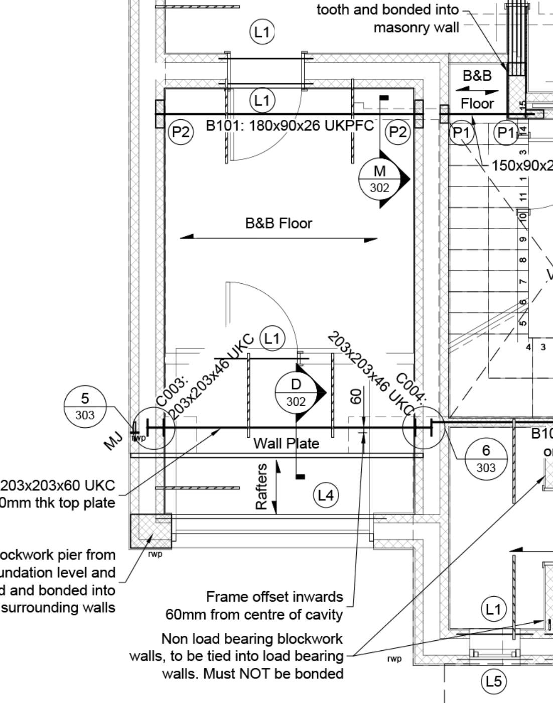

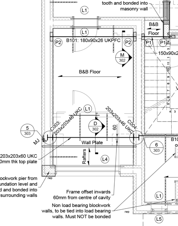

puntloos Posted November 22, 2022 Posted November 22, 2022 My current garage design looks like this: (the 1st floor ends roughly at the words "wall plate" so the weight comes down on that steel. ) My question: Currently my house design has 6 steel beams pointing (by necessity) straight down into the foundation, and my understanding is that these constitute a high amount of energy loss. My builder says that if we get rid of the number 5 and 6 steels (left and right of the garage), I would have a massively lower amount of energy leaking away. But the downside is that they wouldn't be able to support a full garage door since in particular the corner wall point would not be strong enough. 2 extra steel beams add a considerable amount of energy loss, my builder claims about equal to the amount my first floor altogether loses. What do?
markc Posted November 22, 2022 Posted November 22, 2022 203x203x46 UC is a substantial column with a massive load bearing capacity, they must be there for something other than supporting a garage door. assuming this is a really good, heavily insulated garage door, it is likely to weigh around 300kgs which is nothing compared to the structure and occupancy. so my feeling is your builder is talking rubbish and omitting two large UC columns is going to affect much more than just being able to have a garage door. 1
DevilDamo Posted November 22, 2022 Posted November 22, 2022 Well, that’s the first time I’ve heard a builder suggesting to remove steels in order to reduce heat loss 🤔 It’s normally to replace them with a concrete lintel (as it’s something they’ve done in all their career spanning over 30 years). There is going to be no benefit in omitting those columns. Structural integrity in this instance is a lot further up the list than thermals.

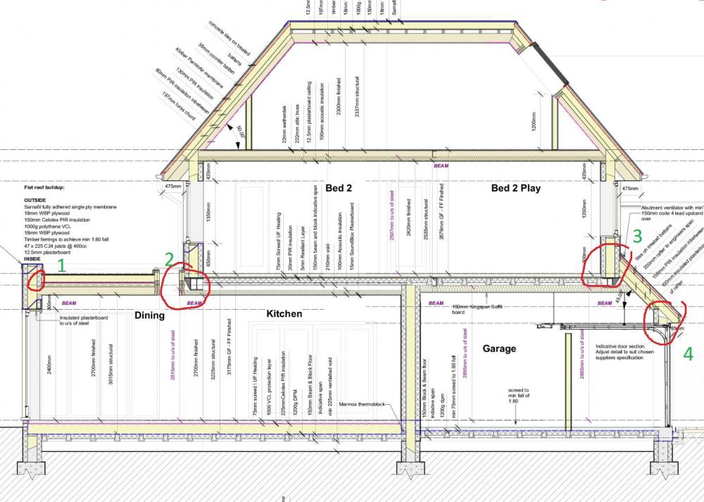

AliG Posted November 25, 2022 Posted November 25, 2022 You had previously posted this plan which shows the position of the steels better. There is a little cold bridge there. The plan does not show a PIR edge around the upper floor screed. This would make a big difference to the cold bridge there and indeed all around the upper floor as the screed touches the blockwork as shown. They are not shown on the ground floor either, I would assume the builder has added them in if he knows his stuff. I guess the interior upper floor blocks could also have a Marmox block between them and the steel which would also reduce the cold bridge. Finally you could maybe put PIR between the beam and the steel if there is space. The vertical posts should not be a concern as they are not in a heated area. If there is a concern it would be heat getting not the horizontal beam and via that into the posts. 1
Mr Punter Posted November 26, 2022 Posted November 26, 2022 With the flat roof parapet you could leave the inner leaf lower and run the roof insulation straight to the outer leaf and have a narrower parapet. Also run a course of Marmox plus a course of 7N Celcons on the outer leaf on the steel beams to stop them getting cold.

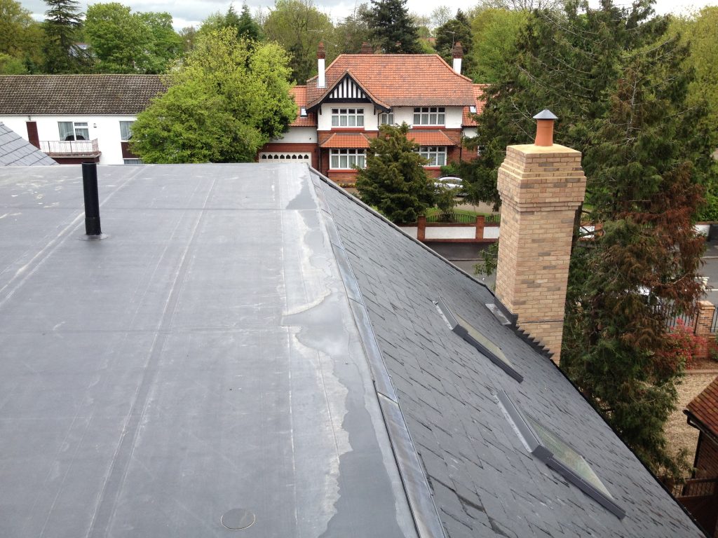

puntloos Posted November 26, 2022 Author Posted November 26, 2022 4 hours ago, Mr Punter said: With the flat roof parapet you could leave the inner leaf lower There's no inner leaf though, the flat roof has no parapet - basic idea would be this: 4 hours ago, Mr Punter said: and run the roof insulation straight to the outer leaf and have a narrower parapet. Also run a course of Marmox plus a course of 7N Celcons on the outer leaf on the steel beams to stop them getting cold. Note you're looking at a slightly older design of the garage section - the idea is to have the thermal envelope of the house start at the inner wall separating garage into bike store(cold) and utility(warm)... But yes surrounding the beam seems helpful, it just isn't always possible I think By the way the armatherm seems like a great solution around this. Plus they hired Morgan Freeman to narrate the video https://www.armatherm.co.uk/thermal-bridging-applications/column-base-thermal-bridging-solution/ so it must be true. I just never knew that thermal materials can hold something as heavy as a house.
puntloos Posted November 26, 2022 Author Posted November 26, 2022 (can't edit anymore) @Mr Punter- do you perhaps have a side view of a "course of Marmox plus a course of 7N Celcons on the outer leaf on the steam beams"? How would this work?

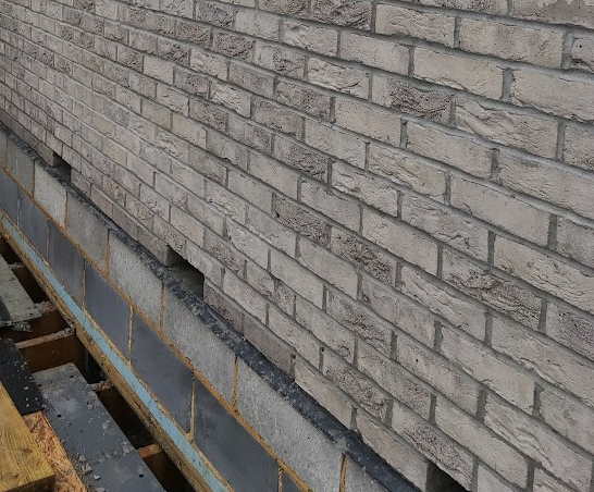

Mr Punter Posted November 27, 2022 Posted November 27, 2022 Here you go. Steel beam not visible, course of Marmox, course of 7N Celcons, course of med density agg, lower bit of cavity tray. The bricks are left out to clear out the cavity tray. Cavity will have 150mm EPS beads. Bricks will have a coat of Stormguard. Probably a course of slate under the Marmox to get the coursing to work. 1
Gus Potter Posted November 28, 2022 Posted November 28, 2022 On 22/11/2022 at 03:10, puntloos said: My current garage design looks like this: On 22/11/2022 at 03:10, puntloos said: My builder says that if we get rid of the number 5 and 6 steels Hang on! I may be over thinking but my first reaction is.. the 203 UC columns and beam are probably working to provide part of the horizontal stability stystem to the house. Easily over looked but critical for safety. Can you post more of your plans. Also post if you can the connection design between the column and beam as this will give a clue as to what the columns and beams are intended to do. Please don't swap these out until you check with your SE.
