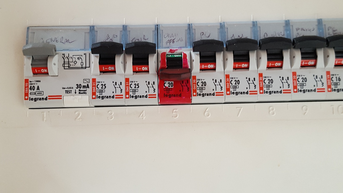

This is a bit of a cheeky post, but I'm hoping that someone can give me some pointers.  I've just arrived at our little home in Brittany, France, for a week's holiday only to find the immersion heater not working.  Other than the kettle, this is our only method of heating water and I really, really hate cold showers so I wondered if anyone can give me an idea of what has happened before I have to ring an outrageously expensive plumber/electrician on Monday morning.
We have relatively modern electrics, the place was renovated about 12 years ago.  It has a consumer unit with all the standard trips for the circuits in the house, one of which is dedicated to the immersion.  All other circuits are working normally, but the immersion is drawing no power when switched on.  It doesn't cause anything else to trip when it gets switched on.
We were last here in May and everything was working then.  When we left, we switched off the water and the electrics for the immersion and the downstairs circuit with the fridge.  As evidenced by the dust and cobwebs, no one has been in the place between now and then.  When we arrived today, I put the water back on, followed by the electricity for fridge and immersion.
The consumer unit is a French one, IP40 from LeGrand, if it makes any difference.  I've switched off the mains a couple of times, tried emptying and re-filling the hot water tank before again trying the immersion.  Nada.  Or should that be 'rien'.

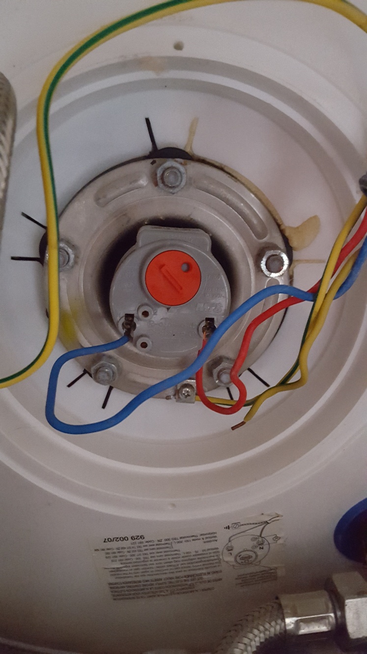

I've attached a photo of the electrics point into the immersion and the consumer unit.  The immersion doesn't appear to have a test/re-set button, just a temperature and the connections going into it.  The consumer unit does have a test button, but I'm not sure that it will make any difference if we can't re-set the immersion.
You need a multi meter to proceed.  It's either going to be a faulty mcb or wiring fault (no power getting to the heater) or the thermostat or the heating element.
That type of immersion you have, the thermostat plugs onto the top of the immersion. Just pull it and it will unplug. When you have that multi meter you can test to see what has failed.

We've put the meter across the contacts into the immersion and there's no current, resistance or much of anything so it appears that the problem is with the immersion, not the consumer unit.  There is nothing to unplug at the top of the tank, just a slight raised circular area at the centre, which I assume is something to do with pressure, but that's it.
We need to get a different size socket in the morning as ours aren't quite large enough, and then we'll drain it down and see if we can remove the offending part.  There is a label near the connection points that says in various languages that the reset button can only be used by the installer; I guess that's because its inside the unit.

Too many conflicting terms there.
With the power turned OFF
Put the multimeter in ohms range, and put the probes where the red and blue wires connect in your picture. What reading do you get? (it's usually about 19 ohms)
If you don't get close to 19 ohms, then unplug the thermostat, it will just pull off, exposing the two terminals of the immersion element. Put the probes on those two terminals. do you get a reading anywhere near 19 ohms?

Sounds like his immersion spanner is the wrong size to me?
Scrub that, THAT immersion looks odd as in its maybe a bolted flange / rubber gasket & he needs a socket for the nuts?

Yup, the last post was not making any sense at all :S.  A multimeter has different settings, one for ohms ( like a horse shoe symbol ) and then you have voltage ( you need AC not DC ) so the 'wavy line' not the flat line ;).
First, as said with the power off, select ohms and take a reading across the red and blue. Then with the power on, select AC volts and do the following in the exact order. DONT FORGET TO SLECT THE CORRECT SETTING EACH TIME YOU USE THE MULTIMETER
Place the black probe onto the blue wire and hold it there, making sure your touching the metal probe on the copper wire.
Then, place the red probe on the red wire and see what voltage you have.
REMOVE THE RED PROBE FIRST AND THEN THE BLACK PROBE OTHEWISE YOU CAN GET ZAPPED BY THE BLACK MULTIMETER PROBE !

What is the red dial for, is that the reset, what does it say on the label ? Maybe you turn it to do a reset?
What make is the white tank, what make is the immersion heater? If we knew this we could search for instructions online?
The tank model is a Regent 150VMI up to 6 Bar and 230v, it appears to be a French model and the manufacturer appears to be LCIE Electicite. I have tested the ohms and got zero, I then tested the voltage as instructed. and got 230v, so I presume that is indicative of power going in but a dead thermostat. The red dial is the temperature setting.
The picture of the immersion is looking at the base of the tank and the 5 bolts seal against a rubber flange and individual rubber washers. I was assuming that with the removal of the nuts this would free the thermostat/ heating element, after draining the tank I hasten to add.

Je ne parle Francais and all that if my O Level French serves me correct but I think what you want is on these lines:
The rubbery bit & stat:
http://www.adepem.com/PIECES-DETACHEES/CHAUFFAGE/CHAUFFE-EAU/REGENT/894020+REGENT+150+VMI.html
& the element:
http://www.jeremplace.com/6665-resistance-2500-watts-droite-pour-chauffe-eau.html
Between the two links you'll see how the stat pokes down inside.
Elements vary in length and wattage so see if you can find that. If you can do that without taking it out and have the new one ready it'll make changing over that much quicker.

Parts all ordered and on their way.  Thanks again, all.
Is that a stray earth lead in the picture?
(The French think earthing/bonding is for pansies)
Edited by SteamyTea
It is indeed!  There is a fully connected earth as well but also the 'spare' one just hanging around.
