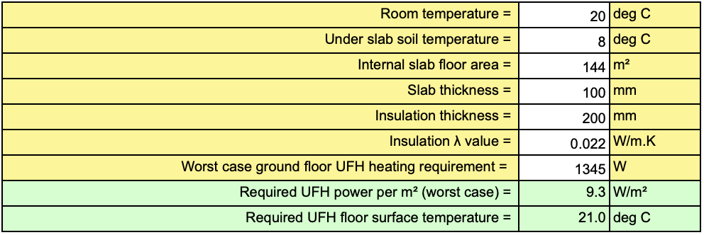

Susie Posted November 11, 2022 Posted November 11, 2022 I didn’t think this would be so hard but after speaking to Telford they said it doesn’t work they have no cylinder that can be run like this. Telford also said constant on/off is not good for immersion heaters, they wouldn’t last as long, and they said thermal stores are outdated, now better insulation is available for cylinders. He seemed to think I need a boiler or heat pump but I disagree. Im working on getting my U value for the new build low to avoid heating most of the year. Spoke to another supplier of UFH and cylinders who looked into it then rang back and also said it can’t be done Next I contacted Gledhill they suggested the Torrent stainless OV https://www.gledhill.net/products/alternative-energy/torrent-stainless-ov/ I also contacted cylinders2go who thought a cylinder with a heat exchanger would work and suggested I ask on the forum. Im sure a lot of users on the forum are doing something similar so why am I running into problems? Other alternatives are willis heater and Sunamp. I don't know much about Sunamp so more research needed. I have been using the fabric and ventilation heat loss calculator and the floor heat loss & UFH calculator. Here is my summary.
JohnMo Posted November 11, 2022 Posted November 11, 2022 I think the problem is although only 1345W that's 32kWh per day. E7 would be 4.5kWh per hour for 7 hours. PV is pretty rubbish in the winter, so I wouldn't bank on anything spare for heating in the winter. But in the summer most of your DHW would be PV heated. Think I would seperate DHW and UFH. Exhaust air heat pump cylinder for DHW, route the air from outside and back outside. Then a Willis x2, most of time only one required. Then batch charge the floor on E7. Or joules do a slightly bigger exhaust air heat pump that can do central heating also.
Nickfromwales Posted November 11, 2022 Posted November 11, 2022 8 minutes ago, JohnMo said: Think I would separate DHW and UFH There's not much to think about, you'd just separate them as they're 2 very different things in a PH. DHW still needs a decent bit of welly, but heating, then, only a thimble ( or 2 ) I've worked for a couple of turnkey M&E clients who insisted on no heat-pump, and with the way electricity costs are going I bet they will soon live to regret there stubbornness. If you have a LOT of PV you can "consider" your options. In the 3 months of winter you'll expect 25% solar irradiance or less, ergo a 10kWp array will deliver 2.5kW or less in winter. IF you are able to channel that into a heat pump, which is an energy multiplier, even in winter, you could then look realistically at offsetting the heating demand from onsite microgeneration. That is based on first considering watt the base loads are for the dwelling and summarising on the averages left over that would contribute to space heating. Without the heat pump........forget about it. Your best friend then will be simply dumping cheap rate electricity into the heat pump and charging the slab like a storage heater. All entirely academic of course, as any excess PV would be long gone on winter DHW. Fit a heat pump. You'll be kicking yourself if you don't.

Gone West Posted November 12, 2022 Posted November 12, 2022 14 hours ago, Susie said: Im working on getting my U value for the new build low to avoid heating most of the year. We had very low U values in our PH. We heated the DHW with an EASHP which was built into the MVHR system so also provided warm air through the ventilation. The house was heated with three towel rails in the bathrooms. I designed the house so no conventional central heating system was required. We ran the whole house at 23C 24/7. 1

Susie Posted November 12, 2022 Author Posted November 12, 2022 I will look into an EASHP thanks @Gone West . I’ve not got as far as choosing the MVHR, no quotes back yet so also left the spreadsheet at air changes per hour at .43 and MVHR efficiency at 85% so hopefully this can be improved. I’ve read about the extra coatings they can put on the ASHP @billt but still not convinced my outdoor investment is the best way I can spend my £ it’s the insides of all those ASHP further down the coast I’m thinking about the average life span of an ASHP in salty conditions can be as low as 7 years in which case my investment is better else where. Perhaps all those air BNB and second homes can afford the maintenance costs or they don’t know until it’s gone wrong and the installers don’t care as that’s more income when they go back to fix them for the part that is out of warranty. 🤔 im considering putting the UFH in but not connecting it up to anything until I know I need it, leaving room in the plant room for either a Willis heater or looking at the Sunamp system.
