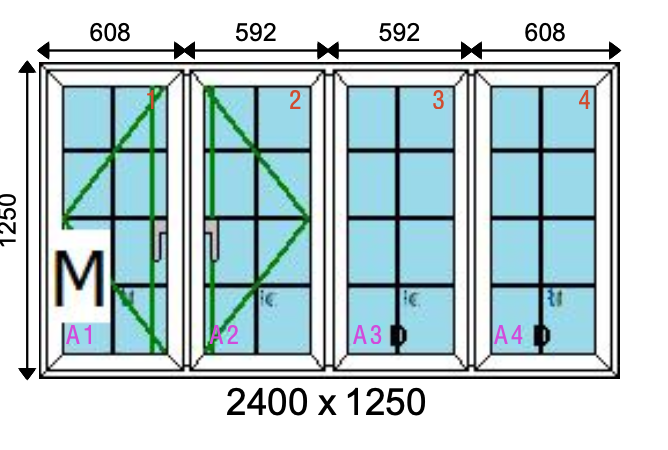

craig Posted May 17, 2024 Share Posted May 17, 2024 (edited) Per m2 pricing, is very, very subjective. There are too many variables for it to be a good tool for comparison but it does give a baseline figure but I'm not a fan of it. At the mid level aspect of the market in terms or pricing, I'd say that £700 to £800 per m2 supply only, is a fair price. At the higher end of the market, I'd say that £1K to £1.2k per m2 is a fair price. 23 hours ago, haythorn_1 said: This window is £4k fitted from rationel. Supply only from nordvest for this was circa £3k Part of an overall order or one window? I'd say that's a fair price to be honest for one item, if it was part of a larger order, then I'd be looking for that to be a little less and in the £2.5K region but that's toughened on all panes (triple glazed), Pas 24 would be roughly the same. Edited May 17, 2024 by craig Link to comment Share on other sites More sharing options...
haythorn_1 Posted May 17, 2024 Share Posted May 17, 2024 Thanks @craig. The quotes were part of a larger order of around 40m2 of windows and French doors. I just shared that specific window as an example of the style. Who would you say are mid level suppliers? Ive not been able to find any quotes sub £1k per m2 that are alu-clad. Maybe my expectations are too high! Link to comment Share on other sites More sharing options...
