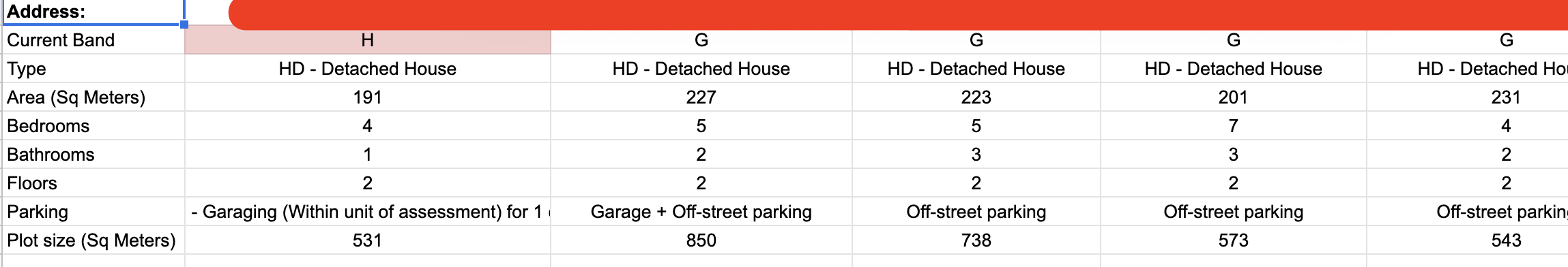

bmj1 Posted November 12, 2022 Share Posted November 12, 2022 We challenged our council band successfully, here is how we did it: 1) We scoured for sold comparables using propertydata.co.uk (Evaluate > Comparables). £14 for a 1 month subscription 2) We used Zoopla to check specifics of the property (bedrooms, bathrooms) to see if it was a suitable one for our challenge (it took some trial + error, but we eventually narrowed down to a few good examples) 3) Through trial + error we found 7 examples of properties within a 2 mile radius of our house that had sold for more than we bought our house for (implying a higher valuation was likely in 1991), that had a lower council tax band. We also ensured that they met the following criteria: a) Same type of house (i.e. detached) b) Internal Area in sq meters equal to or higher than ours c) Number of bedrooms equal to or higher than ours d) Number of bathrooms equal to or higher than ours e) Parking equal to or better than ours f) Plot size equal to or better than ours It was actually very straightforward, and by presenting the data clearly in a table (see below), it was easy to make the case that our house was misbanded.. I hope this helps. Good luck 2 Link to comment Share on other sites More sharing options...
