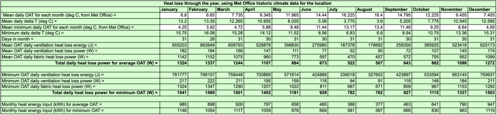

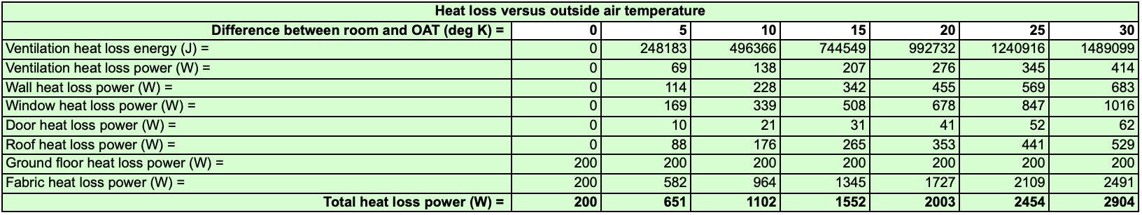

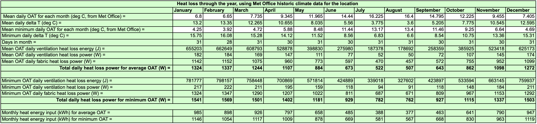

Susie Posted November 5, 2022 Posted November 5, 2022 I have used Jeremy's heat loss calc inputing all my U-values, area dimensions and OAT (Cornwall). Background The Build will be ICF, 144m2 internal, ground bearing slab with Celotex on top but no wet screed I'm looking at the fast to heat up dry board UFH systems. Solar PV will heat the DHW ,immersion thermal store, which will heat UFH. And economy 7 or willis heater are options. No air source heat pump, combination of the build being near my listed building and own choice that I don't want one. Wood burner stove for very cold winter months when PV struggles, own grown trees already cut and drying in storage more still growing. I'm home all day most days and quite happy to wear a jumper when a little cold. The quick to warm up systems advertise they can be at desired floor temp in 3 hours and room temp in another 2 hours can any body confirm this for a similar build? Example from one manufacturer is flow temp of 40deg, 50.8 W/m2 and floor temp of 24.9deg. Back to Jeremy's calc I how do I match my W and kWh to the best UFH

JohnMo Posted November 5, 2022 Posted November 5, 2022 So your max heat demand in w/m2 is 1541/144=say 11w/m2 Using the attached you get the flow temp you need, but the chart needs extending downwards, mean flow temps are low/mid 20s. That is to balance heat loss with heat input. If you want to blast heat and use a thermostat just add a couple of extra degrees. 1 1

SteamyTea Posted November 6, 2022 Posted November 6, 2022 (edited) 17 hours ago, Susie said: Back to Jeremy's calc I how do I match my W and kWh to the best UFH The W [watt] is the power, kWh [mega joules] is the energy required. If the W is 'on' for 1000 hours, then that is 1 kWh of energy [kWh or MJ] is just power multiplied by time (the k just means multiplied by 1000). Edited November 6, 2022 by SteamyTea 1
Susie Posted November 6, 2022 Author Posted November 6, 2022 Thanks for all the help, I also found this thread useful, (Floor heat loss and UFH calculator) and I will be looking into loop cad at a later date. So far I have required underfloor heating power 10.5 W/m2 and required floor temperature 21.2 deg Thanks to everyone. 1
