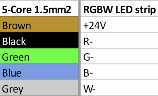

Thorfun Posted December 24, 2022 Author Share Posted December 24, 2022 hi all. now I've got my flooded basement under control and it's heating up and drying out I'm back thinking about this subject again. I have calculated my Cat6a requirements so that's all sorted. I've decided to use the Whitewing RGB dimmer. I've calculated my voltage drop for the longest run and I'm good with 1.5mm cable. so, for my RGBW strips I was going to run the attached data sheet Dali 5-core 1.5mm cable. DALI Lighting Cable 05Z1Z1-F Class Cca s1b d2 a1.pdf this ticks my boxes for CPR rating for LSOH/LSZH cable that I'm using throughout. it's more expensive that Eca rated cable but I'm trying to stick to my guns with the ratings for as much of my cable as possible. So, my question is, this cable is perfect for the RGBW led strips, right? I believe that @joth said in another thread that he used the Dali 5-core cable for his LED strips which is what led me to research it. One more question as well, I was planning on using Cat6a for my one-wire runs around the house as well. I know it's really overkill but I think the U/FTP Cat6a would allow better screening than a UTP Cat5e and, tbh, it's not too much more expensive. what did others use for their one-wire controls? And, finally, what cable did people use to 'jumper' within the Loxone cabinet? Link to comment Share on other sites More sharing options...
joth Posted December 24, 2022 Share Posted December 24, 2022 3 hours ago, Thorfun said: So, my question is, this cable is perfect for the RGBW led strips, right? I believe that @joth said in another thread that he used the Dali 5-core cable for his LED strips which is what led me to research it. Works perfectly for me. One core +24V and the other four for RBGW negative returns. My wiring scheme, fwiw. 3 hours ago, Thorfun said: what did others use for their one-wire controls? Random mix! Some cat6a, some cat5e, a couple are even on 8 core security flex. I'm using ESPhome rather than the Loxone 1wire extension fwiw, so if needed can add multiple gateways around the house at very little cost. 3 hours ago, Thorfun said: And, finally, what cable did people use to 'jumper' within the Loxone cabinet? I used trirated cabinet wire from TLC for must things, but stripped out twisted pairs from cat6a cables for anything using the little pushin wago 243-211 blocks that need solid core. Savvyspaces actually sell tri-rated solid core hookup wire if you want to be completely regs compliant (but the depends what regs your building to, init). I'd probably not bother myself, it's not like the external wires entering the cabinet are tri rated so seems overkill to insist all low current/low power internal wires must be 2 Link to comment Share on other sites More sharing options...
Thorfun Posted December 24, 2022 Author Share Posted December 24, 2022 1 hour ago, joth said: Works perfectly for me. One core +24V and the other four for RBGW negative returns. My wiring scheme, fwiw. Random mix! Some cat6a, some cat5e, a couple are even on 8 core security flex. I'm using ESPhome rather than the Loxone 1wire extension fwiw, so if needed can add multiple gateways around the house at very little cost. I used trirated cabinet wire from TLC for must things, but stripped out twisted pairs from cat6a cables for anything using the little pushin wago 243-211 blocks that need solid core. Savvyspaces actually sell tri-rated solid core hookup wire if you want to be completely regs compliant (but the depends what regs your building to, init). I'd probably not bother myself, it's not like the external wires entering the cabinet are tri rated so seems overkill to insist all low current/low power internal wires must be Thank you. Very useful information. Link to comment Share on other sites More sharing options...

joth Posted January 25, 2023 Share Posted January 25, 2023 20 hours ago, Johnnyire said: Can you explain the difference in that 5 core 1.5mm and the loxone cable? You mean Loxone Tree cable? 5 core 1.5mm2 flex has all five cores the same diameter. So good for power delivery (or Dali lighting) Tree has 2 cores at 1.5mm2 and 4 skinny wires wrapped up as twisted pairs. So mix of power and data only wires. 1 Link to comment Share on other sites More sharing options...
Johnnyire Posted January 25, 2023 Share Posted January 25, 2023 3 hours ago, joth said: You mean Loxone Tree cable? 5 core 1.5mm2 flex has all five cores the same diameter. So good for power delivery (or Dali lighting) Tree has 2 cores at 1.5mm2 and 4 skinny wires wrapped up as twisted pairs. So mix of power and data only wires. Yeah to the tree cable, thanks Link to comment Share on other sites More sharing options...
