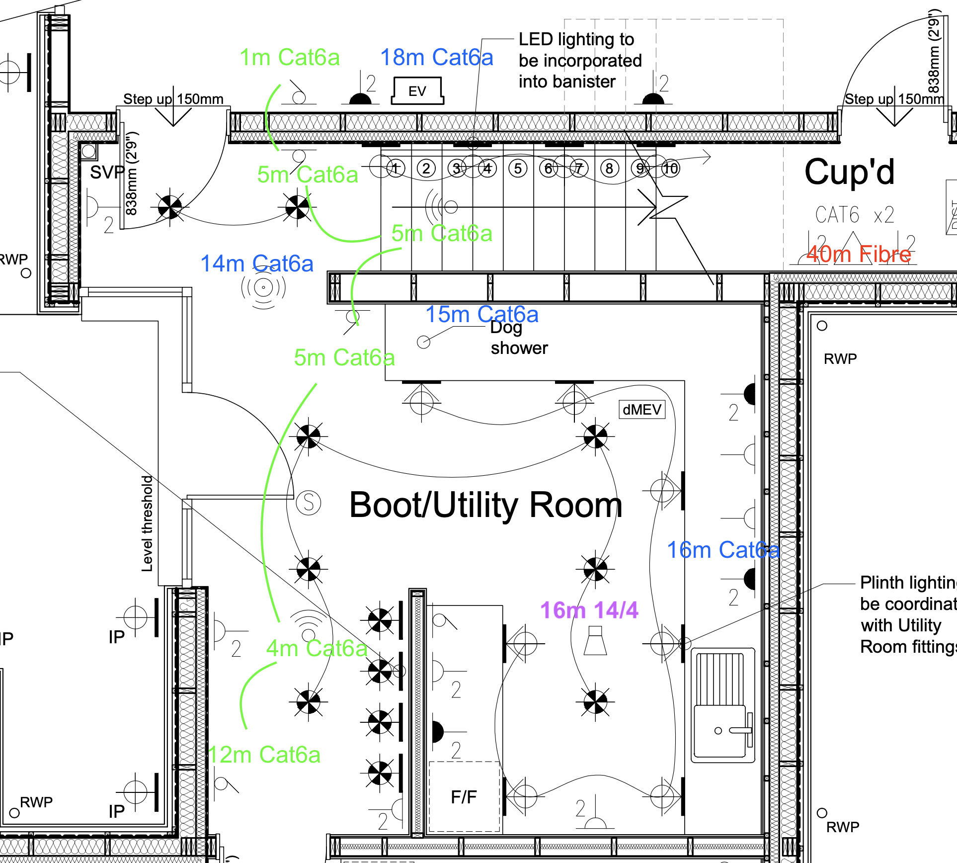

Thorfun Posted November 7, 2022 Author Share Posted November 7, 2022 morning all. I've been thinking long and hard about my cabling and, as I started to draw it all out, it has raised another question. if I'm daisy-chaining Cat6a cable for tree devices/retractive switches does the last device on that chain need terminating with a resistor? e.g. in the drawing below I have drawn a 12m green cat6a cable to the Tree Touch switch at the entrance to the utility room and then daisy chained it up to a Tree presence sensor, then to a retractive switch, on to another tree presence sensor, down to another retractive switch and then finally through the wall to a retractive switch. will that work? and is there any sort of resistor termination required at that final retractive switch? this is the idea for every room. one cable from the comms room to the Tree switch and then daisy-chaining from there. Link to comment Share on other sites More sharing options...
Rob99 Posted November 7, 2022 Share Posted November 7, 2022 There's no termination resistor required for tree cabling. Main thing to remember is that you can't have the tree bus connected as a closed loop anywhere. Also, for every retractice switch (assuming it's a single pole push type) you will need to feed it +24v (from orange tree wiring) and then take the return from the switch back to the panel as a digital input using one core of the cat6a cable. This means you can have a maximum of 4 digital inputs (e.g. retractive switches or door contacts) per cat6a if it is used as a tree cable but that you also then have no spare cores in case of any wiring issues later (e.g. plasterboard screw through cable!!) I love that you have a dog shower in your boot room....... 1 Link to comment Share on other sites More sharing options...
Thorfun Posted November 7, 2022 Author Share Posted November 7, 2022 1 hour ago, Rob99 said: There's no termination resistor required for tree cabling. Main thing to remember is that you can't have the tree bus connected as a closed loop anywhere. awesome. not planning on closing any of these Loxone Cat6a loops. 1 hour ago, Rob99 said: Also, for every retractice switch (assuming it's a single pole push type) you will need to feed it +24v (from orange tree wiring) and then take the return from the switch back to the panel as a digital input using one core of the cat6a cable. This means you can have a maximum of 4 digital inputs (e.g. retractive switches or door contacts) per cat6a if it is used as a tree cable but that you also then have no spare cores in case of any wiring issues later (e.g. plasterboard screw through cable!!) ok. think I understand this and I'm pretty sure that I won't exceed the 4 digital inputs per cable run but will double check my drawings. I think that if I have more than 2 I'll just run another cable. Also, I'll be doing the boarding so will know where the cables are and will take my time to ensure cables aren't hit! 🤞 1 hour ago, Rob99 said: I love that you have a dog shower in your boot room....... yeah, that was part of our brief to the architect, big boot/utility room with a dog shower. he thought the size of the utility was excessive but having lived in a house with a shoebox utility room we wanted space in this one! planning a second dog next year as well so the shower will get lots of use after muddy woodland walks. at the moment our dog gets hosed down outside and when it gets really cold I wouldn't like to be on the receiving end of a cold hose pipe so why should we subject our dogs to that if we don't have to! 😉 Link to comment Share on other sites More sharing options...

Thorfun Posted November 7, 2022 Author Share Posted November 7, 2022 when daisy chaining the Cat6a cable how does one join the pairs that aren't being used? so obviously, the tree pairs (green/green&white, orange/orange&white) go in one device and then on to the next but I'll need to join the blue/blue&white, brown/brown&white to carry those on up the daisy chain for the digital inputs from the retractive switches. what's the best way to do that? Link to comment Share on other sites More sharing options...

joth Posted November 7, 2022 Share Posted November 7, 2022 39 minutes ago, Thorfun said: when daisy chaining the Cat6a cable how does one join the pairs that aren't being used? so obviously, the tree pairs (green/green&white, orange/orange&white) go in one device and then on to the next but I'll need to join the blue/blue&white, brown/brown&white to carry those on up the daisy chain for the digital inputs from the retractive switches. what's the best way to do that? I used GPO gel filled crimp connectors, quick to use and worked very well. https://cpc.farnell.com/tuk/xjya-100/gel-crimp-2-wire-orange-capped/dp/CN22298? 1 Link to comment Share on other sites More sharing options...

Rob99 Posted November 7, 2022 Share Posted November 7, 2022 3 hours ago, joth said: I used GPO gel filled crimp connectors, quick to use and worked very well. https://cpc.farnell.com/tuk/xjya-100/gel-crimp-2-wire-orange-capped/dp/CN22298? I'll second the use of gel crimps. Cheap and very easy to use, you don't even need to strip the cable. 1 Link to comment Share on other sites More sharing options...

Thorfun Posted November 8, 2022 Author Share Posted November 8, 2022 another question if I may. the kids rooms have planned RGBW Led strips mounted around the edge of the ceiling. I was discussing with the electrician today where the drivers would be and I said I'd probably prefer to put them in the Loxone cabinet and drive the led strips from there. if I'm doing this I presume I need to run 5-core 1mm cable from the Loxone cabinet to the bedrooms to a point where the RGBW led strips will join the cable? just trying to find out if this will work before I buy a drum of 5-core cable. I also presume that one of these https://shop.loxone.com/enuk/rgbw-24v-dimmer-tree.html per LED strip to control them via Loxone? or could I use the DMX extension to control them using a DMX RGBW dimmer? (can you tell I'm a little out of my depth with electrics?) Link to comment Share on other sites More sharing options...
Rob99 Posted November 8, 2022 Share Posted November 8, 2022 I have the RGBW dimmers in my Loxone cabinet and then run a 3C&E and a T&E to each light circuit to give me the 5 cores needed. I did this a few years ago before Loxone launched the compact dimmers and if I were doing it now I would definitely use the compact dimmer trees located remotely near the LED strips. You then only need a single T&E (for the 24v) and a cat6 tree connection to each dimmer. If you have the dimmers in the cabinet you need at least 1mm2 cores to the LED strips. Link to comment Share on other sites More sharing options...
Dan F Posted November 8, 2022 Share Posted November 8, 2022 (edited) 14 minutes ago, Thorfun said: just trying to find out if this will work before I buy a drum of 5-core cable. Depends on length and wattage of the strips as you need to keep voltage drop under control. Do you know length of feed, length of LED and wattage of LED strip? I initially wanted to wire everything back to plant room, but this wasn't practical so I have some going back to plant room and then various locations around the house that have a 230v+DALI feed to them to allow for more localized drivers. 14 minutes ago, Thorfun said: I also presume that one of these https://shop.loxone.com/enuk/rgbw-24v-dimmer-tree.html per LED strip to control them via Loxone? Yes, or DMX drivers or DALI drivers etc. I'm not using any of the Loxone drivers as all downlight are DALI so it makes sense to have all lighting DALI-based. Also from what I remember the PWM frequency of the Loxone kit wasn't great. Lots of ways to do this. Edited November 8, 2022 by Dan F Link to comment Share on other sites More sharing options...
Thorfun Posted November 8, 2022 Author Share Posted November 8, 2022 11 minutes ago, Rob99 said: I have the RGBW dimmers in my Loxone cabinet and then run a 3C&E and a T&E to each light circuit to give me the 5 cores needed. I did this a few years ago before Loxone launched the compact dimmers and if I were doing it now I would definitely use the compact dimmer trees located remotely near the LED strips. You then only need a single T&E (for the 24v) and a cat6 tree connection to each dimmer. If you have the dimmers in the cabinet you need at least 1mm2 cores to the LED strips. this is interesting Rob. I presume you mean these https://shop.loxone.com/enuk/rgbw-24v-compact-dimmer-tree.html? so this can go in the loft void above their bedrooms with a single Cat6A cable from the above linked compact dimmer back to the Loxone cabinet and a 1mm2 or 1.5mm2 cable from the above linked dimmer to the RGBW led strip? that seems easier than running 5-core 1mm2 from the loxone cabinet to the LED strip. Link to comment Share on other sites More sharing options...
Thorfun Posted November 8, 2022 Author Share Posted November 8, 2022 14 minutes ago, Dan F said: Depends on length and wattage of the strips as you need to keep voltage drop under control. Do you know length of feed, length of LED and wattage of LED strip? length will be about 12m from Loxone cabinet to both RGBW Led strip ends. LED length will be about 10m in total I don't know the wattage of the LED strip as I've not got that far yet! I could use remote drivers as there is a void above each bedroom in the roof eaves where I could put the driver and it could be accessible for replacement on failure which is why the solution @Rob99 is suggesting is quite appealing. it doesn't use Tree cable and I'm buying an excessively large amount of Cat6A for automation already so could incorporate another couple of runs easily Link to comment Share on other sites More sharing options...
