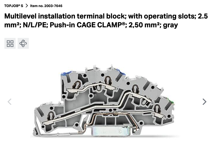

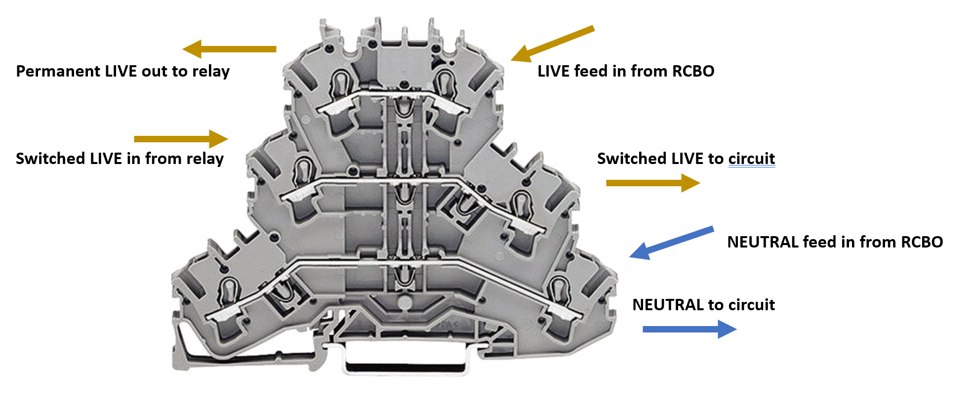

Dan F Posted February 29, 2024 Posted February 29, 2024 On 28/02/2024 at 22:44, Rob99 said: To achieve the correct connections, the RCBO Live feed goes to the top level and is commoned across all terminals at that level. The RCBO Neutral feed goes to the bottom level and is commoned across all terminals. The Live to each relay goes from the top level out to the relay and returns to the middle level. Circuit connections on the outgoing side are then made at middle level for the switched Live and bottom level for the Neutral. Expand Ah, so this is maybe what @Thorfun was trying to do, but without the necesary 3rd level? I can see this being quite natural when the RCBO's are external, but when RCBO's are in the cabinet it's less natural and you need an additional level. Also, not really practical with blinds/motors. @Thorfun Maybe we confused you, given we've each slightly different approach re: RCBO location and power distribution 😞
Thorfun Posted February 29, 2024 Author Posted February 29, 2024 On 28/02/2024 at 22:44, Rob99 said: If those are double height terminals on the top DIN rail then you won't be able to use them to distribute power from the RCBO, through the relays and out to the individual circuits as there aren't enough connection points. I use triple height blocks for RCBO fed circuits. The Live connection sequence needs to be....... RCBO >> Terminal Block >> Relay >> Terminal Block >> Circuit. To achieve the correct connections, the RCBO Live feed goes to the top level and is commoned across all terminals at that level. The RCBO Neutral feed goes to the bottom level and is commoned across all terminals. The Live to each relay goes from the top level out to the relay and returns to the middle level. Circuit connections on the outgoing side are then made at middle level for the switched Live and bottom level for the Neutral. Hopefully this might help: Expand right. i get this. but where does the earth from the twin and earth cables go? at the moment i have the terminal blocks that have the earth connecting to the din rail on the outgoing side of the TB. https://www.wago.com/gb/rail-mount-terminal-blocks/multilevel-installation-terminal-block/p/2003-7646 but in your solution that 3rd row just for earthing doesn't exist? i believe you've previously said that you earth somewhere else.

Thorfun Posted February 29, 2024 Author Posted February 29, 2024 On 29/02/2024 at 12:00, Rob99 said: Yes, all the earth connections are made with the earth bars fitted to the back plate of the enclosure at the top/bottom. The main issue I see is that you need a way to distribute the RCBO feed to the relays but without the triple height blocks you can't do this at the terminal block end. It's not an ideal solution but one option would be to take the RCBO feed and loop it across to one side of all of the relays which link to that RCBO so that when you wire the other side of the relay back to the terminal block you are effectively feeding switched live into each terminal block. Your neutral would then be commoned across the terminal blocks. Expand ok. that makes sense. only issue i can think of is that i'd have to fit 2 x bootlace ferrules into the Loxone relay ports as it loops through the extension. on the plus side it would dramatically reduce the number of cables i need to feed to the terminal blocks from the relays!
Dan F Posted February 29, 2024 Posted February 29, 2024 On 29/02/2024 at 12:00, Rob99 said: It's not an ideal solution but one option would be to take the RCBO feed and loop it across to one side of all of the relays which link to that RCBO so that when you wire the other side of the relay back to the terminal block you are effectively feeding switched live into each terminal block. Your neutral would then be commoned across the terminal blocks. Expand This is what 90% of people do from what I've seen. You can use your terminal blocks, just need to re-wire a bit. As long as you you have the 2-way bootlace ferrules and the cable from RCBO is sized for the total load of all relays it serves, then you won't have an issue. (the cable sizing for other approaches only has to account for load of individual relays, so this is important) I used a slightly different approach, where I use dedicated (power distribution) terminal blocks on bottom rail next to RCBO's to distribute live to each relay independently. This involves more materials and more wiring, but I thought it was more "correct" at the time. On 29/02/2024 at 13:03, Thorfun said: on the plus side it would dramatically reduce the number of cables i need to feed to the terminal blocks from the relays! Expand yes! and you should only have 1 blue cable per RCBO. For switched lives from relays I used brown for lighting and brown/black for blinds (where there are two lives). 1
Dan F Posted February 29, 2024 Posted February 29, 2024 On 29/02/2024 at 13:15, Dan F said: This is what 90% of people do from what I've seen. You can use your terminal blocks, just need to re-wire a bit. As long as you you have the 2-way bootlace ferrules and the cable from RCBO is sized for the total load of all relays it serves, then you won't have an issue. (the cable sizing for other approaches only has to account for load of individual relays, so this is important) Expand This shows this approach: https://youtu.be/fRq_IjiyB68?si=ZIm1Ah5WGJCOLwky&t=612 1 1

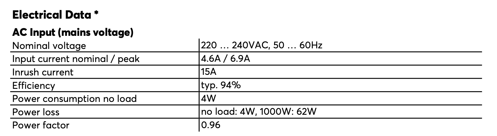

Thorfun Posted February 29, 2024 Author Posted February 29, 2024 On 29/02/2024 at 17:12, Dan F said: Have you totted up max current per RCBO? What thickness tri-rated are you using? Expand I have a magic spreadsheet that calculates all that for me. 😉 each RCBO for mains lighting is max 2A. the RCBO for UFH and towel radiators in the bathrooms has max 5A the RCBO for the external blinds has max 7A I'm using 1.5mm tri-rated. I'm sure that's fine for those max currents but will double check with the electrician. things get more complicated when I need to work out the total current for the 24V circuits as they're all coming from the PSUB. those 24V circuits are currently showing as 42A max if all were on full power. the total of the PSUB is 40A so I should be within that as there's no way all those 24V lights will be on all the time and I will be restricting the power on a number of the circuits anyway. looking at the PSUB data sheet I see this: so that to me sounds like a peak current of 7A but I need to work on 15A inrush current. so, a 16A RCBO for that one and, most likely, a 2.5mm cable but, again, will check with the electrician as (I'm sure you're aware!) my electrical knowledge is...............errr..............limited. 😉 1
Thorfun Posted February 29, 2024 Author Posted February 29, 2024 On 29/02/2024 at 17:29, Thorfun said: so that to me sounds like a peak current of 7A but I need to work on 15A inrush current. so, a 16A RCBO for that one and, most likely, a 2.5mm cable but, again, will check with the electrician as (I'm sure you're aware!) my electrical knowledge is...............errr..............limited. 😉 Expand spoke to my electrician and he said you size the RCBO for the nominal/peak current and use a c-type RCBO to handle the inrush current. so just a 10A c-type RCBO for the PSUB. also, 1.5mm cable is rate to 18A (off the top of his head so don't quote him on it!) so should be good for all my internal cabinet requirements.
Rob99 Posted February 29, 2024 Posted February 29, 2024 1.5mm2 tri-rated is rated at nominal 21A but you should derate that if you are bunching cables together. Sounds like your sparky knows his stuff though. Besides you have to keep below 16A if you're using the Loxone relays, or 10A on the miniserver relays. 1

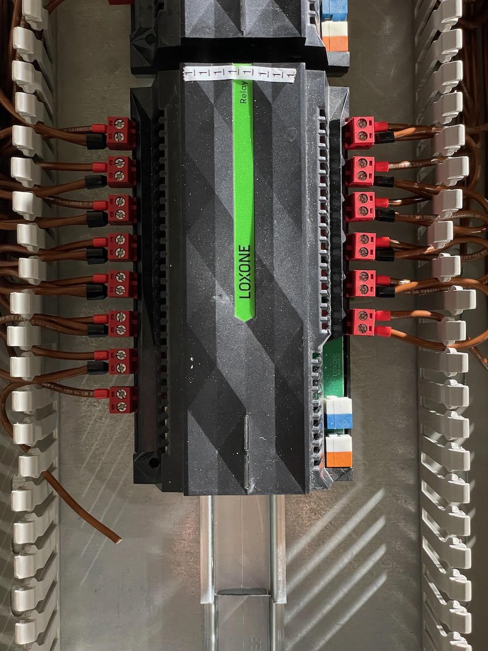

Thorfun Posted March 8, 2024 Author Posted March 8, 2024 redone the first relay. is that better @Dan F? thought I'd better post a photo before I do them all in case I've f****d up again. Relay 1 doesn't have the perm live yet as I need to run it from the RCBO. 2
Rob99 Posted March 8, 2024 Posted March 8, 2024 On 08/03/2024 at 18:27, Thorfun said: thought I'd better post a photo before I do them all in case I've f****d up again. Expand Looks fine to me 👍 1

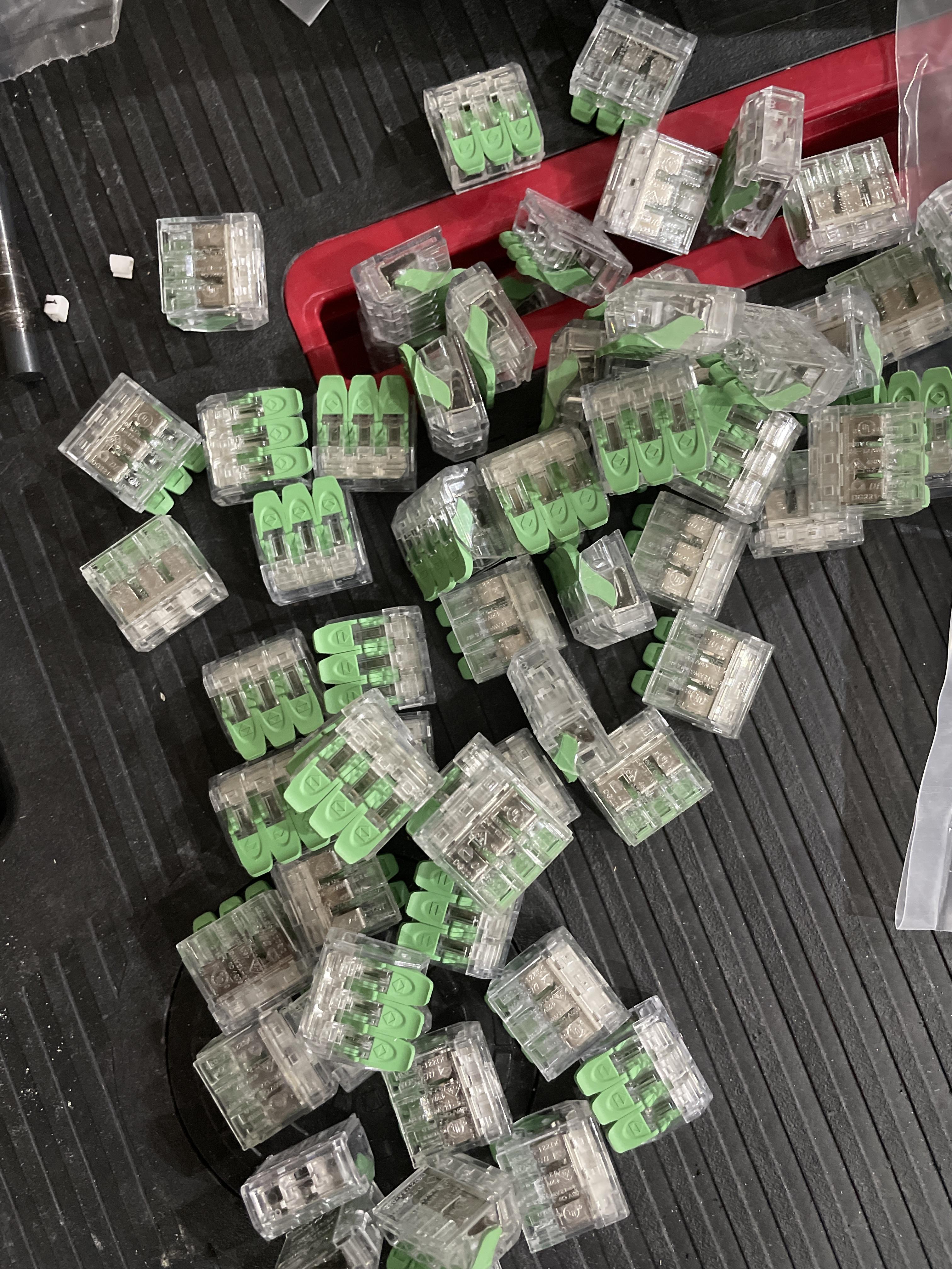

Thorfun Posted March 10, 2024 Author Posted March 10, 2024 I got a load of these 3-way Wago connectors with my Loxone order. I think they came with the presence sensors. did/ does anyone use them or should I just stick with gel crimps?
Dan F Posted March 10, 2024 Posted March 10, 2024 On 10/03/2024 at 15:21, Thorfun said: I got a load of these 3-way Wago connectors with my Loxone order. I think they came with the presence sensors. Expand I used them. Given space isn't quite so tight above presence sensors no real need to use the gel crimps, you can if you prefer though. 1
Thorfun Posted March 10, 2024 Author Posted March 10, 2024 On 10/03/2024 at 16:58, Dan F said: I used them. Given space isn't quite so tight above presence sensors no real need to use the gel crimps, you can if you prefer though. Expand haven't got enough to do all the pairs so would have to use gel crimps for some of them. I have 64 wagos and 16 sensors. so enough for the orange/orange white and green/green white.
