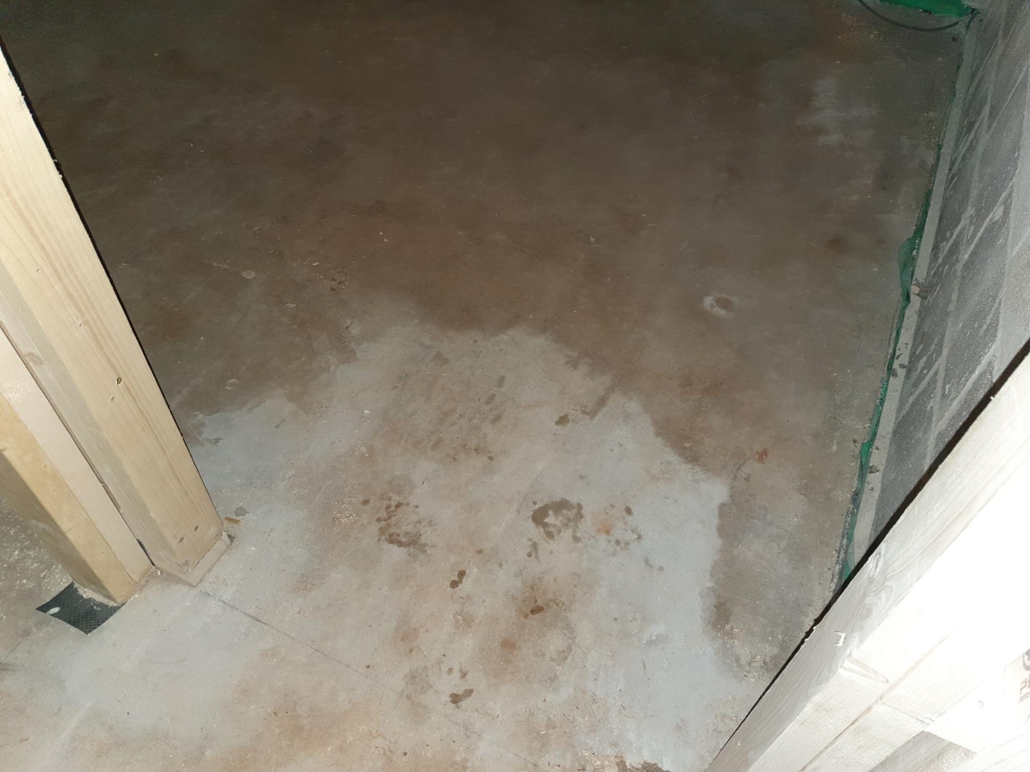

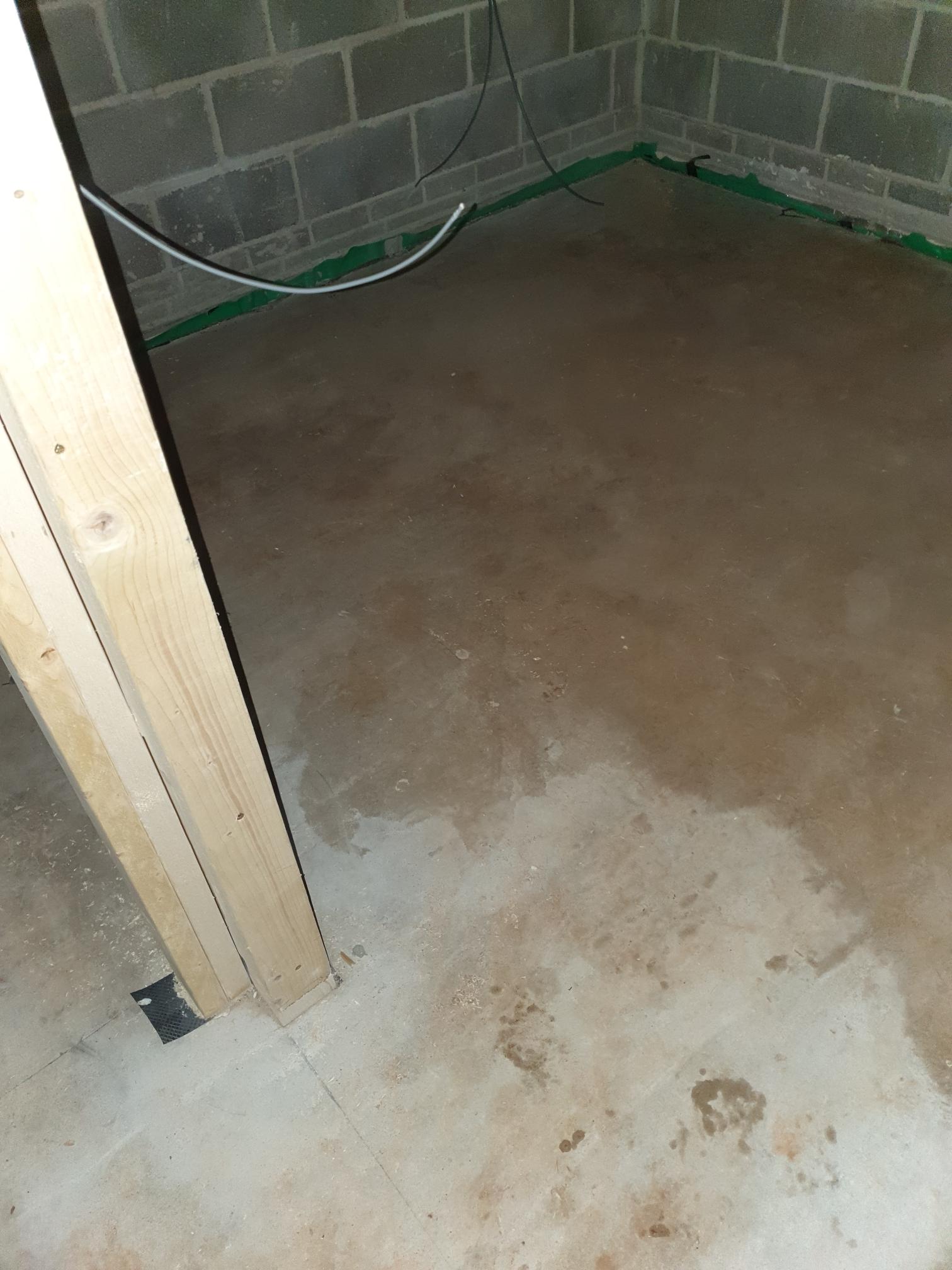

Moonshine Posted October 31, 2022 Author Posted October 31, 2022 (edited) Went for an evening check on site after heavy rain. Roof all watertight phew. However in one corner of the house in the torch light the screed looks darker than the rest. Could this indicate a water leak in the underfloor heating pipes over such a wide area, and loss of pressure? The camera flash does empthises the difference Edited October 31, 2022 by Moonshine
Olf Posted November 3, 2022 Posted November 3, 2022 On 31/10/2022 at 21:13, Moonshine said: Could this indicate a water leak in the underfloor heating pipes over such a wide area Expand For sure water got there somehow If there is a point leak in the slan, the moisture will seep through the conrete, thought it would do this radially from the point of the leak (just pour a bit of water elswhere to see what's happening). Saying that, edges of the slab could promote moisture migration and make it hard to say what exactly is happening there.
Andehh Posted November 5, 2022 Posted November 5, 2022 Damaging UFH pipe is rare, it's very durable and resistant to abuse. Any reason why it could be damaged? Bricks dropped on it, heavy metal work, revenge/spite?
Mr Punter Posted November 5, 2022 Posted November 5, 2022 Has anyone (like plumbers) been working on site. They may have leaked some water and not told you? There is what looks like a length of pipe dangling down. Plumbers are to blame for most things.
