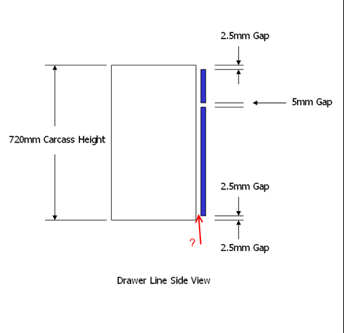

Temp Posted October 23, 2022 Share Posted October 23, 2022 I'm making some drawings for a kitchen cabinet/base unit. I found this page with some useful dimensions for clearance gaps but have a question... https://www.diyhomefit.co.uk/measuring-up-guide.html What I'm interested to know is what gap (if any) is normally provided behind the door where the red arrow is on the drawing above. I think a small gap might help ensure the door fully closes. For example if the door isn't perfectly flat? Anyone know if the hinges normally used on kitchen cabinet doors are intended to have a gap here? I know they are normally adjustable so a gap could be created but I need to subtract the default gap from the front to back depth of the unit. Link to comment Share on other sites More sharing options...
markc Posted October 24, 2022 Share Posted October 24, 2022 Cabinet hinges are adjustable in/out and the movement is there to get adjacent doors to sit flush. Aim for no gap but it rarely happens Link to comment Share on other sites More sharing options...
S2D2 Posted October 24, 2022 Share Posted October 24, 2022 On my units about 2mm, dictated by the thickness of the little rubber dampers that sit on the non-hinge side and make the door close silently. The hinge is adjusted to match this so the door sits flat. Link to comment Share on other sites More sharing options...
Temp Posted October 24, 2022 Author Share Posted October 24, 2022 Thanks. Had a feeling it would be something like that. Link to comment Share on other sites More sharing options...

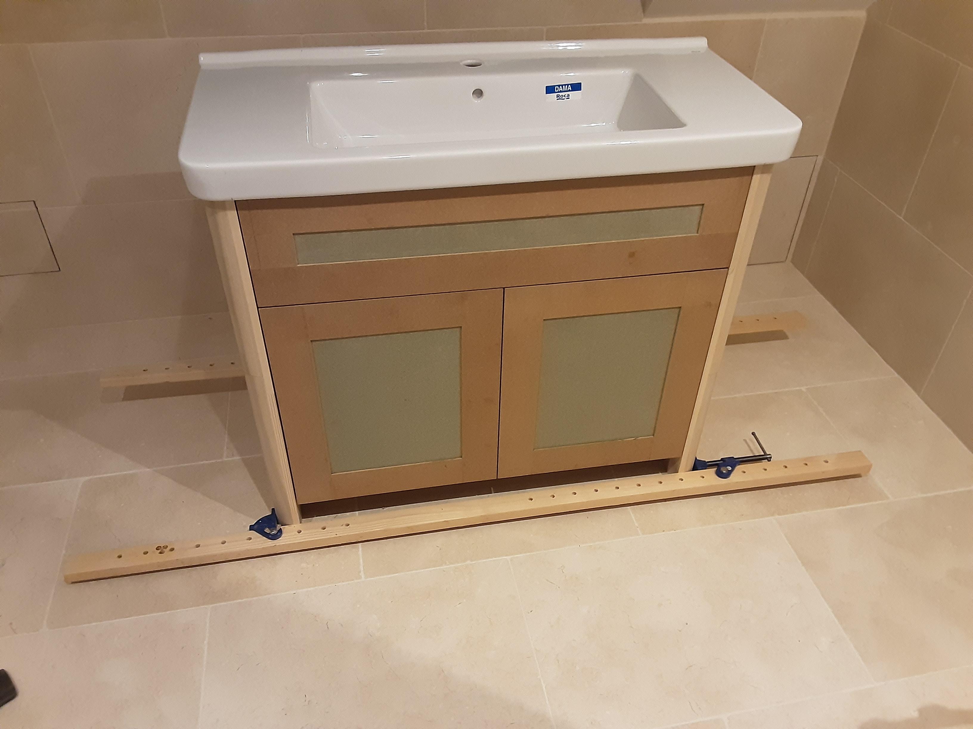

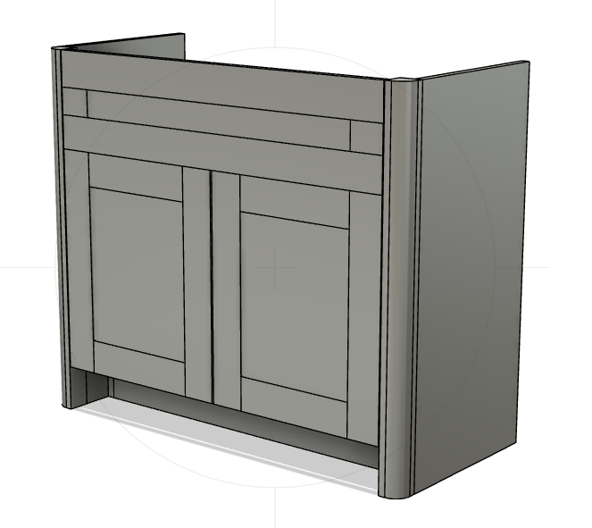

Temp Posted October 25, 2022 Author Share Posted October 25, 2022 (edited) Cad done... Not all the lines on the drawing will be on the final unit. Has radiused corners to suit a washbasin that sits on top. The way it sits means I had to allow for a small gap behind the dummy drawer front or there would be a gap between the sides and the wall its going against. Might do something to pretty up the toe recess. Its actually going in a bathroom. Edited October 25, 2022 by Temp Link to comment Share on other sites More sharing options...
Temp Posted November 17, 2022 Author Share Posted November 17, 2022 First go at assembling it. Not all glued up yet. It still needs taking apart, sanding, priming and painting before reassembly. This is the first thing I've made by trusting the CAD dimensions. Normally I would cut part A and then cut part B to fit part A. This time I pretty much cut everything to the dimensions extracted from the CAD and crossed my fingers. Working OK so far. Mostly water resistant MDF so will need sealing well and a good paint job. The rounded corners were made by cutting a 75mm Diameter Poplar cylinder/dowel into four bits lengthwise. The top drawer is fake. The lower doors have soft close Blum hinges. . 9 Link to comment Share on other sites More sharing options...

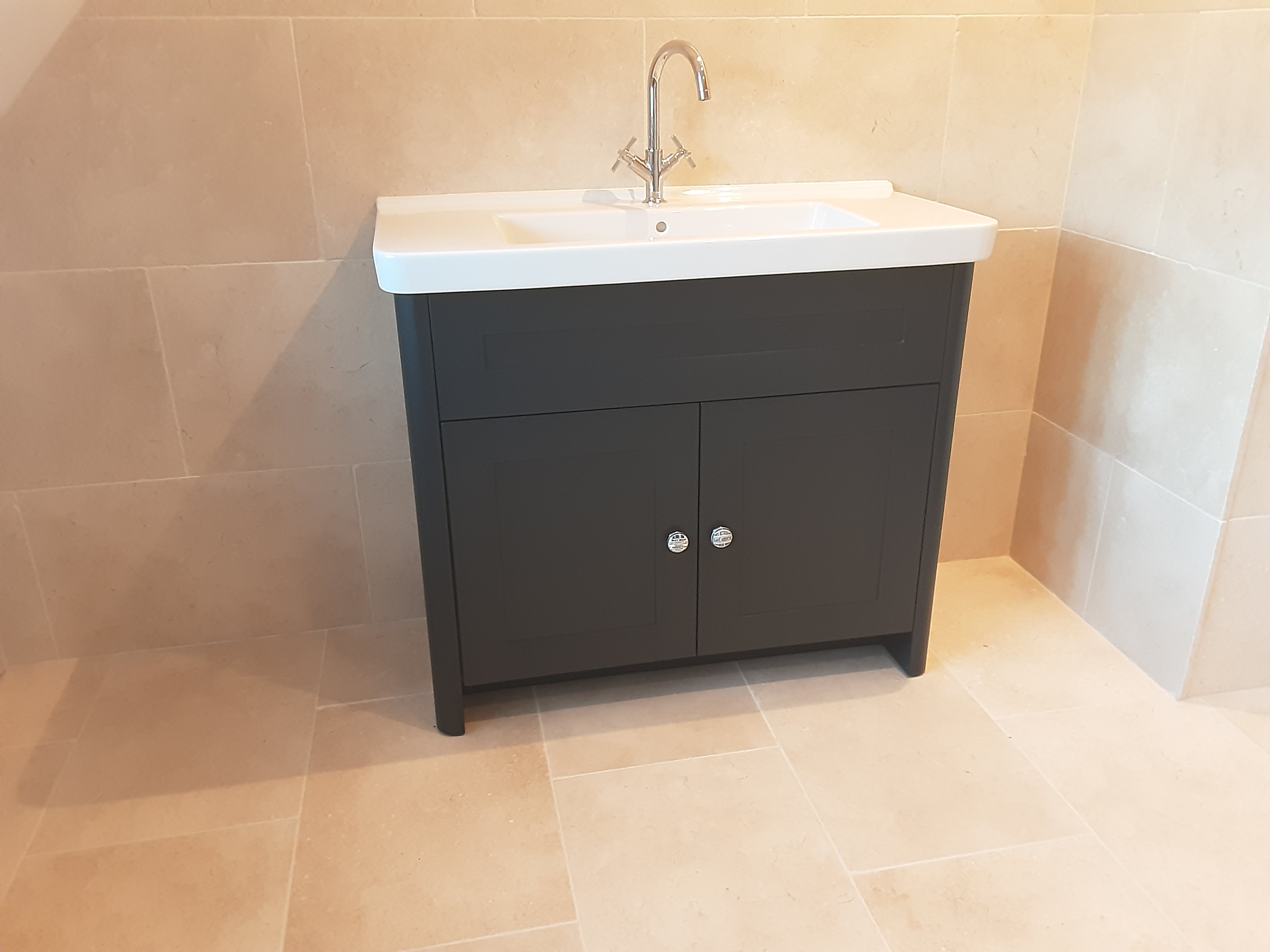

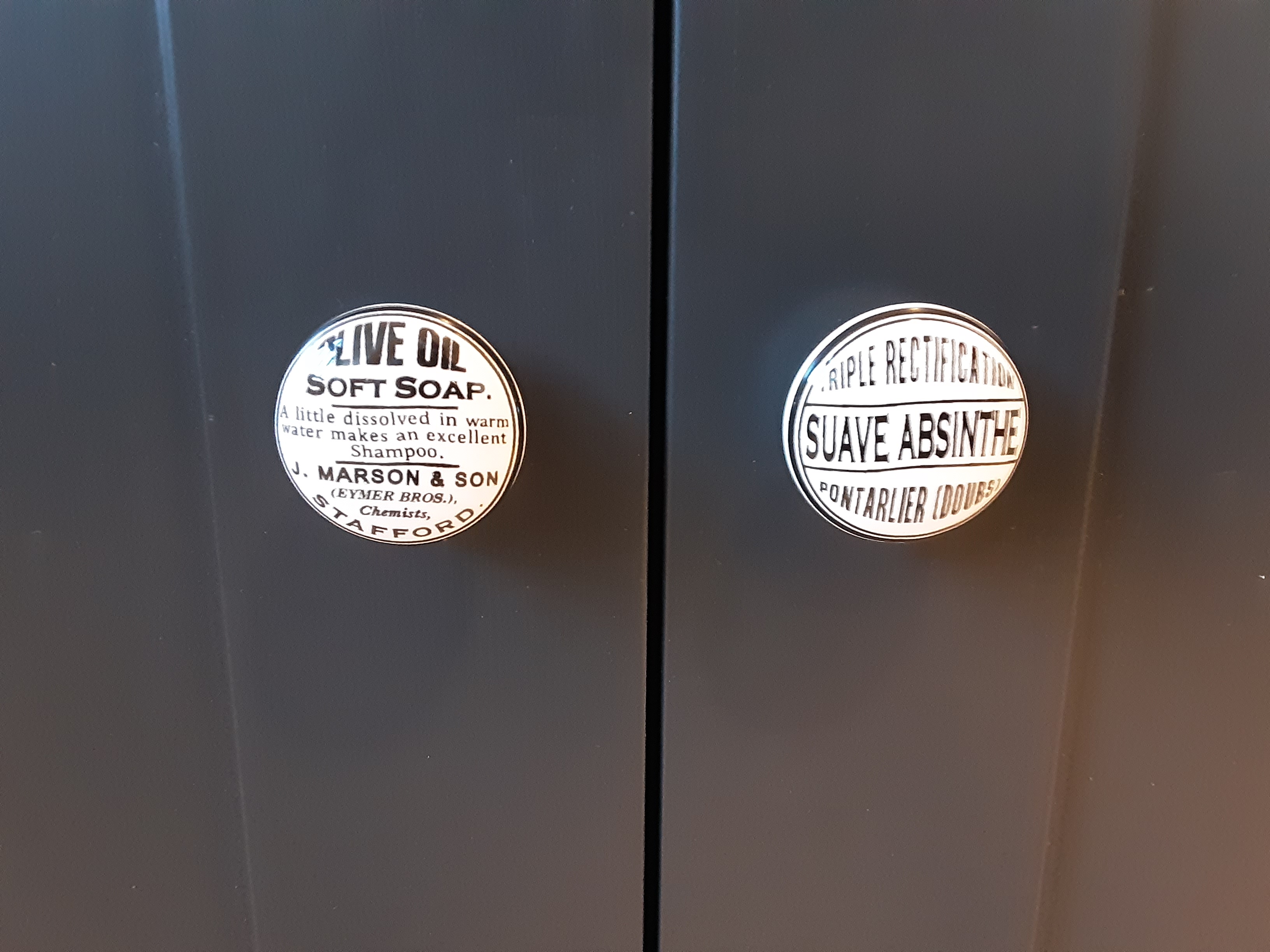

Temp Posted December 29, 2022 Author Share Posted December 29, 2022 All painted up and plumbed in. Really pleased with the way the rounded corners turned out. You keep wanting to stroke them. I used two coats of Rust-oleum kitchen cabinet paint (which went on well with a brush) over Zinsser primer. Knobs off Amazon. Room still looks a bit bare but will get a mirror, towel rail, shaver socket etc after the shower is done. 7 Link to comment Share on other sites More sharing options...
Russell griffiths Posted December 29, 2022 Share Posted December 29, 2022 46 minutes ago, Temp said: All painted up and plumbed in. Really pleased with the way the rounded corners turned out. You keep wanting to stroke them. I used two coats of Rust-oleum kitchen cabinet paint (which went on well with a brush) over Zinsser primer. Knobs off Amazon. Room still looks a bit bare but will get a mirror, towel rail, shaver socket etc after the shower is done. That looks the nuts, just paid £650 for something very similar. 👍 Link to comment Share on other sites More sharing options...
Temp Posted December 29, 2022 Author Share Posted December 29, 2022 3 minutes ago, Russell griffiths said: That looks the nuts, just paid £650 for something very similar. 👍 That's exactly why I made it 🙂 1 Link to comment Share on other sites More sharing options...
Mr Punter Posted December 29, 2022 Share Posted December 29, 2022 On 17/11/2022 at 22:38, Temp said: The rounded corners were made by cutting a 75mm Diameter Poplar cylinder/dowel into four bits lengthwise. That sounds like proper woodworking. I would probably lose a couple of fingers attempting this. Link to comment Share on other sites More sharing options...
saveasteading Posted December 29, 2022 Share Posted December 29, 2022 How many hours? if you don't mind? Link to comment Share on other sites More sharing options...
Temp Posted December 29, 2022 Author Share Posted December 29, 2022 1 minute ago, Mr Punter said: That sounds like proper woodworking. I would probably lose a couple of fingers attempting this. I tack glued it into an L shape of MDF strips to stop it rotating as I ran it through the table saw. You can buy 1m lengths of the 76mm "dowel" for £41 but I went for a 500mm length at about £24 and used all four quarters. Wasn't as hard as I expected. Cist breakdown.. Basin was around £240 Cabinet cost me.. 1.5 sheets of 18mm water resist mdf. £70 ish 1 sheet of 9mm ditto £30 ish A 76mm/3" diameter cylinder of Tulipwood from here.. £25 https://www.ebay.co.uk/itm/Tulipwood-Dowels-350mm-500mm-1m-lengths-various-diameters/324138601208?var=513190789483&pageci=40a9fb04-ce16-4b9c-8b6d-97f49b4bff70&redirect=mobile Pair of Blum hinges £15 Tin of Zinsser £17 Tin of Rustoleum £25 Knobs - pack of 8 different £15 https://www.amazon.co.uk/dp/B078XH7NFF?psc=1&ref=ppx_yo2ov_dt_b_product_details Total for cabinet around £210. Overall about £450. 6 minutes ago, saveasteading said: How many hours? if you don't mind? Quite a few hours. Not exactly sure as I didn't count them and they were spread over about two months of odd days here and there. If I had to make one in a hurry probably a weeks work but I'm slow and listen to the Archers! I'm just a DIYer working in a shed way too small to cut 8*4 sheets. Had them cut in quarters by Huntingdon Timber so they fit in the S-Max. Link to comment Share on other sites More sharing options...
