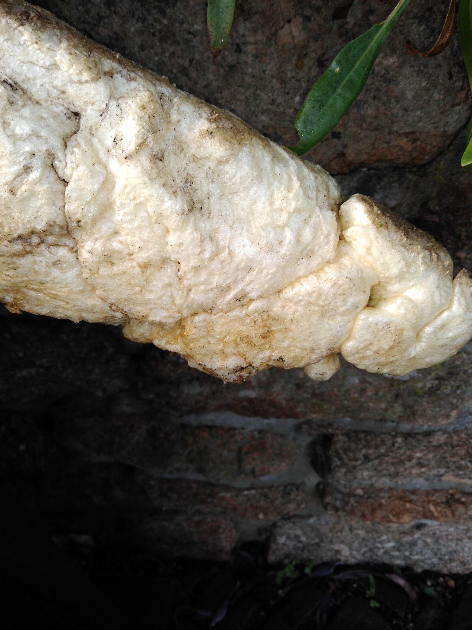

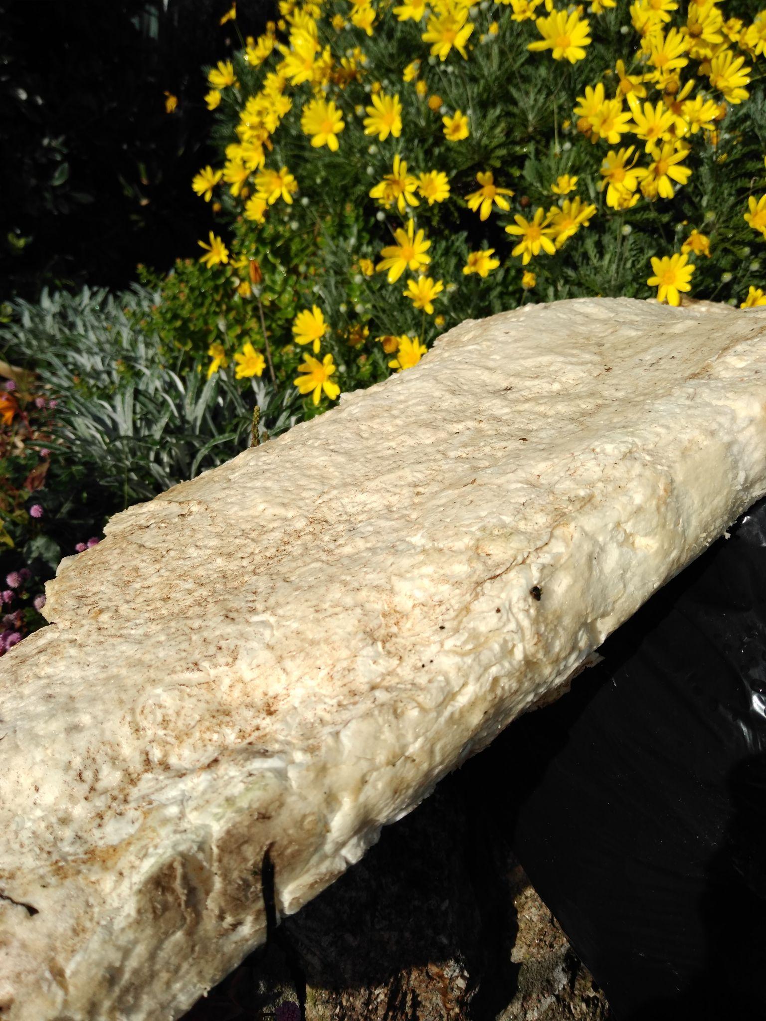

SteamyTea Posted November 6, 2022 Posted November 6, 2022 Just by chance this bit if foam had washed up. Probably bouncy from a small boat. Can see that the surface has degraded and the initial mounding was sub standard.
