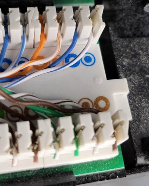

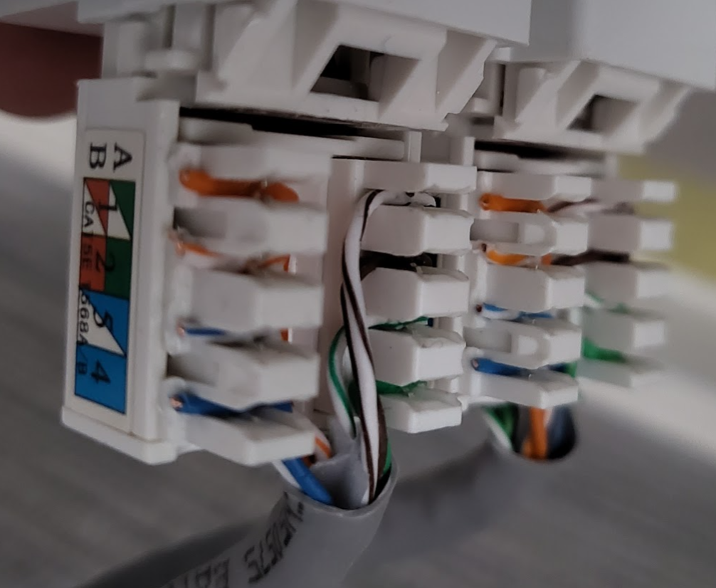

Adam2 Posted October 18, 2022 Posted October 18, 2022 I had a company come round to sort the patch panel and some wall connections etc. The panel is as per the images on the back of the 48 port panel (supplier says intended to be wired as T568B) I took one of my wall plates off as I wanted to see if they had wired up as T568A or B as I needed to do another wall plate myself. When I took an existing one off I noticed the orange cables were swapped - weird, almost T568B. So, I plugged a pre-made long patch lead into the wall outlet and used my patch cable test device to connect this into the patch panel - it shows 3 pairs as not good and 1 pair as good. so weird - thought it would be 1 pair bad. So - swapped the oranges around and now I use my tester and I have 2 pairs good and 2 not showing any connection WTF??? Looked at another faceplate - wired the same with oranges seemingly crossed. On one of these I have a laser printer connected and the switch (Unifi) reports this as being a fully operational 1Gb connection - which I guess means 4 pairs need to be working correctly. Clearly I'm very confused - any pointers appreciated to calm my confusion 🙂 Else will call installer in morning to see what he thinks.

Adam2 Posted October 18, 2022 Author Posted October 18, 2022 Thanks yes have a cable tester which I used and had results above. Just cannot understand how the wall panel can be wired incorrectly as per the colour on the module yet do 1gb connection and cable tester reports 2 pairs with no signal maybe I'm using it wrong or something but it is simple just 2 cable connectors and some lights to show each pair...
joth Posted October 18, 2022 Posted October 18, 2022 (edited) 1 hour ago, Adam2 said: it shows 3 pairs as not good and 1 pair as good. so weird - thought it would be 1 pair bad. So - swapped the oranges around and now I use my tester and I have 2 pairs good and 2 not showing any connection WTF??? Can you say which pairs were bad, and what sort of badness they had? Remember with T568B the pairs are not in order of the pins in the RJ45, which is what the tester will be reporting. So for example if green pair are reversed, you'll see the tester sing out an order of "1 2 6 4 5 3 7 8" because green are on pins 3 and 6. It would be easy to see this as 2 bad pairs, but it's only one. All that said.... doesn't explain your original issue with orange swapped. To confirm, the photo from the back of the patch panel is actually from the port with the issue? It's possibly not all ports were done the same if an error slipped in. Edited October 18, 2022 by joth

Adam2 Posted October 18, 2022 Author Posted October 18, 2022 OK thanks - so more info 🙂 The tester I have is this one basic - just shows a LED for each pair 1/2, 3/6, 4/5, 7/8 - writing this makes me notice a typo in the original message which I'll update if poss. When I connect the following: 1 - Patch panel port with terminations as per images (supplier says is "B") 2 - Cable from patch panel into tester 3 - Other end of tester - cable running to wall plate - wall plate wired as per "B" image on the keystone module 4 - Cable at back of wall plate terminated into patch panel (1) Tester shows 2 green LEDs pairs and 2 LEDs not lit at all - I did an experiment to see what condition causes no LED vs red LED -seems red LED is a pair that is crossed and no LED means one of the wires in a pair is not connected. When patch cables are used on their own - so a single cable plugged into both ends of the tester - I get 4 green LEDs indicating all pairs working as expected From looking at patch panel looks like all wired the same.

MJNewton Posted October 18, 2022 Posted October 18, 2022 To add: my advice would be to 1) check the T568B colours on your patch panel and faceplates do actually connect to the correct pin in the socket as per the specs (it is not unheard of for cheap products (no offence intended - they're what I use!) to have such issues/errors, and 2) double-check that the T568B wiring spec has been followed throughout the installation (all to easy for mistakes to creep in, such as the reverse polarity orange pair you found, or for the adjacent T568A colour code to have been inadvertently followed somewhere).
joth Posted October 19, 2022 Posted October 19, 2022 (edited) 9 hours ago, MJNewton said: It's likely not something that'll be adequately explained/advertised in the specs - it's more a low-level function that corresponds to a equally low level coverage in the IEEE specs Auto MDI-X (auto crossover) is well specified, and mandatory part of 1000base T. It specifically deals with the TX and RX pairs being swapped, but doesn't explain the cores being inverted within a pair. Gigabit ethernet uses AC signalling so there's the possibility the negotiation completes even with a polarity inversion. It means one pair is phase inverted so highly likely to mess with max bandwidth performance and maybe the PoE function too. Tldr the gigabit light lighting up is not proof of a perfectly wired cable. @Adam2 You definitely need a new testing protocol as the existing one that works according to pairs of pins on the connector is not giving a sensitive or specific diagnosis. Tip: is buying a new tester go with a 9 LED one with screening (ground) continuity test too, just avoid ever needing to buy another should you ever need that, LOL. Edited October 19, 2022 by joth 1

Adam2 Posted October 19, 2022 Author Posted October 19, 2022 Ahh the fond memories of the ISO 7 layer model 🙂 Thanks for all the valuable info, always good to learn. I think the cable installer just had a brain fart and systematically crossed the oranges in the faceplates - he was being assisted by his old man so possible that there was some miscommunication. Even though seems to work I'll swap them to align with the labeling for piece of mind and at the same time check the + punch down again to make sure all is good - not too many anyway. May also go buy a more comprehensive tester - not long until Christmas! 2
