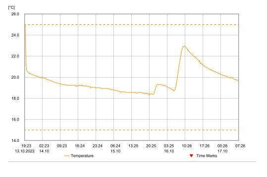

dpmiller Posted October 18, 2022 Share Posted October 18, 2022 I've been doing a bit of monitoring of recent days and find that our system (65mm of hemihydrate, pipes on roughly 200mm centres, 8.5kW ASHP vs worst-case loss of between 2.6 and 4kW) gives a useable floor temp rise in about 90 mins that takes about 4hrs to dissipate eg /testo 184 logger sitting on the screed surface. Ignoring the first drop as I'd been holding it in my hand, the small peak was to satisfy the hall to 19.5C in the evening, the larger one bringing it again to 19C in the morning after a frosty overnight. Link to comment Share on other sites More sharing options...
JohnMo Posted October 18, 2022 Share Posted October 18, 2022 I take it your flow temps are quite high, looks like you could reduce and get a gain in CoP? Link to comment Share on other sites More sharing options...
dpmiller Posted October 18, 2022 Share Posted October 18, 2022 7 minutes ago, JohnMo said: I take it your flow temps are quite high, looks like you could reduce and get a gain in CoP? I could, other than I'm currently controlling on the return temperature to give meaningful heat to a second manifold with oversized rads and towel rails on it. The system is currently running at a DeltaT of 7C and a return of 38C so there's 45C or so available to each manifold, but that drops a fair bit once the manifolds warm plus the flow runs through the TS coil continuously to buffer it. This is our first winter in the house so I'll be trying to bring things down a touch, yes. Link to comment Share on other sites More sharing options...
